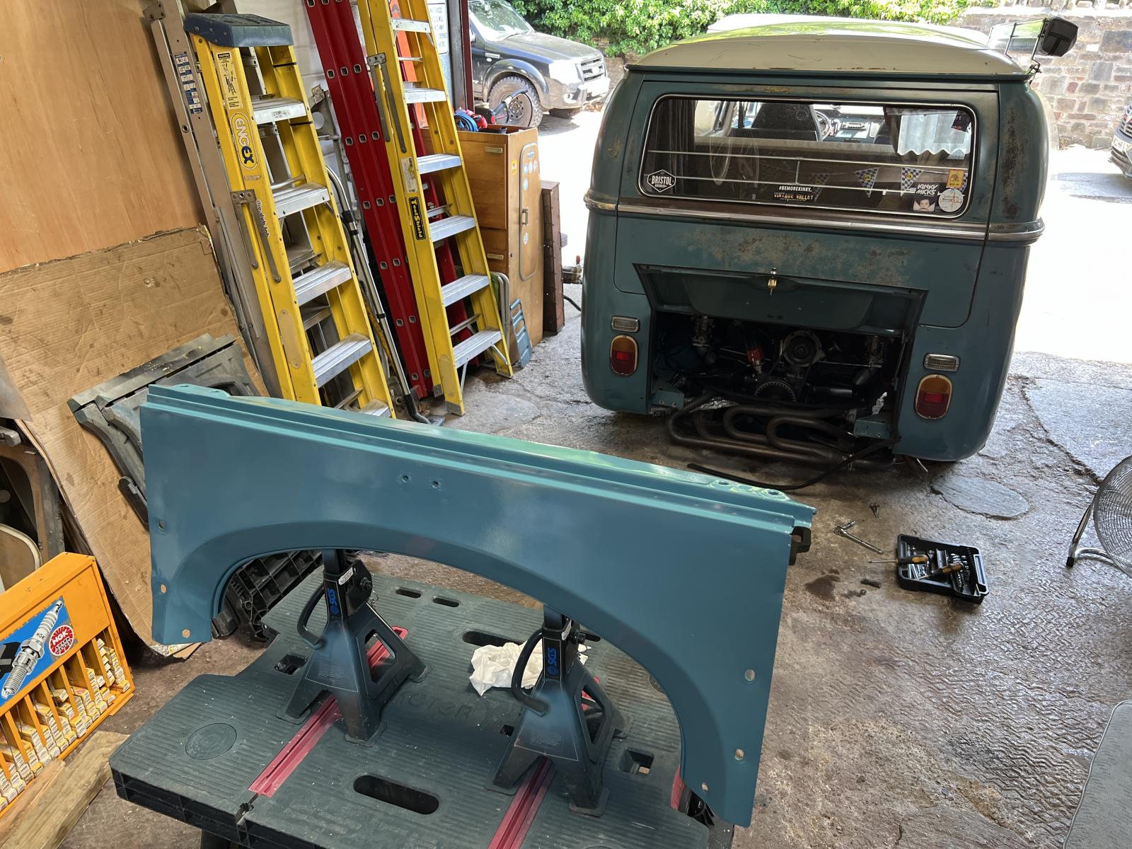

Stanford Hall is coming up soon, and for whatever reason, I've never been.
I was quite looking forward to taking the deluxe, however, there are issues with the rear shocks, so I drove to my friend Nick's workshop to put it on a ramp where I could see the suspension at ride height.
All good, the existing shocks are bottoming out, so shock lengths measured for new ones.

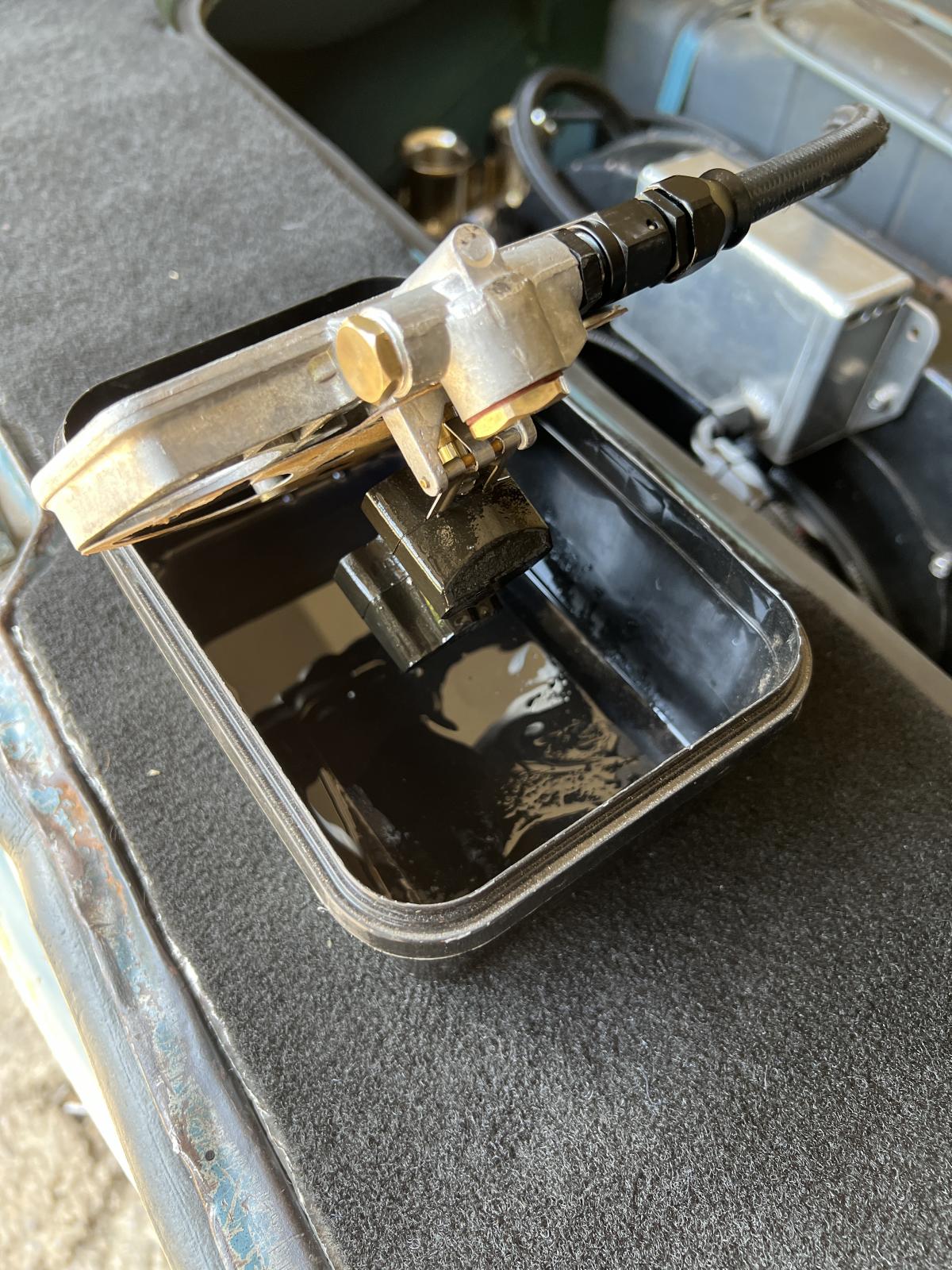

But, disaster, I must have moved the ramp wheel free frame and backing off the ramp the oil cooler got caught and ripped a line off.
What was a nice easy hour or so turned into 5 hours of oil clean up.
Good job there's a sandwich plate, I disconnected that replaced the oil filter and removed the cooler and lines.

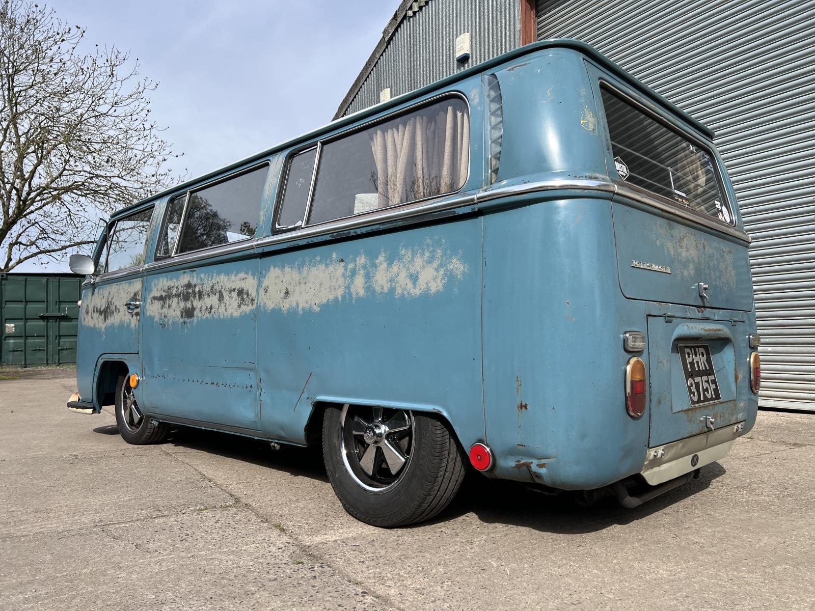

Shock absorber changes.
The deluxe initially was fitted with air shocks, but the closed length at minimum pressure was still too long.
So I replaced the rears with a used set from another bus.
These were bottoming out, so were replaced with a new set.
Anyone want two sets of air shocks and compressors. Laughing
sparkywig
Joined: July 26, 2008
Posts: 171
Location: Bristol, England
sparkywig is offline
PostPosted: Wed Jul 09, 2025 2:54 am    Post subject: Re: Sept '67 (1968 MY) deluxe, another Blakes Bus Reply with quote
I'm quite happy with the ride height.

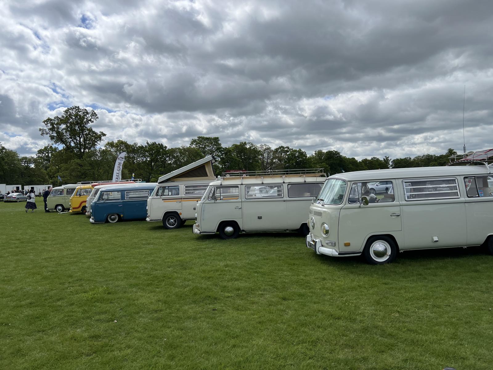

Stanford Hall weekend.

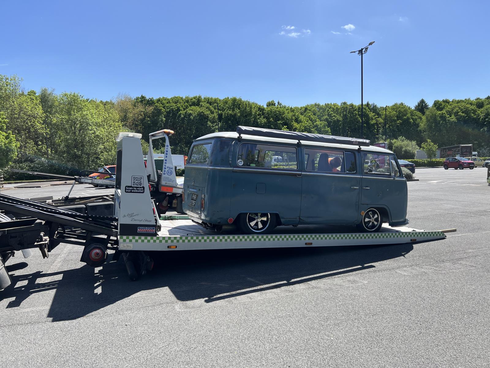

Really looking forward to this, weather forecast is great and I'm meeting my mate Nick in his split for a gentle cruise up through the Cotswolds and a camp out with the SSVC.
But no, this is me. About 30 minutes into the drive the bus started an intermittent misfire, by the time we got to Stow-on-the-Wold it had given up completely and would only run for a few seconds.
We couldn't identify the issue quickly, so I was left at a fuel station and Nick continued his journey to Stanford Hall.
To be fair, I was recovered within an hour.
And then taken to Michaelwood Services on the M5 Southbound for the final leg to the workshop.
Anyway, early Sunday morning I took the Sportline to Stanford Hall with the display banners and set up the earlybay.com stand.
There's a wonderful selection of vintage VWs, and I am definitely looking forward to actually taking mine next year.

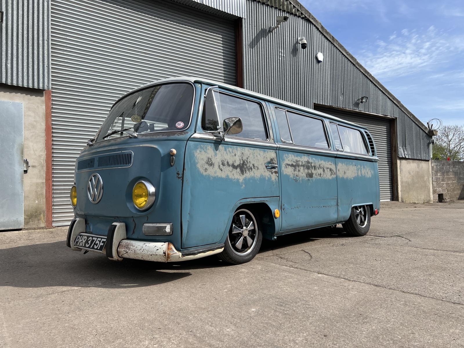

OK, this is condensed from 6 weeks of head scratching and then finding the issue.
First of all it's definitely a fuel issue, as the carbs empty and don't refill at all quickly.
So, carbs stripped and ultrasonically cleaned, new fuel pump and filters, new fuel lines, tank filter sock checked, 12V at fuel pump, and still the issue kept returning.
In the end I was out of ideas, and took the deluxe back to JPR Tuning to see if they could sort the issue.
But with my luck, after a couple of days investigation the issue didn't arise.
Until they were parking it up for the evening and it started misfiring.
The cause, a faulty fuel pump relay.
They by-passed the relay and it runs fine now.
While it was there they did another couple of runs to check the jetting now there's a few miles on the engine.
With the new tune, and I stress it's a not a power run, it was pulling just under 140bhp at the wheels when he backed off at 4500rpm. Very Happy

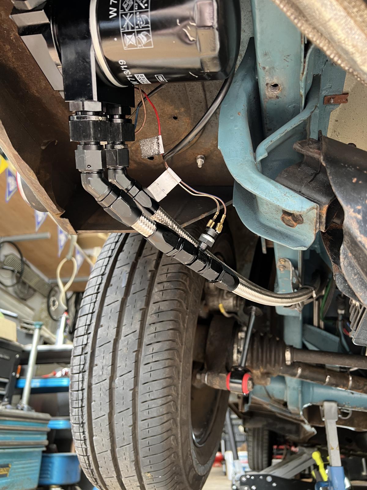

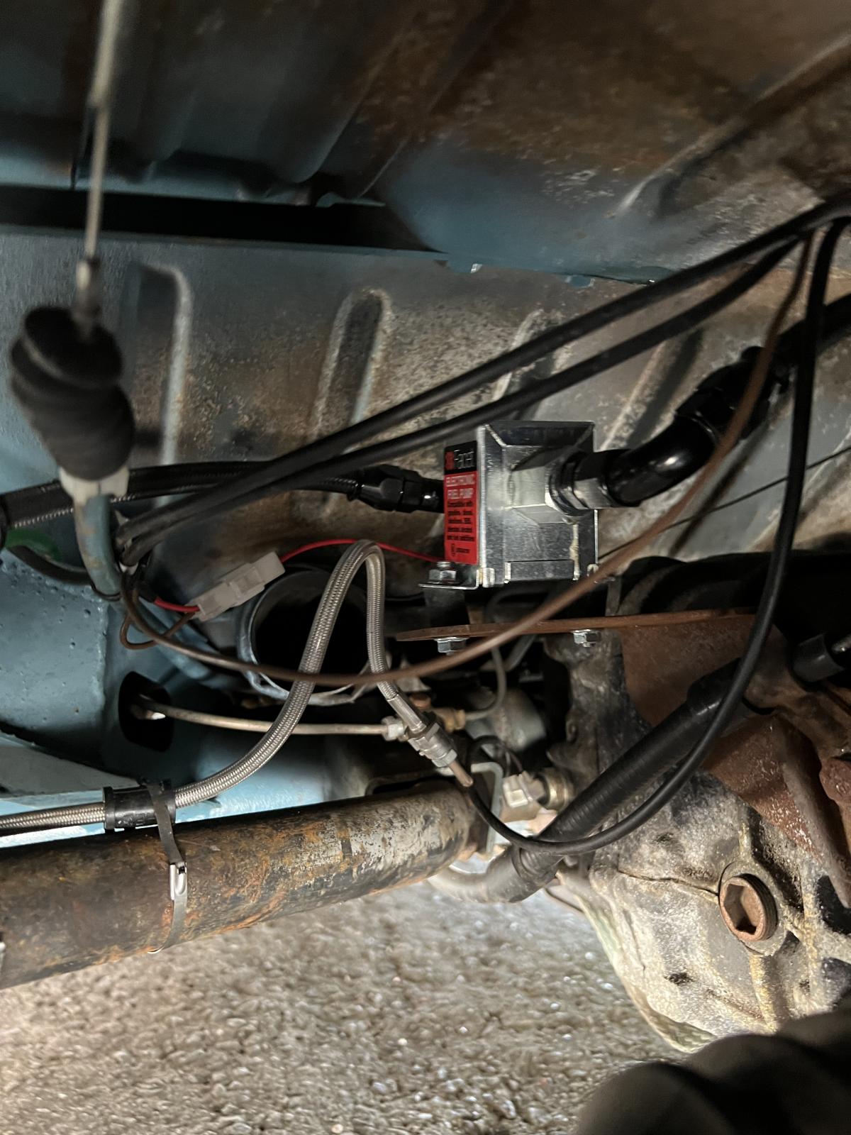

After the near disaster at Nick's with the remote oil cooler I decided to relocate it's position.
It's now mounted just i front of the torsion bar housing on the RHS under the cargo floor.
I drilled a hole in the outrigger to keep the lines above the bottom of the chassis and the cooler has a fan mounted above.
With the cooler refitted, it runs at around 80C/170F to 85C/185F.

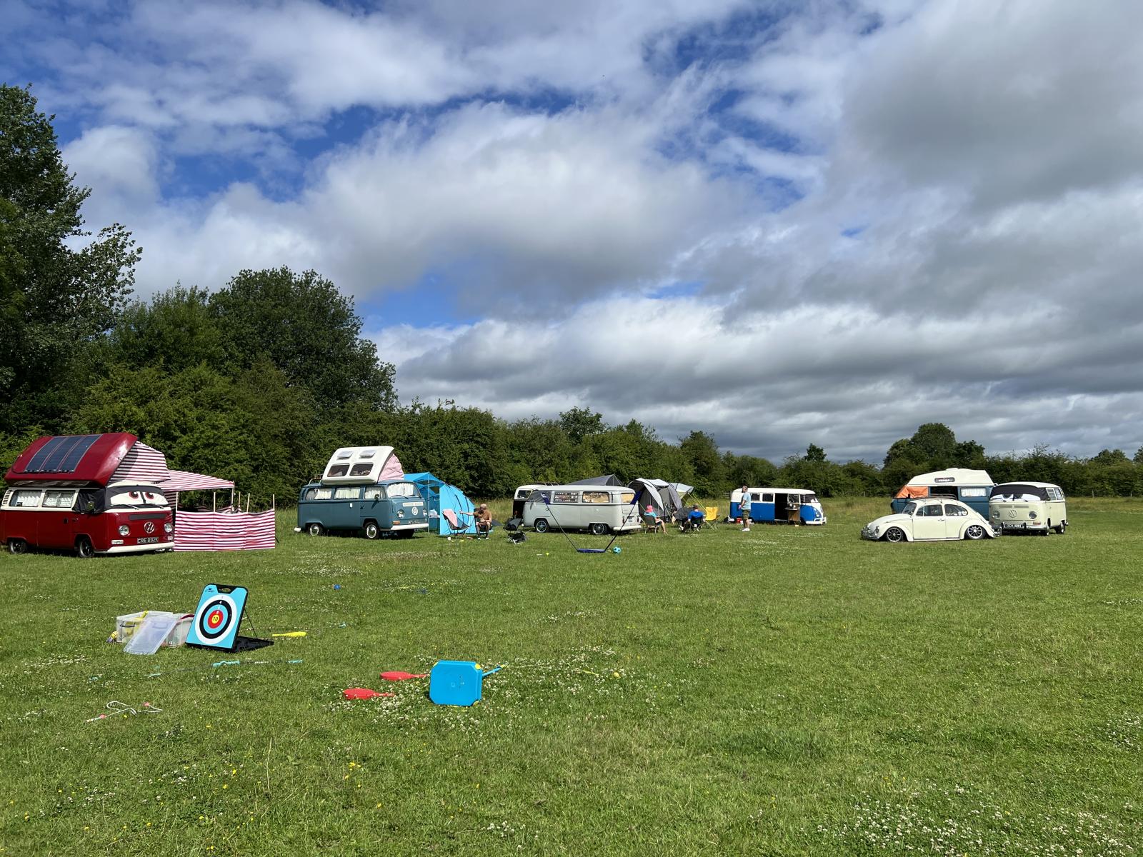

This weekend is the Aircooled Campout, which was normally held nr Banbury but has now moved up North to Astley, Greater Manchester.
So another 400 mile round trip.
Set off on Thursday to meet up with some friends on the way.
There was a massive pothole on the way into the campsite.....

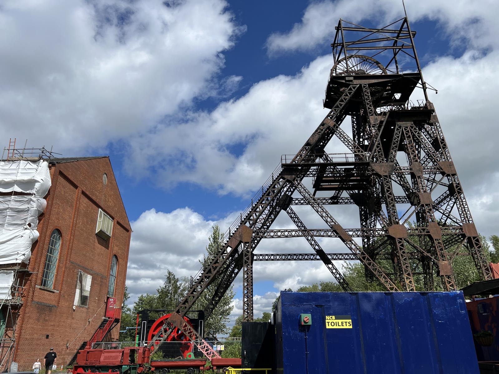

The campout was held at the Lancashire Mining Museum, and the volunteers were amazing giving us almost free rein to wander around. They even started the winding engine for us on Sunday morning.
Overall it was a very chilled weekend, with about 35 aircooleds in total.
Hopefully more will attend next year.
