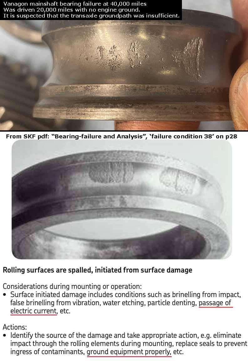

It's not to relax 4th gear,
it's a lubrication "effort" to counter a 4th gear lubrication deficiency that's been known for 20, 30 years (hence the creation of "VW South Africa oiling plates")
What conditions the deficiency occurs.... is lesser known. It's a STORM of oil vapor in there,
and YET,
an erosion phenomena occurs
....one that can only happen in the absence of oil.
We're certain its dry otherwise there would be no erosion.
I suspect the oiling plates (a popular mod) do throw oil up, but this oil only gets in upon downshift or decel.
And the oiling plates logically only throw oil at certain speeds + temperature-viscosities anyway,
two factors that we know nothing about.
This is mostly a long-distance, cruise-control steady-conditions problem.
There has to be a steady condition for the oil to deplete (to dry).
Steady, like "throttle mashed, no decel, no downshift"
Subject title says "Big Engine...."
If you have a WBX, this is of less importance because maybe you drive the van slower, and have to downshift often anyway.
But this lubrication deficiency was appearing back in the day long before big engines. It's just WORSE with big engines,
The owners mainly interested in this are those who have spent big bucks and somewhat understand gearboxes, metallurgical phenomena, or maybe they have a big engine & enjoy 80MPH in spite of their good sense.
Or had un-satisfactory longevity from a quality rebuilder.
The rebuilders themselves "should" be interested.
80mph is for short periods is OK..... but after lubrication has depleted, bad things are happening at any speed where any contact surfaces are dry (inside your gearbox).
The evidence is there. This type of erosion only happens when dry.
I suspect electricity increases the rate because more electricity is conducted when dry.

See my earlier post with photos specifically showing the 4th gear to bearing faces worn, this was in a tranny that has the oiling plates.

Below, is a pic of the Front Main Shaft bearing (thrust side) after 90k miles and 14 years from the DK that was in my TDI Van. It doesn't appear to have been starved for oil.
Below, is a pic of the 4th Gear from the transmission. I never took a close-up pic of the bearing area inside the gear or the main shaft journal.
No doubt, this transmission would have benefitted from a cooling and filter system.

This is a great thread! I have been meaning to post an answer here.
This will be a little long but Please bear with me...
I do not own a Vanagon. However, a lot of the issues and problems and solutions the vanagon guys get into are some of the same I have been diagnosing and working for my VW 411's and 412's that have manual transmissions.
So, I have been lurking here for a couple of years because a couple of people have suggested that you are working along some of the same lines I have been working on.
The type 004 transmission in my 412 has a pair of 18mm x 20mm needle bearings, one at each end on a fixed 18mm shaft supporting a single one piece counter shaft with all four counter gears rotating around that fixed solid shaft. The gear has a single oiling hole in the center and blind ends against thrust washers. In other words...shit for oiling.
Some observations:
1. Going back a page to where you were calculating and worrying about needle bearing speed and load...while you may definately be onto something (meaning the needle bearing application may be under engineered or engineered improperly), unless you are willing to totally change that bearing and shaft at 4th gear out to something this is known to be properly engineered....I say do not worry that much about the load factors.
You have more important fish to fry here.
First, in your calculations you noted you used a tolerance of 50 microns. I hope that was not shaft to needle tolerance. Because, 50 microns...which is only 0.8 microns short of 0.002"...would be a huge and massive failure tolerance for the vast majority of needle bearings we "should" be finding in our transmissions.
Of course, to know what the tolerance should be between needles and shaft you need to ask the bearing mfg and tell them the shaft hardness, the housing diameter, precise shaft diameter, lubrication type, shaft speed and temperature range....and probably more.
All of that said, most small needle bearings like you are finding on your 4th gear and I find in my counter gear....will usually have advertized tolerances LESS than 25 microns in the whole stack up. So, between needles and shaft there is usually ~0.0005" (about 12.7 microns) or LESS on each side.
Also keep in mind that a great many needle bearings that have tight tolerances, actually have "crowned" needles....meaning they are not perfect straight rods. It also means that the center of the needles are usually a dead fit to the shaft and the outer race. At temperature you may find a tolerance of ~0.0001" or 2.52 microns.
2. looking at your picture a page back of the highly polished 4th gear needle bearing shaft race area....I am wondering if your applications have what I have seem in some other VW/Audi transmissons (especially like mine)....which is shafts that are softer than they should be.
Yes, with any bearing (just like lifters and cams) one surface has to be softer. Usually it is the less easily replaceable part like the shaft...that will be harder. But in most transmission I have seen, the shafts are softer than the bearings.
You find this on shaft assemblies in transmissions because the hardening process typically creates a "cast" or bend to the linear part making it no longer straight enough. You cant really remachine something straight after its been surface hardened. So, the parts are not really hardened except maybe some case hardening.
My point....the shaft area should NOT be super polished like that in your picture. While it IS evenly polished and SEEMS to be free of imperfections, you can see that single line near the middle of the polished area (no, you cannot feel that but if I can see it, chances are my surface profile gauge can FEEL it) this also may point to slightly crowned needle bearings wearing a line in the center.
Any burnishing or polishing over and above what it came with from the factory....is metal loss. Even if its only 0.00005" (~about 1.27 microns) on each side, thats a total loss of 0.0001"....or 2.54 microns....which is a LARGE change for a needle bearing.
That goes toward your statement of "slop" in needle bearings and this WILL wear them out fast.
More on why and how the shaft gets super polished below.....
Some of the things I think you Vanagon guys are really onto in my opinion....
1. Yes!!!!....the occasional downshift can probably save your needle bearings!
I will have to go through the Vanagon diagrams but in my 004 transmission, constant long hours of running on the highway will NOT allow oil to get into the single 0.095" hole in the hollow counter shaft that feeds both needle bearings.
Yes, my countershaft shaft has a 20mm hollow center with an 18mm shaft in it and that hollow space around the shaft fills up with oil when you sit still....but...while running...with gear thrust....keeping the counter gear up hard against the thrust washer at one end...THERE IS NO EXIT FOR THE OIL IN THE NEEDLE BEARING.......NO FLOW TRHOUGH OR REPLENISHMENT.
AND...SO....the microscopic bits of metal that get worn off the softer shaft just keep recirculating around the needles and...ARE...."the abrasive" that polishes the shaft and causes it to be probably 0.0005" UNDERSIZED....which will cause chattering and spalling.
So if you have no flow through of oil in these areas, you are trapping oil and the impurities that will be the abrasive that kill your shaft and bearing.

2B. So back to where electrical ground damage and where and how it happens.
A few days back in another post in this forum were some picture from the SKF catalog describing "electrical damage" to bearings. The top picture was NOT from electrical current flow. It was from mechanical "precession" and is spalling.
I am curious which damage you say was due to precession.....
The pic of my bearing referring to page 38.
(more info on this image)
And here's the SKF "Bearing Failure and Analysis.pdf" document
However, the lower picture where you see distinct marks from rollers or balls...IS from electrical contact and flow and is mostly happening when the system, machine, transmission etc....is sitting idle....oil pressure or flow is gone...oil has drained or dripped down...and its metal to metal...and auxilliary systems are still pulling power from ground through the chassis.

In the above-linked SKF doc, there are hundreds of pics of bearing surface failures, but only one pic on p38 looks like electrical.
Electrical damage is easily identified.
Probably should take a look at the SKF document.

EXAMPLE: A Subaru gearbox is a split-case design. The starter is bolted to the left side case-half. At the front of the transmission, the ground-strap could logically ground to that same left-side case half. That continuous casting will conduct a monumental amount of current. Even so, Subaru grounds the starter to the chassis directly, not burdening the gearbox case with "gearbox duty PLUS electrical duty'".
Oh yes! We (the automotve public) were starting to see this even in VW's by the late 80's and early 90's in the watercooled cars. You could see this in Mk1 and mk2 rabbit and jetta with ground cables coming from chassis to engine and from chassis to transmission.
From working on enough of them and seeing ground cables left out and seeing what it caused, I "speculate" that it was not really for carry starting amperage but to create a more electrically "clean" supply for items like the digifant injection (which was very problematic with grounds) and for chassis and cockpit electronics etc.
This is not saying that it did not help amperage flow for starting and charging but the immediate effects from having a poor ground connection or a missing cable were on electronics.
Not worrying about load or bearing speed. 32 RPM.
The effort is to prove that bearing speed is NOT ZERO while the idler is locked to the input shaft.
That the needles do NOT contact the shaft in one line when you're "in 4th gear".
The needles roll slowly while you're "in 4th gear", burnishing the shaft to a mirror-shine.
The shaft center is NOT coincident to the idler gear center.
The two centers are "OFF" by 50 microns diametral slop (50 being an example of bearing clearance).
This causes a precession.
The needles roll slowly on the shaft like a hula-hoop even though the gear and the shaft are locked together at identical RPM.

I'm glad someone likes it.
You're looking at about 8 hours (^^above reply^^).
I enjoy this because it forces me to clarify my own understanding of these wormholes.
Everyone says "someone should figure out why VW gearboxes last only 150k while Toyota gearboxes last 400k."
Indeed.
SyncroShop and I are very interested.
We don''t always agree on 'every detail' ....
For example he likes Synthetic oil, I'm not yet convinced.
I do agree synthetic is superior if driving style overheats your gearbox.
Those with big engines who drive fast, sustained should add a temperature gauge.
We (the automotive public) were starting to see this even in VW's by the late 80's and early 90's in the watercooled cars. You could see this in Mk1 and mk2 rabbit and jetta with ground cables coming from chassis to engine and from chassis to transmission.
Starting amperage and alternator amperage.
Alternator amp-hours is by far the largest.
Erosion is caused by big amps for short periods and small(er) amps for long periods.
The alternator puts out smaller amps but the amp-hours is much much larger.
It's like the "tortoise (alternator) and the hare (100Amps starter)".
If the van has a hungry LiFePO4 battery the alternator amps are pretty big, and hard-charging can sustain "for hours".
Continual electrical gearbox erosion does not put the vehicle on a flatbed like an electronic grounding fault.
But accumulation of electrical gearbox erosion over years eventually disappoints the antiquer.
If you have a big house battery, it's faster.
I had mainshaft bearing that grumbled after 20,000 miles.
If you make sure your gearbox is grounded for big starter amps, and your alternator case
is grounded for lesser amp numbers (but much higher amp-hours)...
there's
by default,
sufficient current capacity for all the milliamp ground demands of sensors and electronics.
Not to mention diagnosis efforts being more conclusive, and shorter.
The big grounds need to be qualified "under load" though (the voltage drop test), not static (the ohm-meter micro-volts test).
Little grounds, sensor grounds, generally don't need to qualify "under load",
especially if the big grounds have less than 0.2volts drop "under their big loads".
Incidentally, little sensor grounds, added willy-nilly, are at risk to burning up if the high-current grounds are the actual fault.
If you add little sensor grounds (for testing purposes) it's wise to NOT bundle them against other important wires.
Suspend them where they can burn up (fuse) without melting other insulations, and no secured with plastic cable ties.
If you understand the why this is a risk, then focus instead, upon making your high-amperage grounds "proper".
And omit the little sensor grounds.
Ah!...got it! More clear what you were getting at.
But...I persist....you should NOT have a mirror shine like that on the 4th gear shaft. They are not that polished from the factory. When they are that polished....there is no micro-tooth to hold lubricant. While something like a crankshaft is polished with 360 to 600 grit and a needle bearing surface maybe a little finer......it should be smooth with general polish but not bright with "mirror" polish.
On one hand...looking like that....it does seem to be running evenly...but to get to that state of polish, enough high points from thesurface profile have been removed that you have changed the tolerance. Its wear.
It gets this way because the needle bearing is harder than the shaft.
This is an issue that is too common in transmissions and even more so if flow through oiling is not great.
The 4th gear idle needle bearing race gets mirror-burnished and you can't measure a difference between the shiny part and the un-touched part.
Only when they are stationary can the needles "false-brinnell' the shaft.
If they get 'chocked' by break-in trash, they can become stationary.
Yes....and when they are stationary....oil is squeezed out....AND...if there were an abnormal amount of current being pulled through the shaft from a grounding issue...this is when the surface of the shaft would be the most susceptible to electrolytic erosion.
Not stationary though, it's dynamic.
And more importantly, it's not accidental.
It's electrical erosion due to amps crossing precision rolling elements.
By design, because the gearobx hasn't been "ISOLATED from the two biggest (attached) electrical machines".
Alternator and Starter. A sustained high-amps-Producer and a periodic 100Amp consumer.
Direct grounds from the housings of these two machines is the best bet to protect wayward amps from crossing precision rolling elements.
It's easy and $15 to reverse this poor design.
Everyone who understands ground-cable installation, should change grounding on their van to gearbox case ISOLATION.
OK...a couple of things:
1. Burnishing is not the same as polishing. Polishing always removes material. Burnishing works by smoothing over the edges of the scratches and closing pores in the metal (quote stolen from NAWCC website because its good).
Burnishing creates a smoother measurable (not always visible) profile, many times without changing the tolerance very much at all. It does not remove metal peaks in the profile, it bends them over and is directional.
Agreed. It's more like forging than grinding.
Burnishing toughens the surface!
The shaft and gear are vulnerable to Brinnelling when 'new & raw'
Brinnelling commences when 4th gear dries out (sustained load in 4th gear).
Even worse when it's a big engine in the meat of it's torque curve (70-75mph) if pushing 2x harder on it than it was designed for.
For hours.
Also.....rarely will it increase polish or luster. I totally agree...burnishing in of a bearing is a good thing. This is precisely why for instance that you have two different tolerances listed for setting pre-load on something like a differential bearing. One for brand new and one looser one for bearings with 30 miles or more on them. They have been burnished in.
BUT....when you see POLISH...like mirror polish...you are seeing thermeoval of metal.
The question of when it becomes significant on a needle bearing tolerance will typically matter depending on what type of needle bearing.
Dunno about that. Look at AnyBees lustrous mainshaft.
When they start wearing out the shaft....they start bouncing....which causes BRINELLING.....which brings me to...
2. Brinelling does not heal. Brinelling is caused by repeated pounding, creating dents which compacts the metal and creates spots that are not only harder but havea new dimension and tolerance within those spots. It only gets worse.
Brinnelling is from pounding. Material is displaced.
False Brinnellng looks like brinelling but has no raised edge.
False brinnelling is from erosion. Material has 'departed'.
I have a shaft here that appears like it 'rolled out' some early brinnelling to a lustrous, undulating shine.

you are the ONLY forum in this entire site that discusses or understands this.....the oil gets hot....it thins....it breaks down.
You guys have actively been working on force fed oil and cooling and worry about temperature. I cannot tell you how many discussions in other forums have stated (and this is very type 1 centric thinking)...."manual transmission oil does not get very hot). Uh...yeah...it does....and I have measured it in my 004 transmissions.
On long highway drives in 100* weather, I have clocked 200* F constant and peaks over 250*F on my gear oil. That is TOO HOT. Over the years I have lost about four of these 004 transmissions (which are far more rare even than synchro transmissions). The autopsy's always pointed to a combination of not enough lubricant in specific places (design issue of the needle bearings) and overheated and thinning oil in others.
While 250* is not THAT extreme....it is when there is less than a thimble full of oil on each needle bearing in a dead end bore at each end of a shaft with no flow through. If one could just occasionaly get another thimble full in there to displace what is over heated and shear thinned....damage could be avoided.
250F is NOT too hot for oil, especially not too hot for synthetic.
But it's definitely too hot for a gearbox case of white-metal that holds bearings by thermal-fit alone.
The Vanagon mainshaft bearing loosens at 180F when all is "new".
The bore wears, and many have become loose at room temperature.
A split-case, with preloaded steel bolts holds the steel bearings better at high temperatures.
The Vanagon gearbox relaxes it's thermal fit at the mainbearing bore at around 180F.
So above 180F, bad things are happening.
The shafts are moving apart as the case expands, and the gear pitch circles are no longer in alignment, thus tooth face contact is sliding, not rolling.
Lots of un-desirable things are happening.
Now there's "sliding at tooth faces" .... which have thinning oil.
There's a long list.
Sustained, fast, peak-HP-curve usage is where you want 85w140 oil.
If you like to drive like this, you should then "accommodate" the laborious shifting when cold.
Incidentally, as the mainshaft bearing bore loosens, then less electricity flows across the mainshaft bearing, protecting it somewhat in its old age.
A new, tight bore will logically pass more errant electricity to the front groundstrap, lessening as the bore wears.

This subject of 4th gear has two forks.
Electrical, and Lubrication.
They are both assaults, but one is easily solved with $15 of proper grounding.
The discussion of why to invest in this grounding change does take a lot of effort.
I think it should be a very short discussion culminating in a $15 investment and install. Better yet $30 and ground the alternator case too.

PostPosted: Sun Jul 13, 2025 8:22 pm    Post subject: Re: Big engine + NOT downshifting.... damages 4th gear Reply with quote

PostPosted: Sun Jul 13, 2025 8:34 pm    Post subject: Re: Big engine + NOT downshifting.... damages 4th gear Reply with quote
GoEverywhere wrote:
Well... This thread might have just become an lesson for my high powered Vanagon. Just lost my 4th gear. I'm curious when I pull it out if its gonna be a failure like you've all been talking about here, or if something else let go!
If you still have 3rd gear, likely that "high powered" engine ripped the teeth off 4th gear. Is the transmission OE?
I rebuilt one for a guy about two years ago that all the teeth on 4th gear were gone. He drove it many miles in 3rd gear on secondary roads to get home. I upgraded 3rd & 4th gears with the Weddle racing gears that have heavy teeth and lots of nose.

GoEverywhere
Joined: December 13, 2020
Posts: 859
Location: Portland, OR
GoEverywhere is offline
PostPosted: Sun Jul 13, 2025 8:52 pm    Post subject: Re: Big engine + NOT downshifting.... damages 4th gear Reply with quote
AndyBees wrote:
The transmission was upgraded with various weddle bits before this engine by my local trans shop. But I'm 100% absolutely exceeding even those gears power capacity(I had it built for my previous 170HP engine.) . I drove mine home about 50 mile in 3rd on back roads to get it home. 1-3 seem totally fine.
So if 3rd gear was still there its not the under oiling issue they're hunting here? Maybe its just reading this thread recently but thats right where my brain went.
So if I had the 4th under oiling issue 3rd
