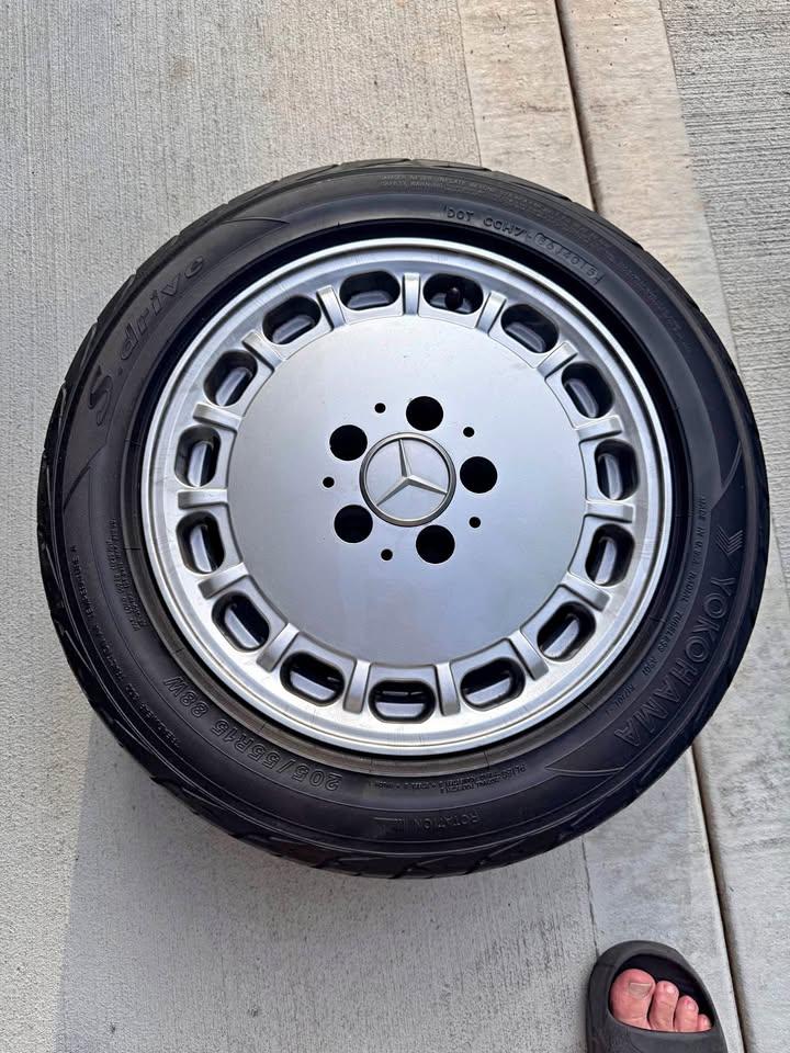

Will these wheels fit without modification? 83 Westy.
Im told they're off a 1986 190E
I believe its a Gullideckel W126/107.
Looks to be 15x7 with a 25 offset. Center bore looks good. So that all seems to add up to work, but I'm not sure of the lug hole measurements, I think they're the 14mm?
