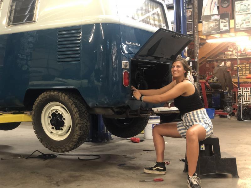

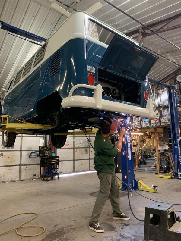

We drove out overnight but lost a lash cap and the rocker loosened up after we got up Baker Hill. Re-did the valve adjustment at a gas station and got back on the road. Drove till 5:30am when the sun was coming up and pulled down into a canyon to sleep. Turned out the hill we drove down was way softer and had to air way down after the 4th try. Hung out in St George for the day to avoid the heat and went the rest of the way to Colorado starting at 3am. Made it to KCW without any other issues but decided to give it a full tune-up to be safe and put the new 1 5/8” heater boxes on. Found the lash cap in the oil sump. We re-torqued the heads and it seemed like we got a bunch of turns on them. As we were leaving for a river trip in Salida my bus got super hot and slowly died in front of the shop.
ore into the motor to inspect the heads and pistons because we could hear a small clicking noise when turning it over. It was also super hard to turn by hand. Everything looked good though, so said what the hell and put it back together, re-torqued heads in sequence and did valves blah blah. Clicking seemed to be the rocker not seated correctly. Stabbed the motor back in, seems to be running fine now? No weird noises, not too hot.
