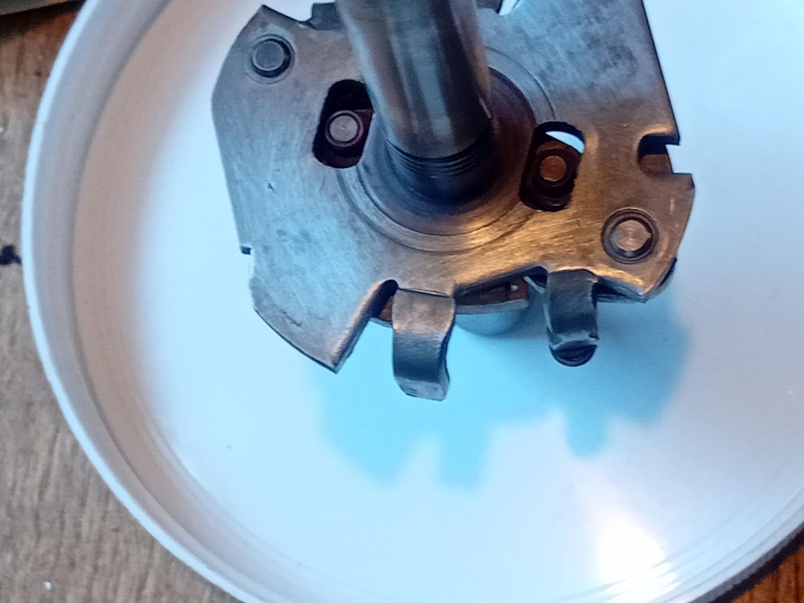

Hi,
As the felt washers had disintegrated and disappeared i need to know please wherever they were.
The ones I found did not list what type of washer, metal or other and on a drawing looks all the same...
Thanks
Ps am looking for those 2 black plastic half moon parts that sit inside the weights towards the shaft

I sell the Bosch fiber washers with the dimples in them. Those will sit next to the bushings. To the outside of those are metal shims. I have a kit which includes them all.
As for those plastic pieces no one that I know of manufactures them. You have to take them from another core. They rarely are bad unless you have a lot of heat and use on the distributor.

When you remove the shaft from the distributor there is a shim then a fiber washer on it. Then you put the shaft into the distributor body. Then a fiber washer and then one or more shims. Doing this will place the fiber washers next to the bushings. The fiber washers have dimples on them. Those dimples hold oil next to the bushings to keep them lubricated.

PostPosted: Fri Jul 11, 2025 2:50 pm    Post subject: Re: Air or water-cooled distributor parts diagram Reply with quote
Washer under this maybe?
Dunno how I got that far, with posting image. Or disassembly...

In the picture you posted you put a shim there first. Then you put the fiber washer on. Then you insert the shaft. Then you put a fiber washer on the shaft. Then you put shims. Then you put the drive gear.
The washer inside can disintegrate completely. Sometimes you can find parts of it there.
When you put the red fiber washer in the oil does it change color? If it does it is not made from fiber. The fiber washers do not change color. Fake fiber washers made from paper will change color. You don't want paper ones. They are not the correct material. It's really hard to tell the difference but one easy way is a color change. If you think it's fake you can bend it back and forth and you will see the layers separate but only when it is dry.
