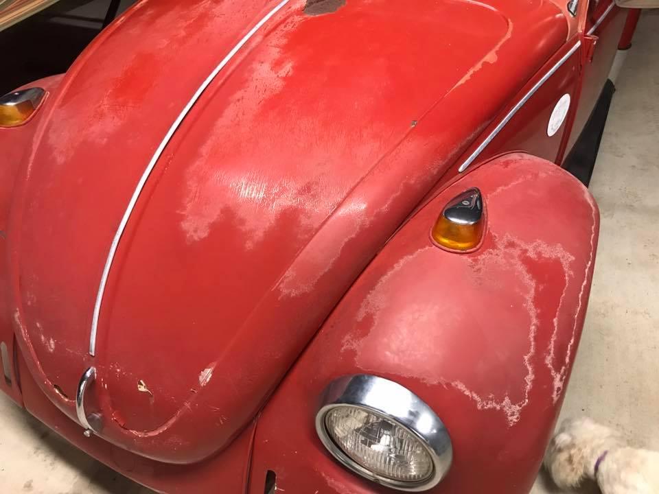

Yesterday, I started cleaning her up and removing the surface rust and oxidation. I used some 0000 steel wool and 409, and I was amazed at the difference! I was also surprised to find that about 85% of the paint is original. I’m going to compound and wax her until we can repaint her this winter.

That oxidized paint rubbed out very nicely! After you get finished with the rest you might have a great patina look to preserve. I know that's not your plan at the moment, but often times our goals change as the project gradually progresses. Looking forward to following ... Popcorn

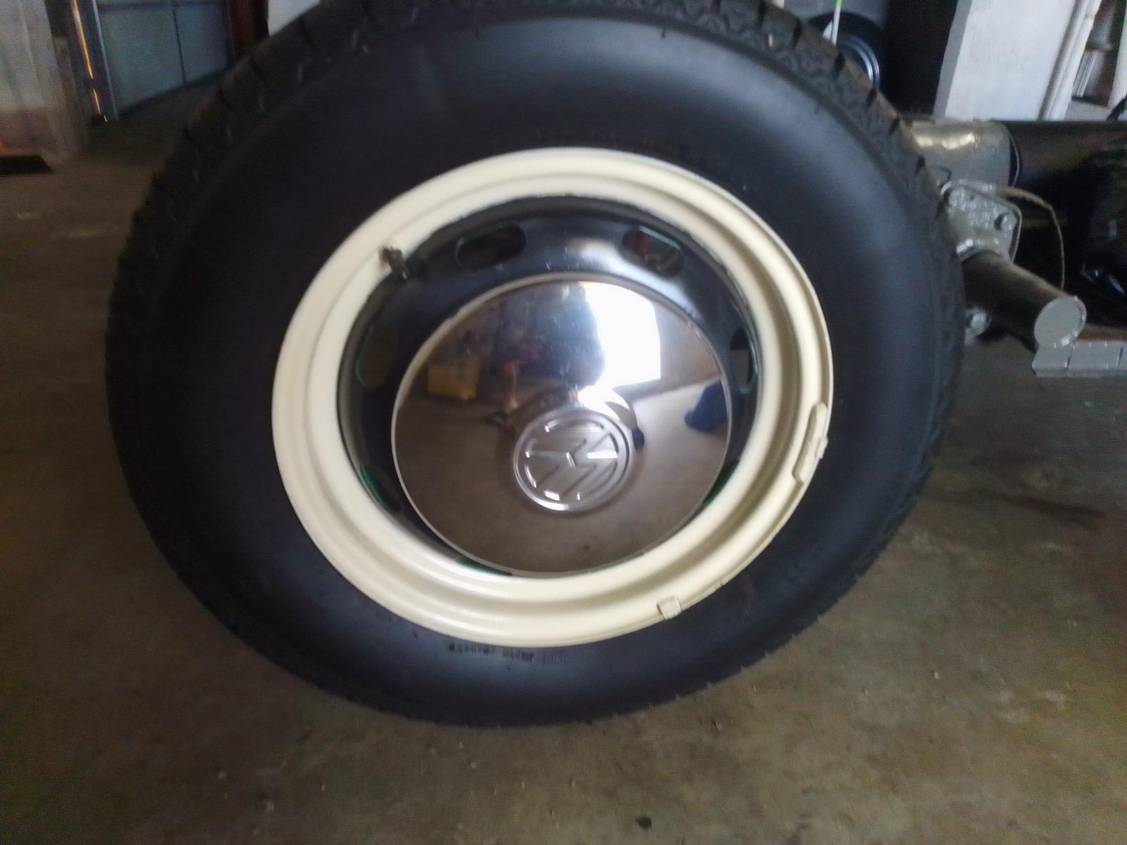

" Ella" appears to have a bright future. She is going to look real good when you are done. I don't know what your plans for wheels are but originally they were black on the inside portion and off white on the outer portion of the rim. I think it gives the car a very original look at first glance., like the picture I have attached.

I think this is the first I’ve seen of this! I am having an internal battle of whether to stay original or go stock street style….

Yeah in 1970 vw went to the silver or argent painted wheel, which looks to be what is on your car now. I like either of those as they look very classic with a shiny set of stock vw hubcaps.

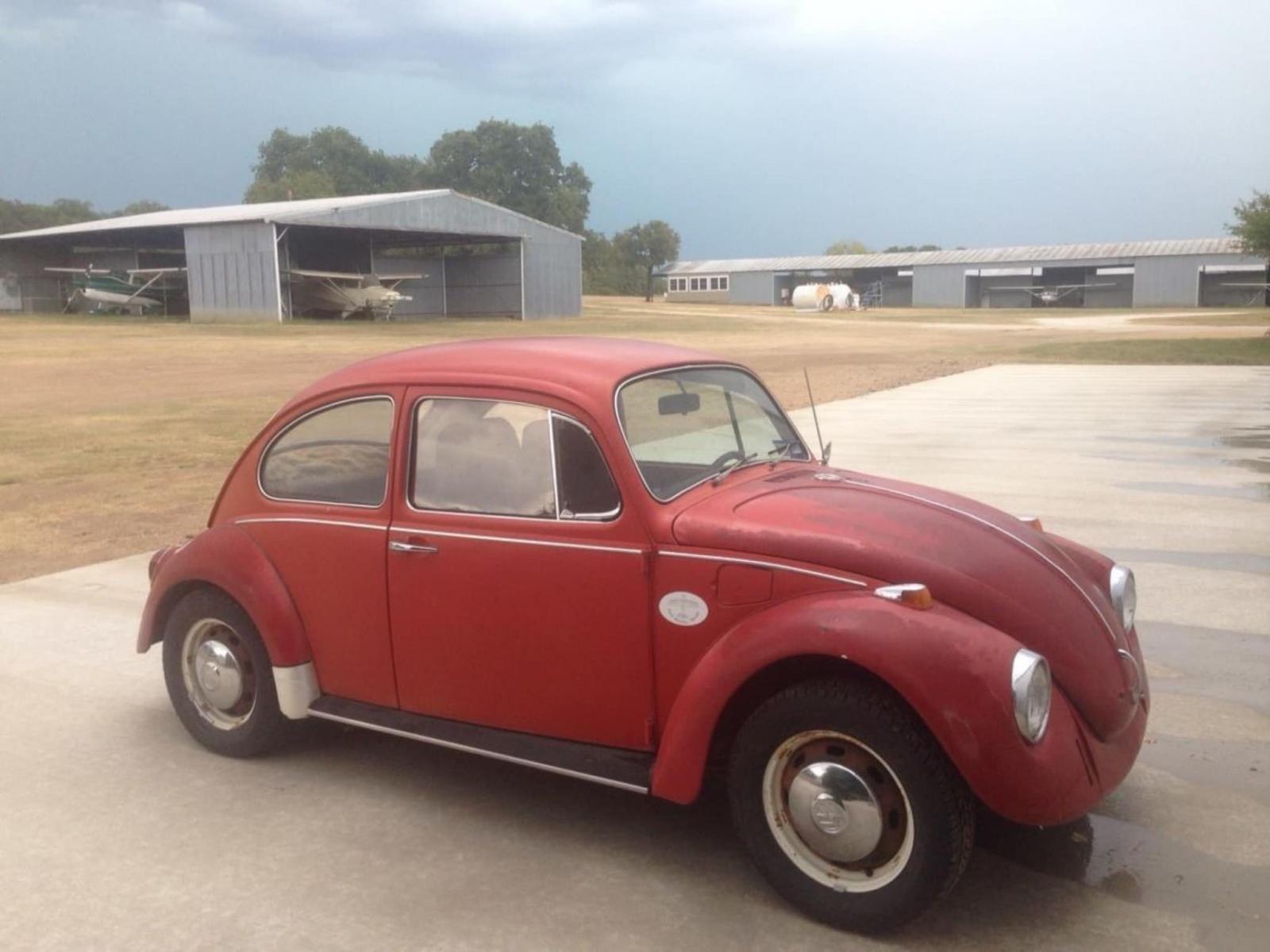

Well this was fun. I was filling out my registration paperwork and decided to search for the previous owners name (the guy who sold it to the guy I bought her from.) Found all these photos of her from a few years ago, and of her engine fire!
And this was a joke they played on the previous owner. The guy I bought it from told me the story about the license plate they gave him. (His last name was Cook! LOL)

Wow those are some sad looking photos. Ellas second life will be better under your care.

Did you notice her wheels in the pic at the gas pump Bob? Black and white just like you said!

Yes I did but I did not want to torture you any further about that!

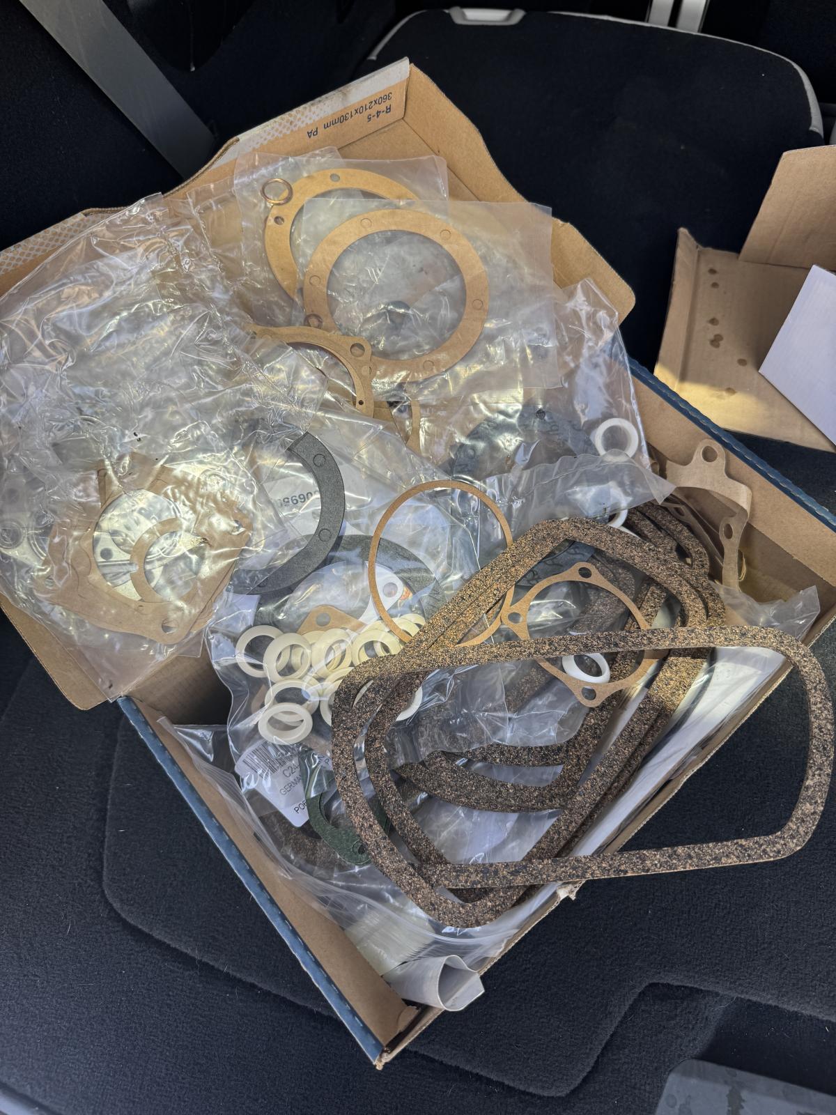

Boy you VW hippies are a very cool and gracious crowd! I bought an engine stand from a guy today for a song.
And he GAVE me a BRAND NEW PAIR of running boards and a box of gaskets! Super cool guy!

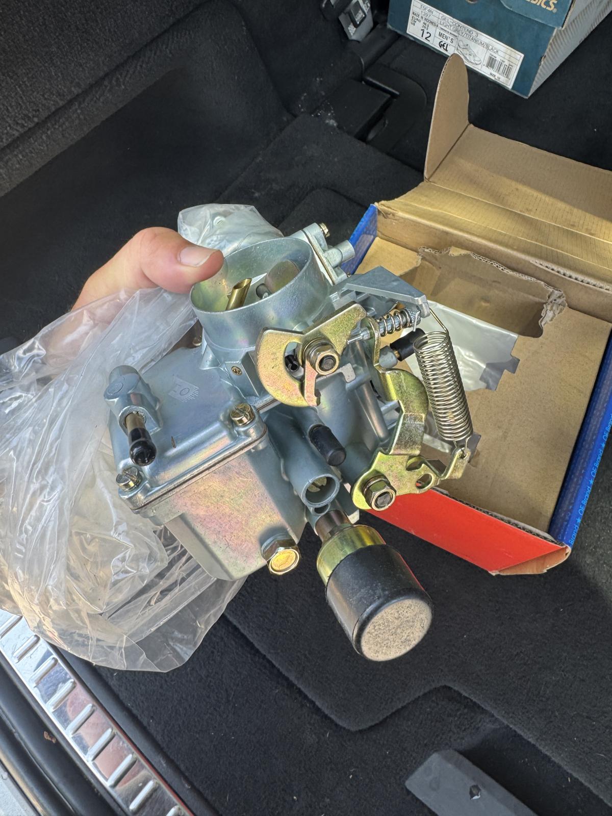

And then because I work nights and got off work at 6am, another guy who lives close by and picked up the stand for me, GAVE me a brand new carburetor!

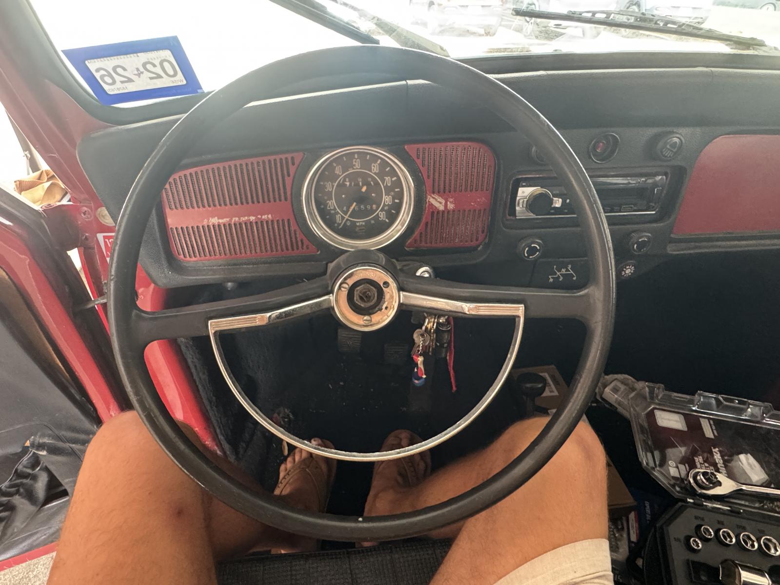

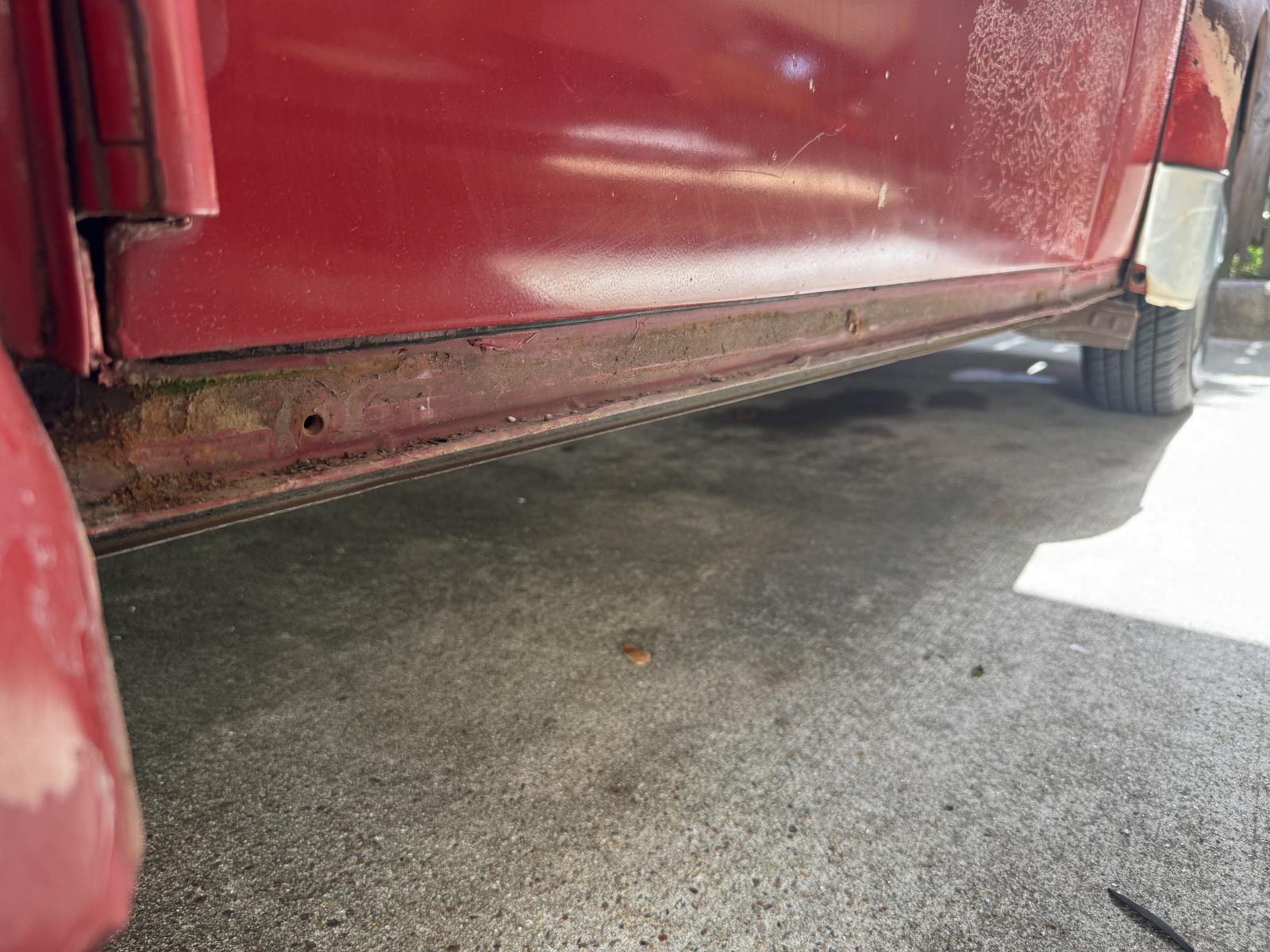

And I also stopped by the local air cooled shop and met the guy who owns it! He hooked me up with an original correct steering wheel! The horn ring screw holes are stripped but I’m going to fill them and redrill the holes, and restore the rest of the wheel as well.
And I couldn’t help but wrench on something so I took my old boards off and got a good look at the body. NO RUST! Wooohooo!
I have a lot of research to do tonight on carbs and tomorrow I have to go get new bolts for the new running boards!

The ivory round "donuts" in your gasket set are for the pushrod tube ends. Those are the better quality ones; cheaper sets have those donuts in "brick red" which tend to split in only a few years.

Nice score on the parts today Chris. Your car looks better all the time like the rocker panel you showed in the photos.. is the carb a Chinese copy? Since it was free you can try it as you have nothing to lose. Keep up the good work Bob
