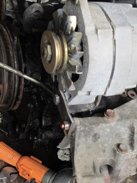

The first is that the engine is eating alternator belts. The alternator seems to be slightly cockeyed. I am going to try to shim or do something to align it.

The original alternating mounting on these engines is a crime and yours has likely been repaired poorly. You can buy a brace for the alternator mount from GoWesty and others and you can add the simple mount I made up as well, the two together give a nice hearty mount that isn't going anywhere.
You can see the added strap in this picture, you can also see the added weld for the factory mount beneath the alternator. If your original mount broke and was repaired it might be catawampus, if so buy a new mount and added the weld before installing. The mounting hardware for the factory mount can also break or strip their holes out. Sad
Best to do everything you can to improve the mounting so your alternator mount doesn't leave you stranded far from help.
FWIW I have been running a Delcotron alternator for nearly 20 years now, as my original Bosch seized a bearing outside of Ely, NV and a replacement Bosch was days away. I jury rigged the Delco on and have never seen any need to go back to the Bosch, though I have never been able to get my idiot light to work.

Good idea on adding whatever bracing can get put on. That looks a lot beefier. I do have the original gen 1 GW alternator bracket on there, but I am sure I can get more metal on it.
