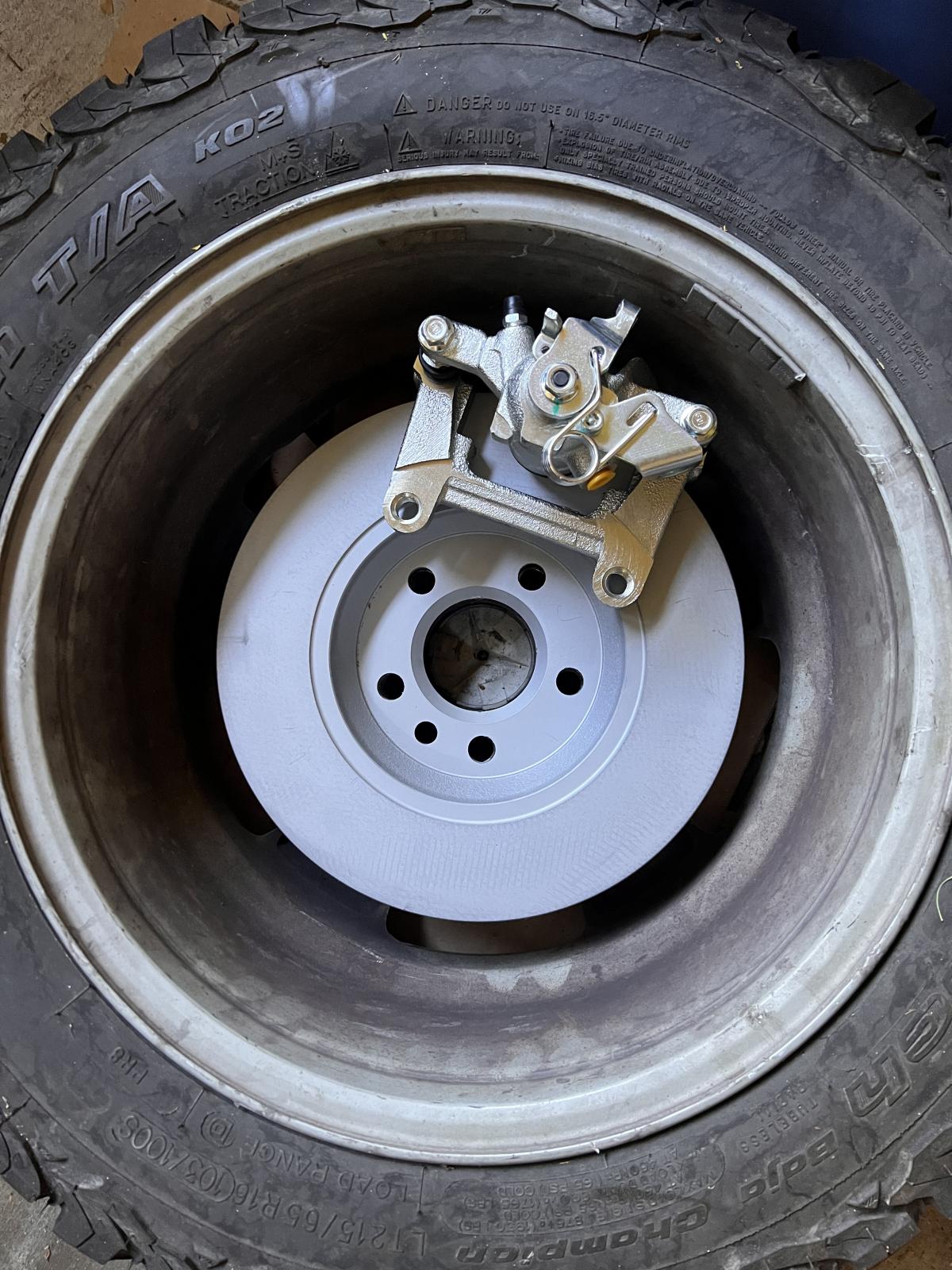

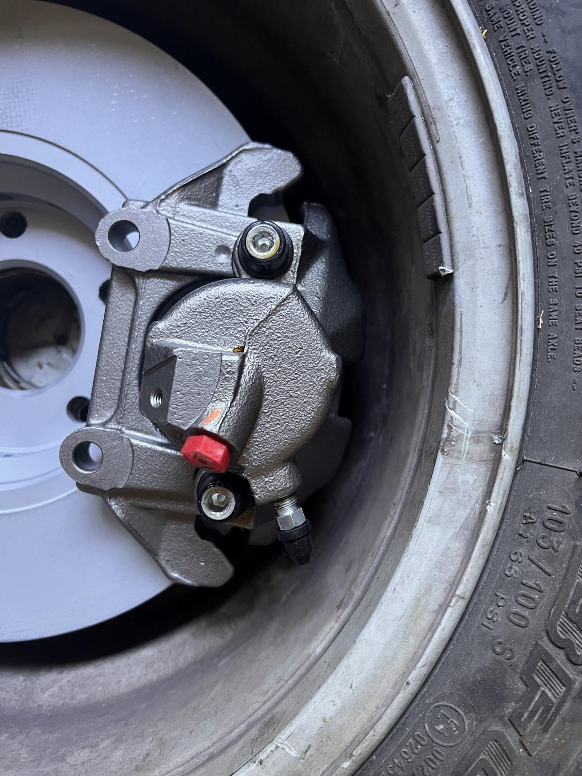

I know I am once again digging up an old dead thread. But, for me it is current. I have recently discovered the videos from John (which are great by the way) and they have led me to purchase the adapters from Epytec. I was looking at what Burley Motorsport had to offer, however I am reluctant to buy anything form the States due to the current Leadership and looming trade wars ( or perhaps real war, 'cus you just don't know). It seems as though Burley's are suspiciously identical to what Epytec has to offer, which for people in the US would be a better deal. So?
Anyways, I will be swapping to the 312mm front rotors and the 294mm rears. The fronts are essentially 2001 Audi A6 4.2v8 and the rear are 2003 premium Eurovan. This should be a big step up from the stock 258mm fronts and drum rears. All of this should fit inside my 16' MB alloy wheels.
I am too lazy to post updates about the process, but I will update once done to report on the results.
Gordo.

Okay, just a minor update. I have purchased the Epytec front and rear adapters and I am waiting for it to arrive from Germany. Meanwhile I have purchased the rotors, which are 2001 Audi A6 312mm front and 2003 VW Eurovan 294mm rears. I also have picked up new rear calipers (VW Eurovan) and front calipers (Ate57s from the A6 with 288mm rotors). Brake cable are on the way also now that I know these rotors and caliper fit in my Mercedes wheels.
I will post more pics once the adapters and hubs arrive from Germany.
gordo.
