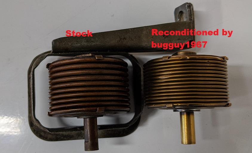

bugguy1967 Helped me out with a ton of new parts to rebuild my flaps. I also picked up a recondition thermostat from him. It is more compressed than the thermostat I already have. I will post pics later.

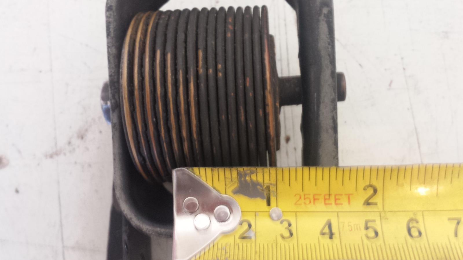

Speaking of which...
is this thermostat toast? (This is after the car was sitting for 3 days.)

Looks OK to me.

Looks good.

It looks open a little to me but that could be the ambient air temp.
Is that dirt/grease on it? You could clean it up a little or put it in some boiling water and try to scrub it a little.
Maybe there is grease in the crevices preventing it from closing a bit more.
I know you know this but for anyone reading:
Leave it in the bracket so it doesn't over expand in hot water or with a heat gun

I mean, yes there is room for it to open a bit until it hits the top of the bracket, but if installed correctly with that point having the flaps fully open, wouldn't that mean it can't really pull the flaps back closed at its most retracted position? (BTW I've had that one stored indoors with the AC on for the last few days, so it's at its most retracted position. I suppose it may have some crud in it though that is keeping it from fully closing.)

Hmmm-- here's a second thermostat I forgot I had that's WAY more compressed when cold:
Bad camera angle but when looked at dead on this one meets the "5/8 rule" discussed earlier in the thread. The first one clearly does not.
A heated ultrasonic cleaner does a great job.
Agreed, but brake kleen and compressed air is nearly the same, if it's really stuck down in there floss it with some string or thin cardboard. You can bend the thermostat slightly to one side to expose the bottoms of the pleats, but be careful, go slow and do a little at a time.

A little bit of an update. Here is a pic of the reconditioned thermostat I got in from bugguy1967. It looks a lot better than what I have. I also purchased all new hardware from him also. Since I am working with a car without the flaps/thermostat I am trying to reinstall it.

You can easily see the differences between the two t'stats above. The left one has less bellows fins, but each one is thicker with a rounded edge. The right one has more fins, but each one is thinner with a sharp edge. I don't know if each style is indicative of a specific temperature range...
The physical “style” of thermostat (i.e. number of ridges/bellows) doesn’t determine its operating temperature range. It’s the “working fluid” inside which does that.
I think that in the 65°-70°C temp. range thermostats, there is a small amount of methanol (boiling point approx. 65°C) based mixture inside. While in the 80°-85°C temp. range ones, suspect that the working fluid is small amount of ethanol (boiling point approx. 80°C) based mixture inside.
In any case, the operating temperature range for those thermostats is usually stamped somewhere on the top or bottom sides.

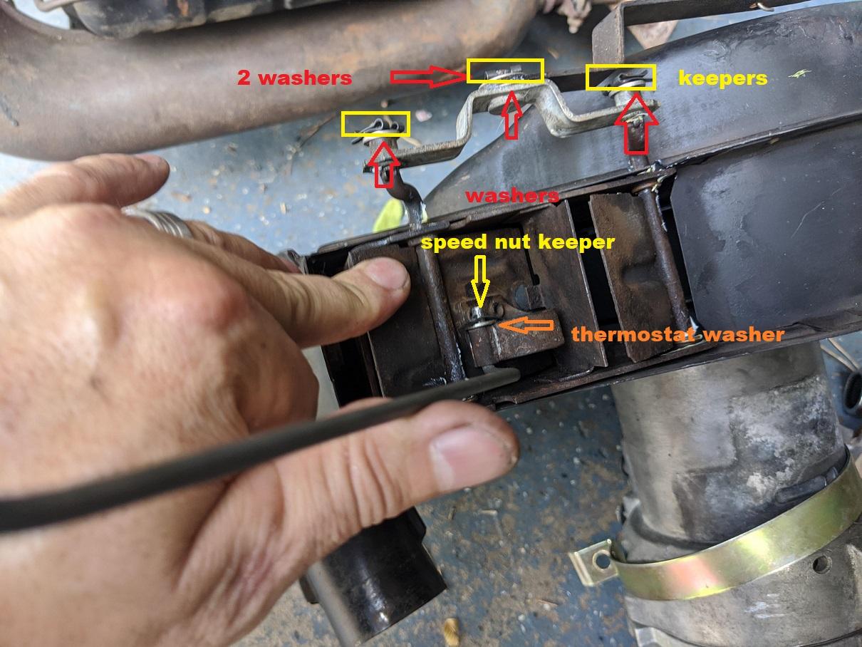

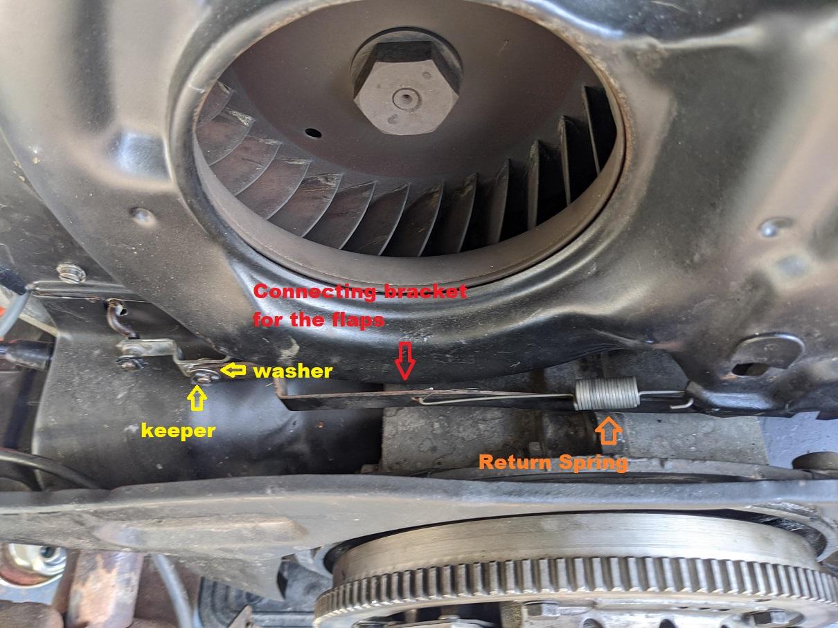

I did a dry run of the installation of the flaps before I put the doghouse on the engine. You have to install the flaps connecting bracket after the doghouse is on the engine. When installing the dog house with the flaps installed you have to line up the thermostat rod to go between the second set of cylinder fins (towards the engine).
Here are some pics.
