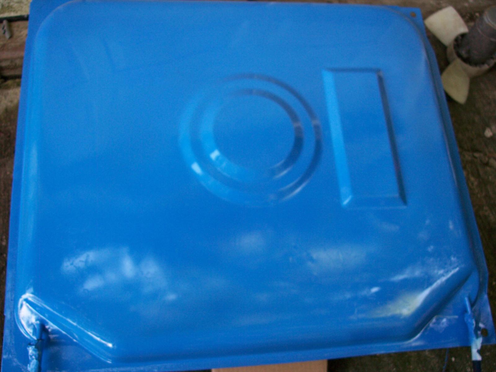

When I receive a new Fuel Tank, i clean and rough up the paint with Scotch-Brite and sandpaper. Then, after further prepping, I give it a couple of coats of paint.
Below are pics of the tank I installed about 11 years go. I had it out last summer and gave it another coat of paint after prepping. It was the first tank that I installed without prepping before painting, You can see the "before" photo that it held up pretty good. Also, a peek inside never showed any rust. The photos were taken outside so you are seeing some shading/lighting affects.

Thanks for sharing that. What are you painting it with, spray cans or a better setup?
Where did you buy that tank / who made it?

I used paint from Tractor Supply. It was something over $7 or $8 per can.
The tank come from eBay ...... likely China made.

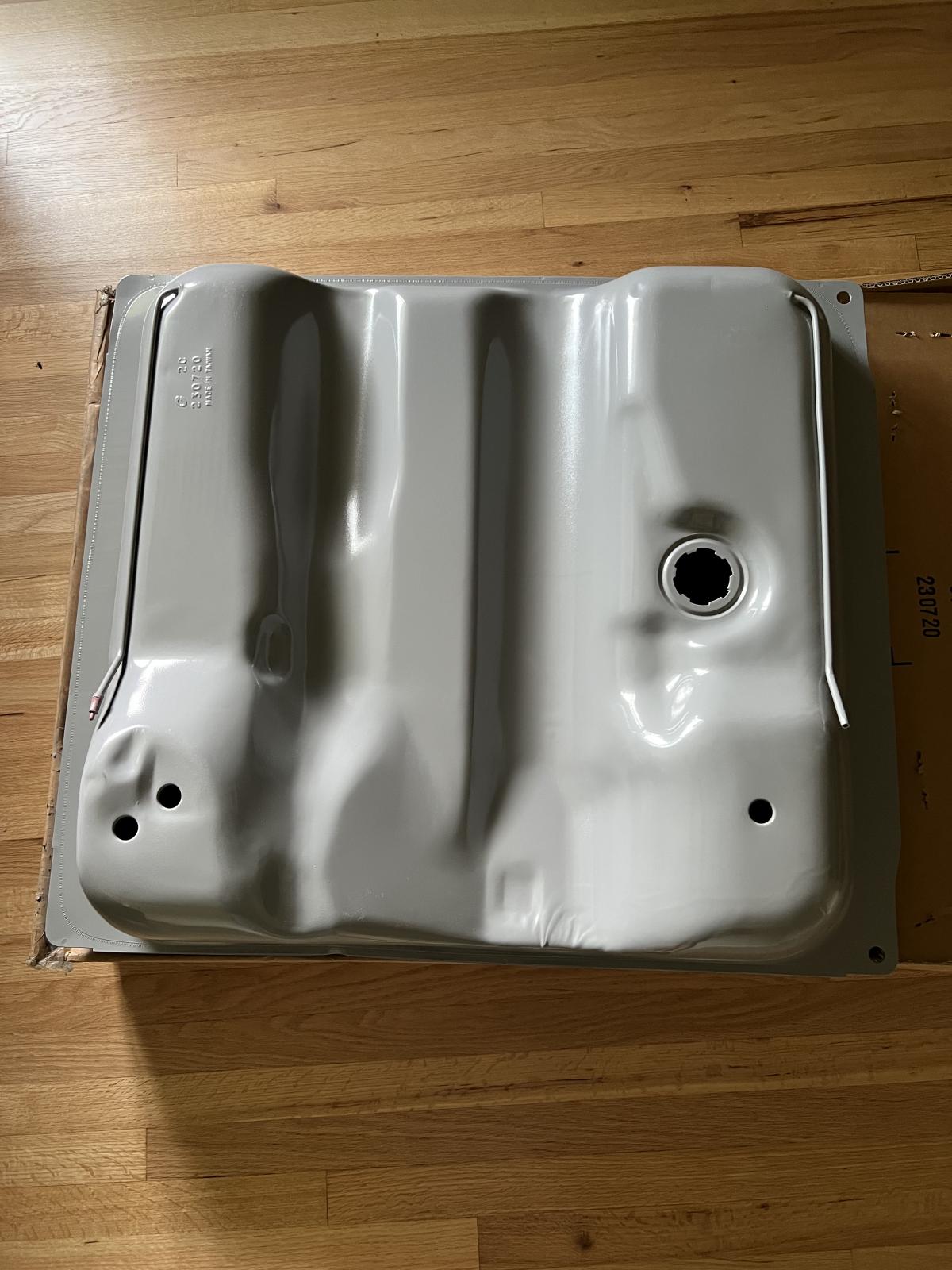

I ended up going with a spectra tank. I based that on not being able to determine if I am really getting meaningfully better quality from a more expensive tank that I would have to pay to ship. Plus, I got 15% back through capitol one.
If I had unlimited resources, then maybe I would support a smaller business and buy from a VW specific vendor. Which I do for most other van parts.
I'll post about the visible quality when I get it.

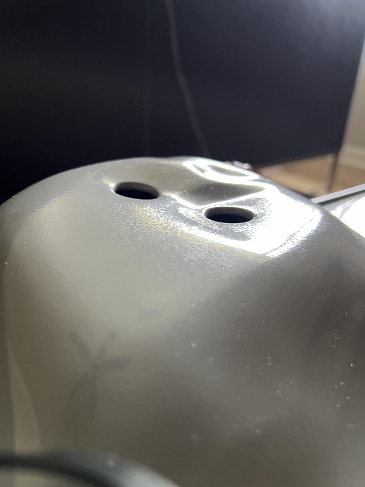

I got the tank. I'm concerned about the location of these dents. I'm afraid the grommets won't seal well. I haven't dry fit anything yet though. Of course, my dents had to be in that spot. ugh

Aside from the shipping dents, the tank looks good. Made in Taiwan.

if you got time for it to sort out - what's the replacement/return policy for your seller?

Pop them out with a slide hammer and some hardware. 10x faster than a return which will come ship damaged again,anyway.

return wouldn't be an issue. dent roulette all over again though.
I don't have slide hammer experience, maybe I can rent one and give it a try? I was thinking a tool used for paintless dent repair, something curved to get up in there and massage it could work.
I wish I just got the bent tabs. Ha!

well, I put the new grommets in there and they seem to seal nice and tight. I think I'll just roll with it as is. I don't think working out the dent will really make any difference in the seal as it sits now. Hopefully I can be putting this in soon.
The tank paint looks good and the steel feels plenty thick. So far, I don't see any obvious issues with this manufacturer. $182.90 to my door from shitty walmart. Plus some cash back through capital one shopping and capital one CC miles. I don't feel great about it, but it was the best deal I could find on a brand tank that I'd seen at other sellers and mentioned here.

fuck that
get a new tank. that won't ever work out well enough to use long term imho

The seals will be just fine!
Install it and move on! Wink

if you haven't installed the dented tank yet, i would apply Permatex Motoseal to the rubber grommets. in addition to sealing well and gasoline resistant, it also secures the grommets from accidentally being pushed in while wrassling the vent tubes.
