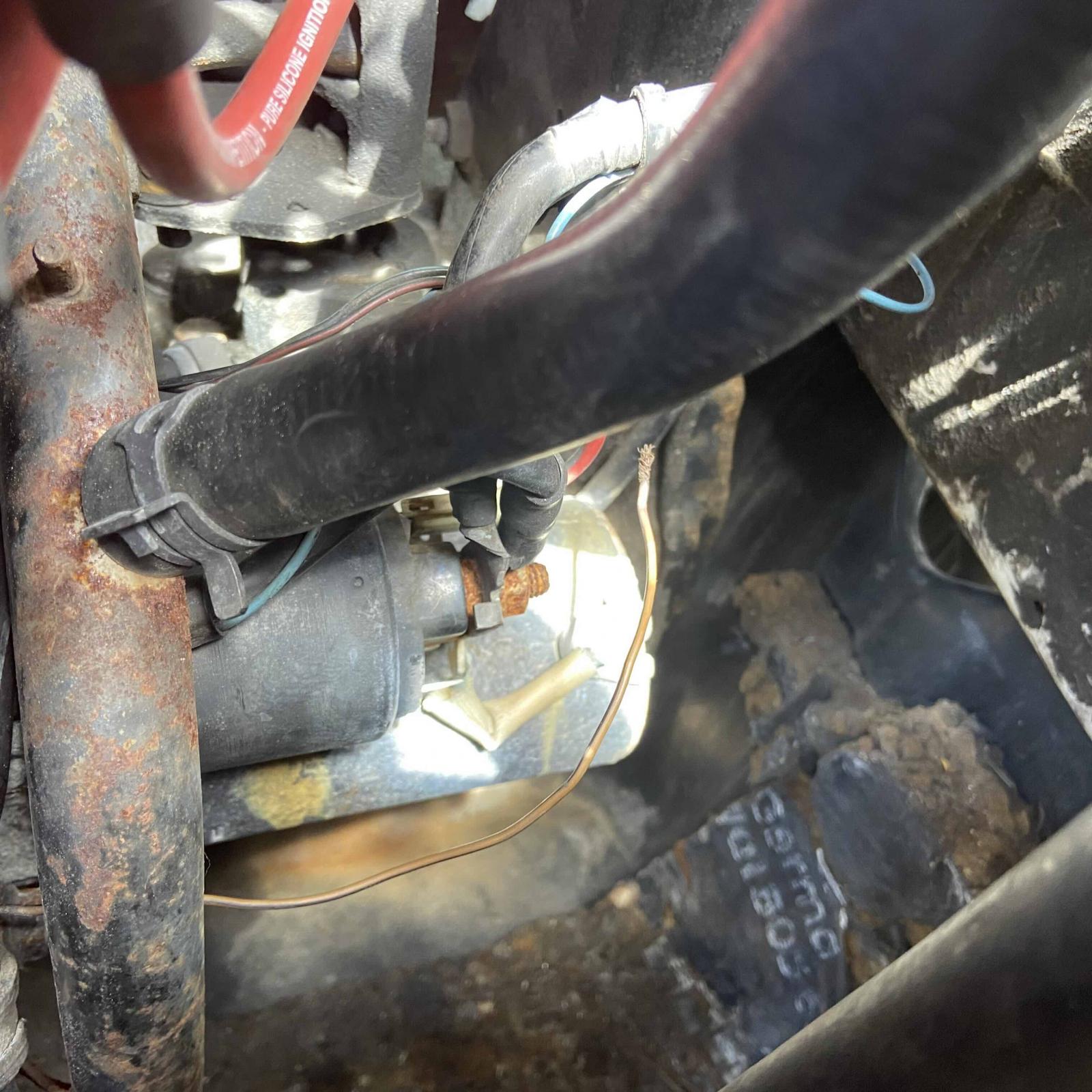

In the process of jumping the starter, I noticed a broken brown/black wire (18 gauge maybe). It is located near the starter solenoid.
Given its length, there are only so many places it can reach. But try as I may, I cannot locate where it was connected.
BTW, the other end of the wire goes into a wire harness so no idea where it ends up.
Looked at wiring diagram but there was no mention of a brown/black wire on the logical pages I at looked at (i.e., starter connections, etc).
Maybe some pictures will help.
Thoughts?

Update: Cleaned up the connection of the starter solenoid/battery and she fired right up. I live on the ocean the salt air play havoc to electrical connections.
So the van runs fine. But still have no idea what that brown/black goes and what it does (?).

In the engine bay, I see Brown/Black being use for:
Brake fluid level warning switch; C/3
Horn ground ending up at A1/8, through a 2 pin connector T2N/2

Thanks for the brake and horn wiring possibilities. I'll check.
