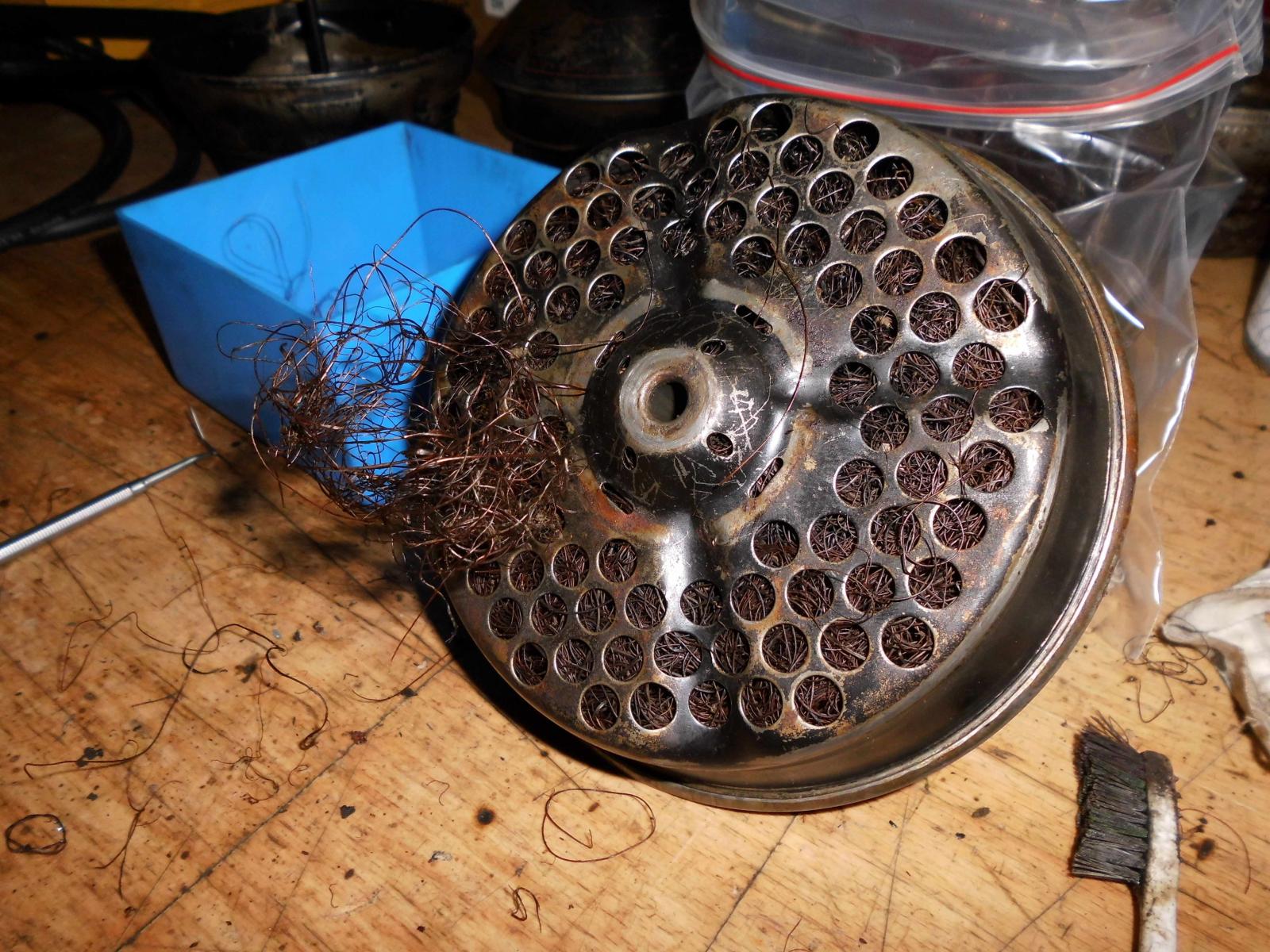

After the time-consuming ‘cargo-floor and outer-rocker’-topic, it’s time for a little change:
The aircleaner was outside in a dentfree-condition but inside rusty.
To have a good starting basis for the paintjob later on, it should also be sandblasted.
But having afterwards all the sand and dust inside the fiber-filter-material?
Better not. So, the fiber was completely removed through the numerous holes …
But which new material is suitable as a matching replacement?
Having a closer look inside our cleaning-agent-cabinet, my attention was driven to sponges which are normally used in the kitchen.
They are made from endless stainless-steel-spirals. It seems to be the perfect solution (but please don’t tell my wife Very Happy )
After the aircleaner was restored, the 3 sponges were threaded through one of the holes by using a wooden stick, tweezers and a dentist instrument.
I hope that this solution will also prove its worth in later operation ...

Hello Pandoras Box,
the removed cargo-floor-parts were already stored in my workshop Wink
After the bus-project will be finished, all the remaining parts will be offered at one of the VW swap-meets.
You have welded in old computer server cabinets and metal from a wrecked Tesla?!
I’m excited about your sustainable bus project! Very Happy
Many thanks.
_____________
benjamin

Hello Everett,
removing the old material and threading in the new material did not take so much time (approx. 40 minutes) Very Happy
More time-consuming was the subsequent pulling apart of the new material inside the air filter until the entire room was filled (approx. 45 minutes).
Many thanks.
_____________
benjamin

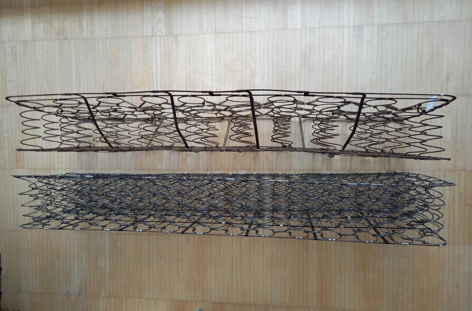

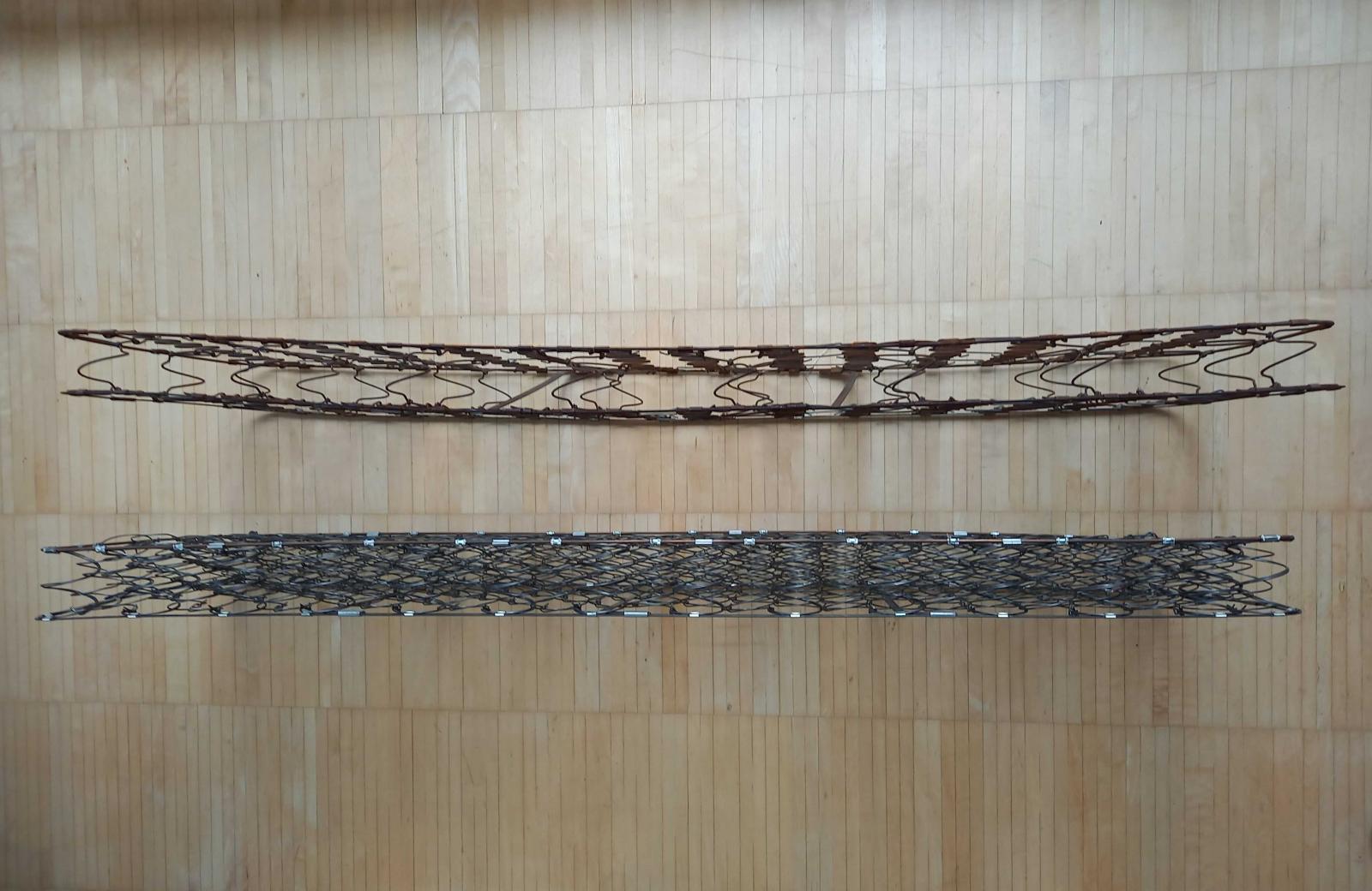

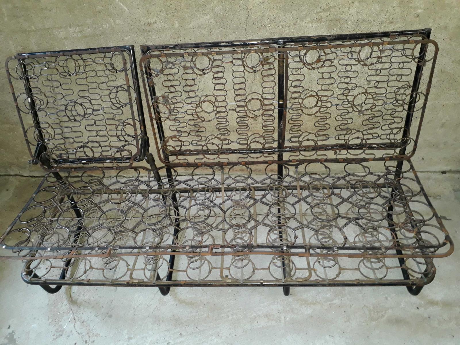

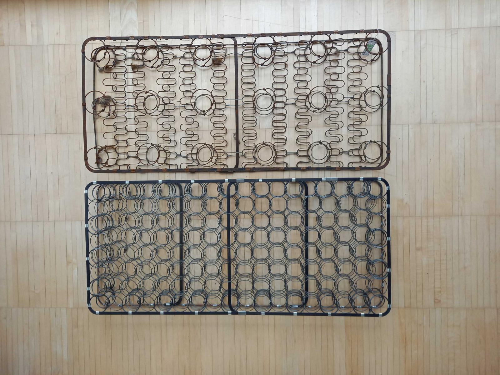

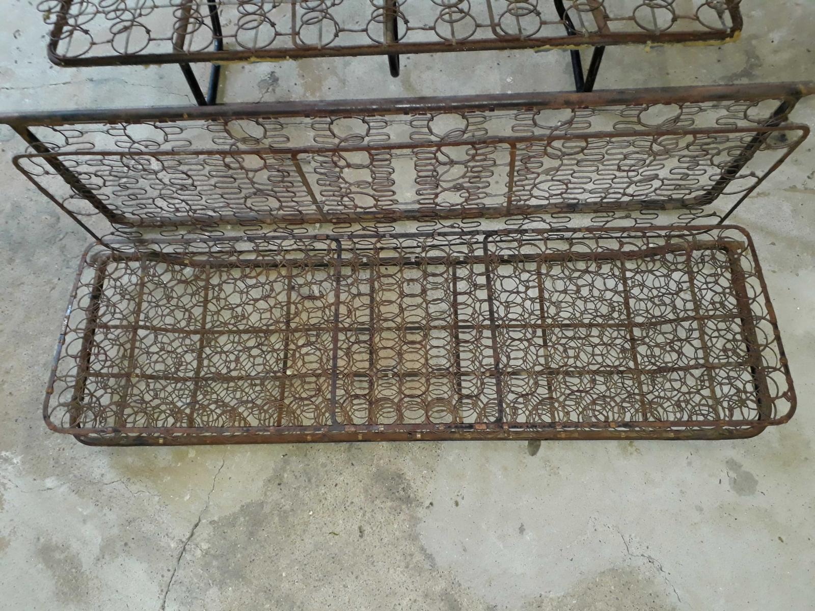

The next focus were the seat-benches:
The spring cores were worn out and too soft.
The upholsterer's work should start on a stable base.
I also don't want to sink in later due to my weight Very Happy
Fortunately, there is a reliable workshop in southern Germany that is specialized in reproducing innersprings.
Unfortunately, he is always very busy and it took about 1,5 years until he finished my order.
To be on the safe side, the guy put some extra springs into the front-seat-bench for the heavy driver Very Happy
Here are the comparison photos of the old and new seat-spring-cores:

PostPosted: Mon Jul 14, 2025 9:53 am    Post subject: Re: Nice bus, even nicer sister Reply with quote
My fat ass needs something like that

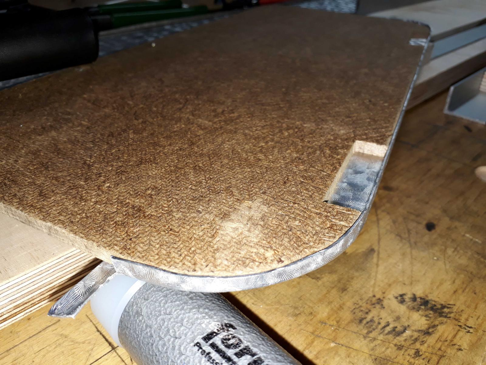

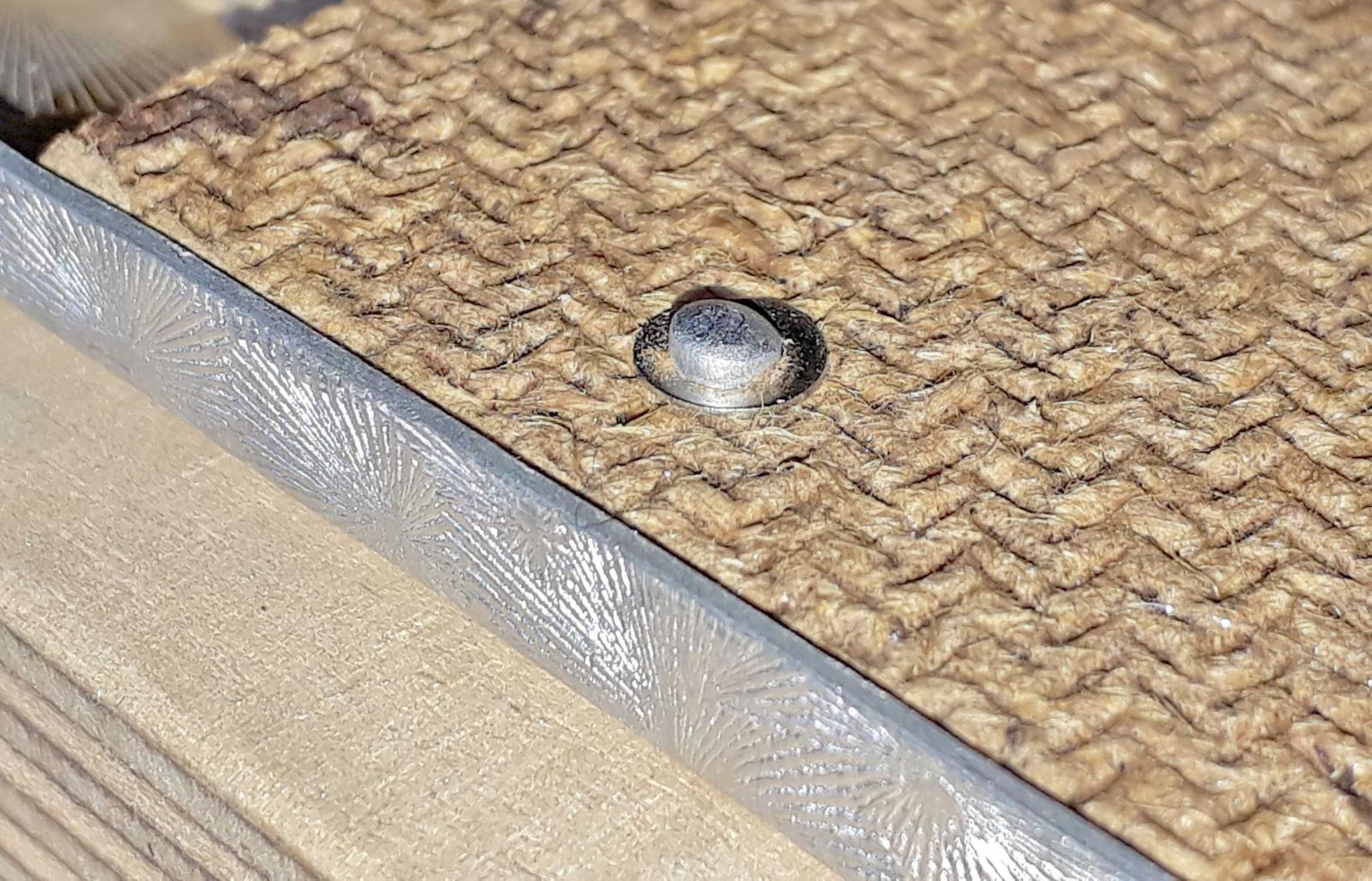

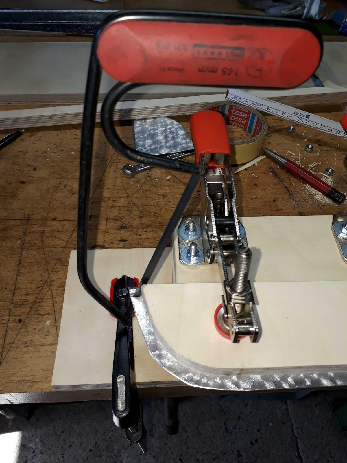

The following topic is one of the highlights of this project Very Happy
I never thought I would find NOS Snowflake-material for restoring the kickpanels.
But by a very lucky coincidence, the material was found at one of the largest classic car parts markets in Europe called Veterama in Mannheim Very Happy Very Happy
The old seller told me, that he got the sheet metal in the 70s / 80s when a VW-warehouse was cleaned out and closed.
He had no idea for what this sheet-metal was used, but he kept it over all the years because of its nice Snowflake-design.
Fortunately he just stored it very carefully Razz
Here is the comparison between the NOS-material (above) and the kickpanel-trim (below):

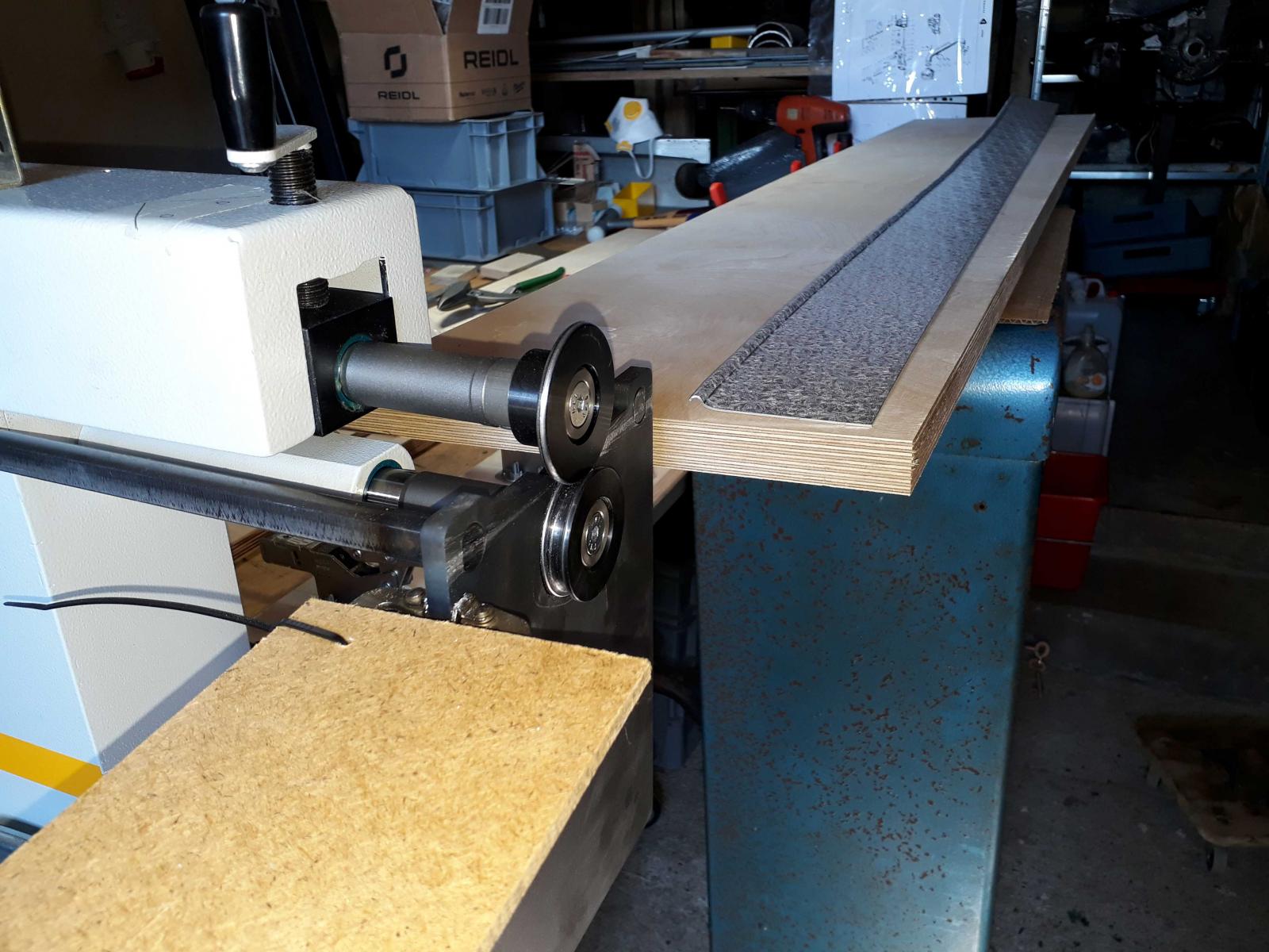

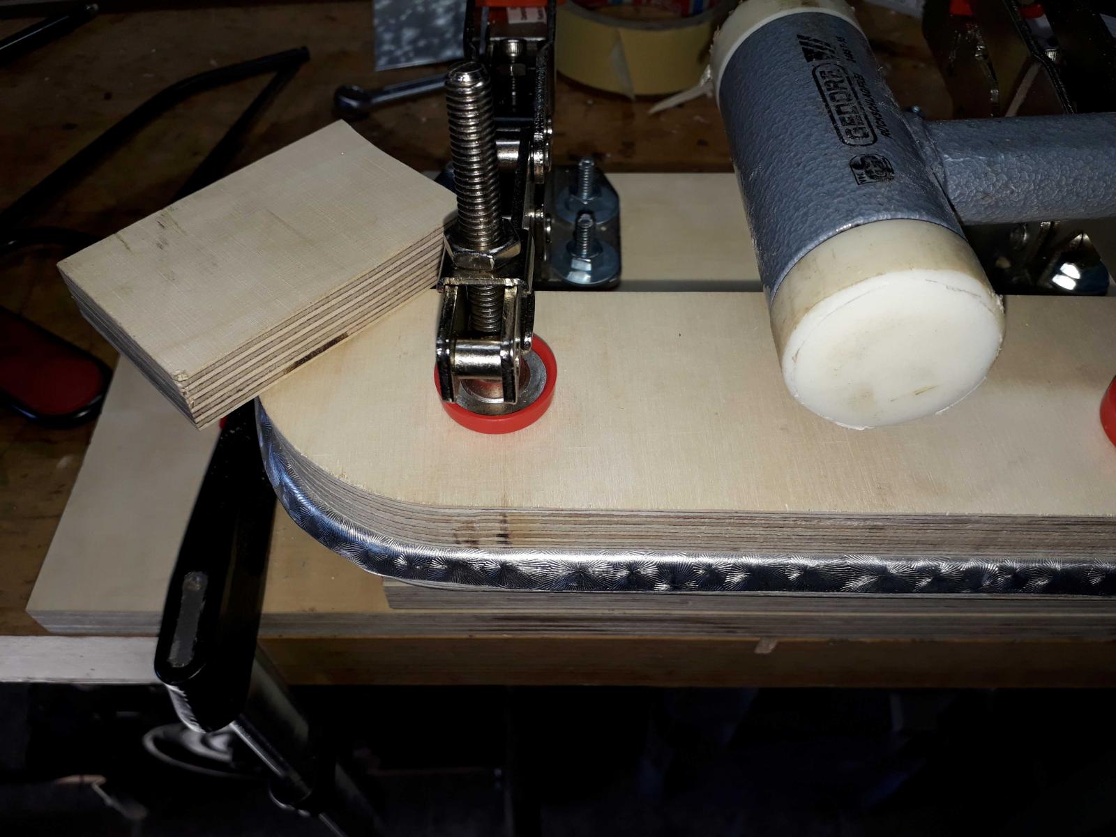

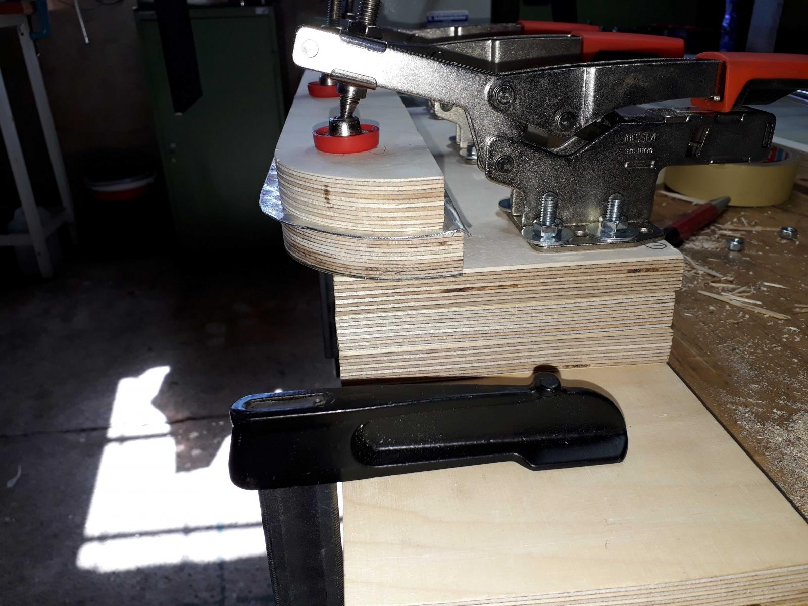

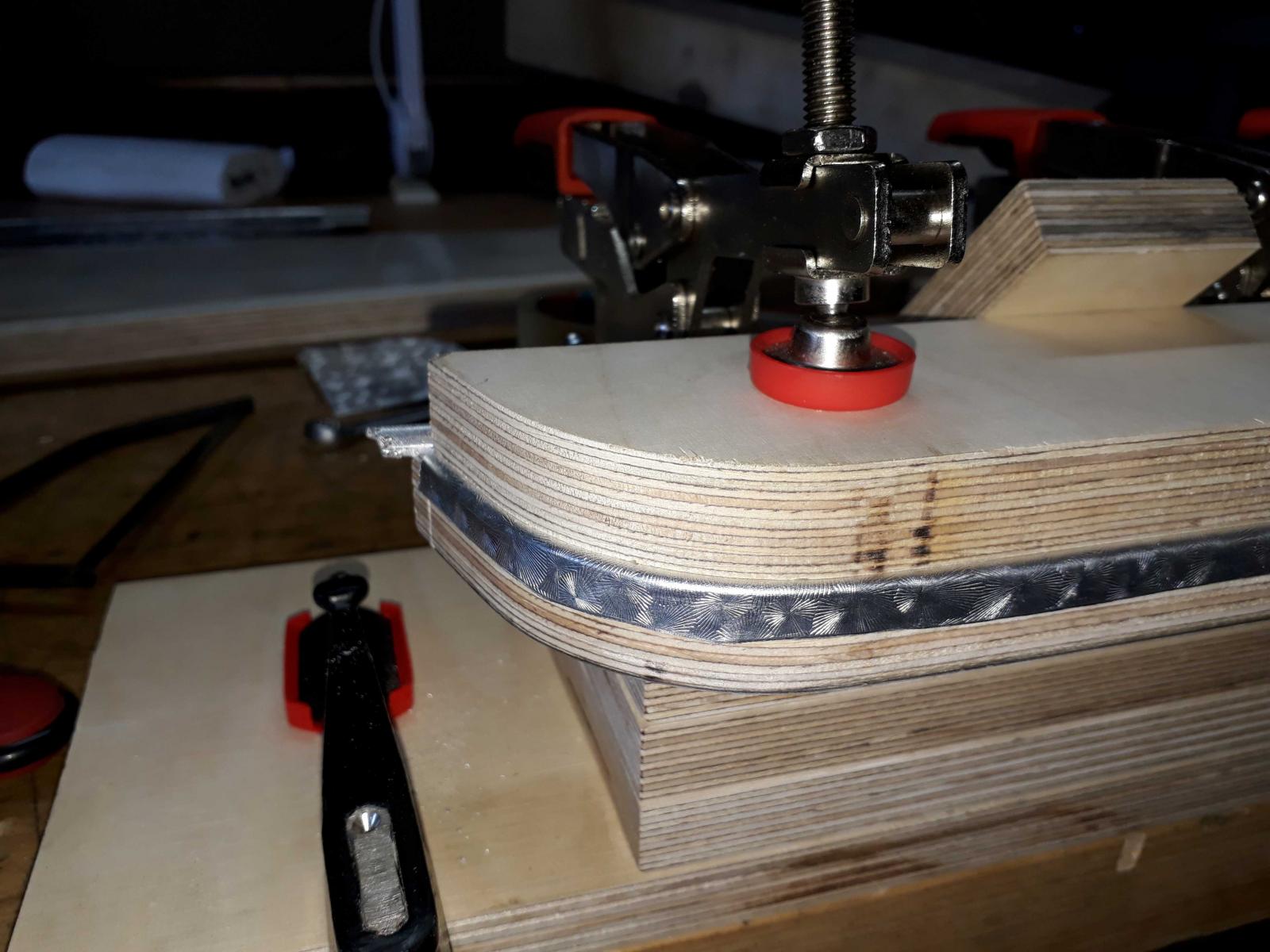

The challenge was to form the sheet metal into the correct and needed dimensions.
Numerous different attempts were made until the right solution was found.
First the longitudinal bead was made with the beading-machine …

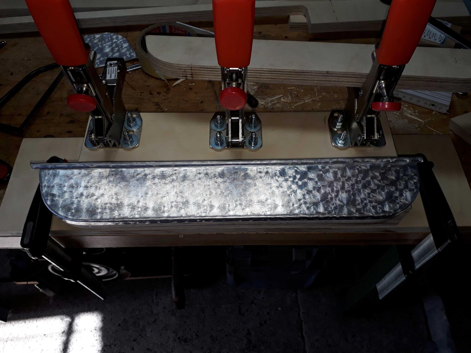

The prepared sheet metal was cut into the right form for the next step ...
To be able to craft the correct bending, a knocker-molding-form was created and built …
After about 700 … 800 hammer hits, the bending is finished completely …
The correct dimensions were controlled and the fit was checked on a kick-panel …
After that the riveting was done step by step …
… and the NOS Snowflake-trim is fixed …
The steps for preparing the long trim are identical but more time-consuming due to the larger dimensions Very Happy

PostPosted: Wed Jul 16, 2025 3:23 pm    Post subject: Re: Nice bus, even nicer sister Reply with quote
Talk about pucker factor on the kick panel. Very nice work. I bet your in-box is filling up with others wanting one...

PostPosted: Sun Jul 20, 2025 3:02 am    Post subject: Re: Nice bus, even nicer sister Reply with quote
Hello Matthew,
many thanks for your kind words Very Happy
Fortunately, there are still a few short and long Snowflake sheets left Razz

PostPosted: Sun Jul 20, 2025 3:11 am    Post subject: Re: Nice bus, even nicer sister Reply with quote
To complete the Snowflake-topic, here are also the details about the long Snowflake trim for the rear-seat-bench kickpanel …
A further knocker-molding-form was built to get the identical measurements of the original long trim.
I have to admit, that manufacturing the short trim is much more comfortable because of the smaller dimensions Smile

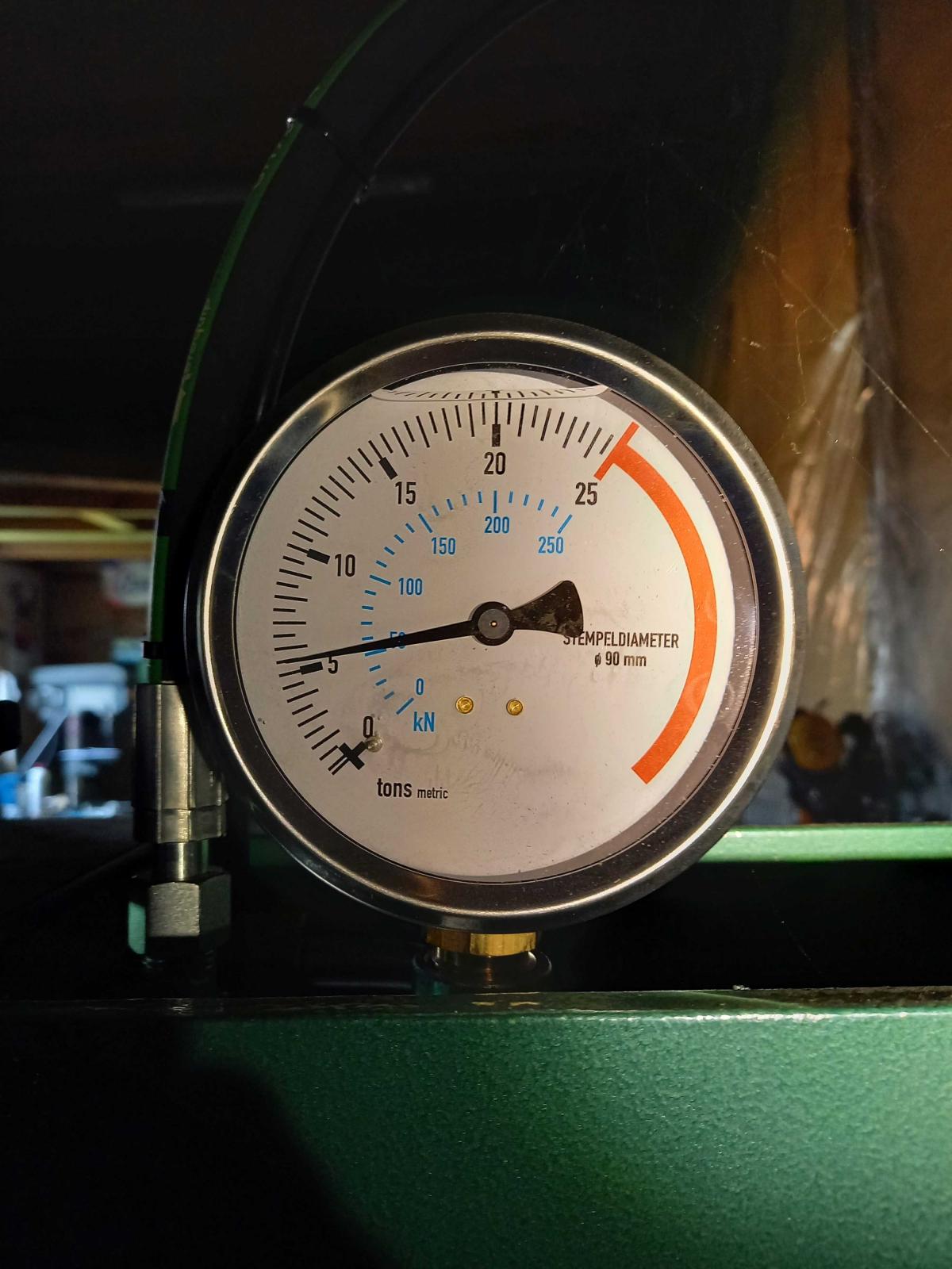

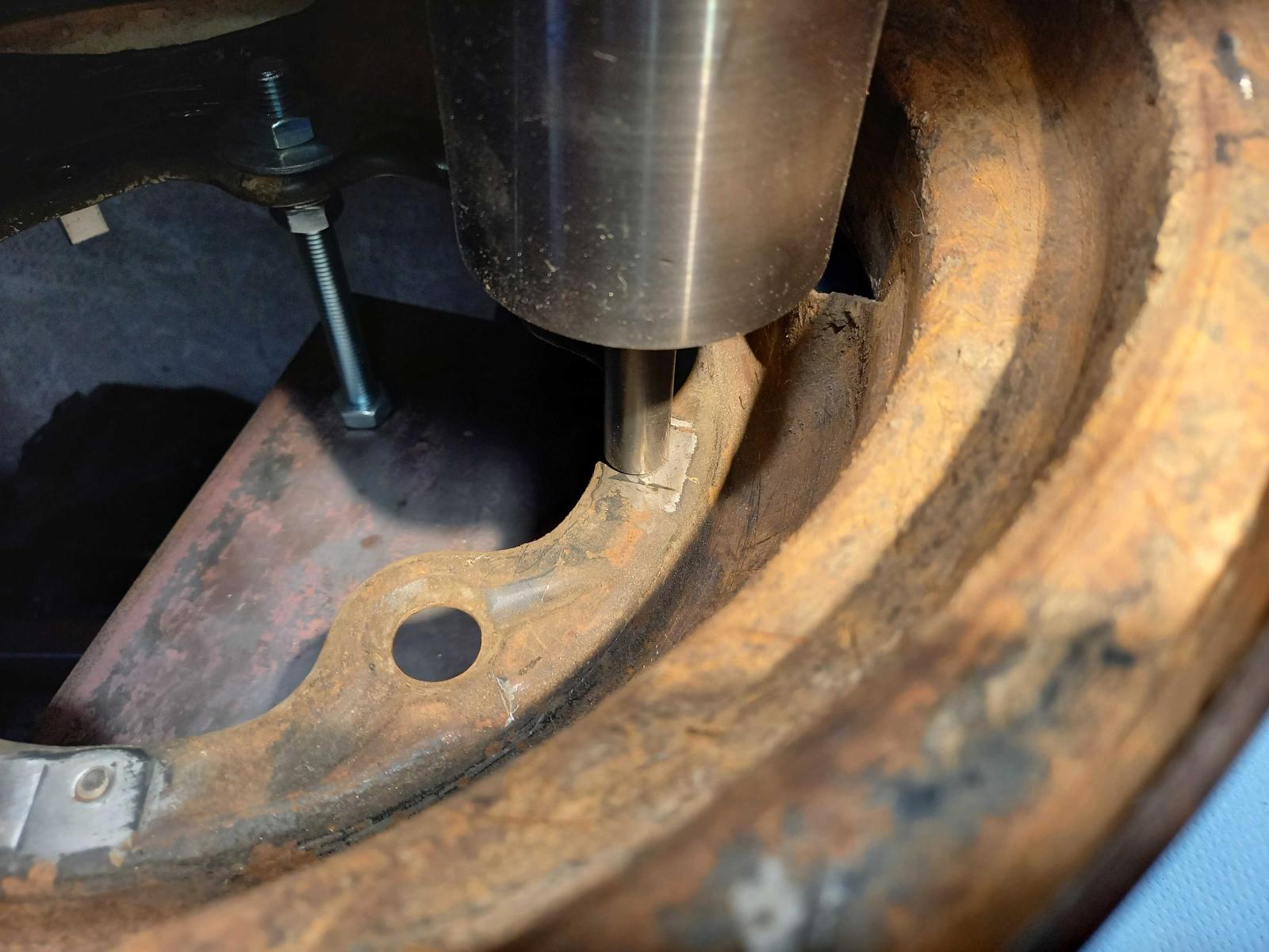

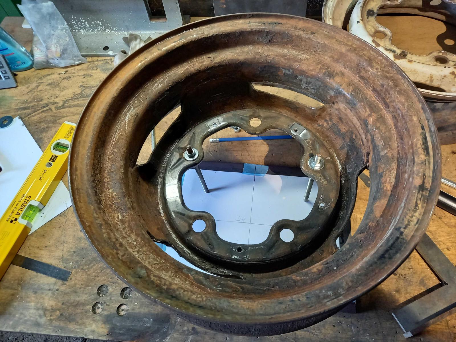

The next job: The 5 rims and the clips for the hub-caps.
Some clips were still original but bent, some were broken off and some were exchanged in the past to reproduction ones.
For an uniform appearance, all clips should be replaced.
That means to do the riveting process 25 times Confused
My first attempts with the riveting tool and a hammer were unsuccessful due to my weak arms Very Happy
So a rim-holder was designed that the riveting could be done by using a workshop press.
The basis: 15mm thick steel-plate / threaded rods M14.
The original clips (left) have the little upgoing tail which is missing at the reproduction versions (middle).
After a long search reproduction-clips with the little upgoing tail like the original ones were found (right).
Because of this tail the riveting tool had to be sanded down slightly.
After that it was welded onto the plate.
The workshop-press made a good job: After 5,5 tons and the rivet was smooth Very Happy
Just 3 clips were installed to test the riveting-process and the fitting of the hubcap.
After that the rivets and clips were removed. The rims will be given now to a sandblaster …
