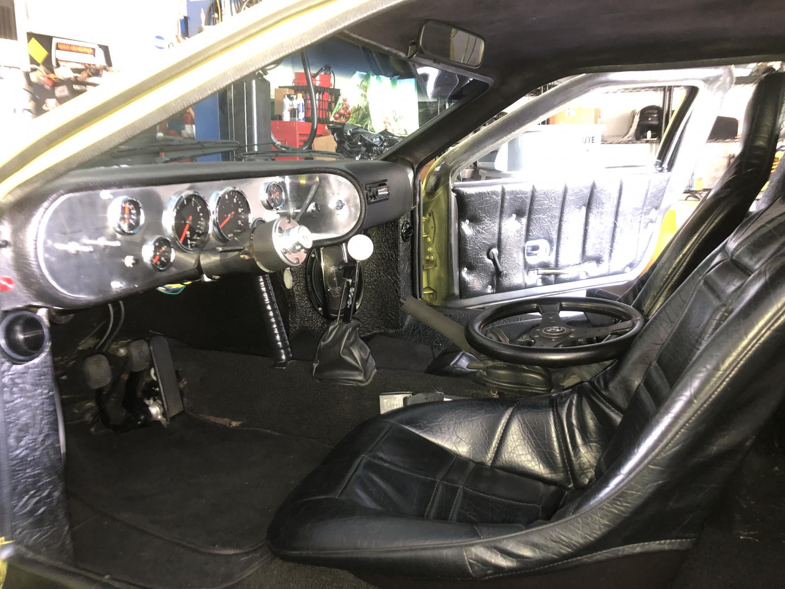

In trenton area. The big boy pedal kit is no help. I need to space the clutch pedal from the accelerator too. I just finished that work. I carefully added a dogleg bend to move the brake pedal over 3/4" and the clutch pedal 1/2" over from the brake pedal.
Additionally, I'm going to add a 1/2" wedged platform to the gas pedal to change its angle, closer to the driver and the top.

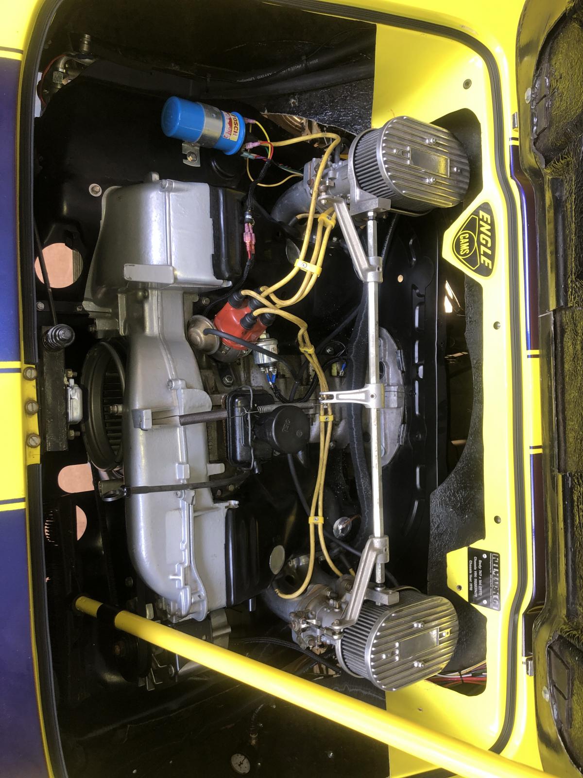

Something doesn't look quite right with the engine. The plug wires aren't going down through the holes in the top tins where they should be. Instead they are going into the side of the tins by the intakes like a Beetle engine. What is going on there? At the very least the stock plug holes need to be covered over to stop the cooling air from leaking out.

There just was a $100 pair of C4 corvette seats on CL. They were there yesterday, seem to be gone. Their unique fixed back seats. I think there’s Saub sonnet seats in Jersey for sale. Similar to 914.

The spark plugs are in different locations for the 1.7/1.8L vs the 2.0L ve-Porsche engine --- so the cooling pieces have the spark lugs in different places. (Some replacements head us the different plug holes too). You should remove those tines and have metal pieces welded to fill in the extra holes --- same for the rear engine tine which looks to be from a T1 (VW Bug).
Porsche 914 seats would look great in it. They have low tracks and tilt too (and are only about 18" wide so clear the VW pan.)
I have only owned it a few weeks. I haven't looked into it. The engine is def. a 73 2.0 914 engine though. Plug wire routing isn't high on the radar yet.
Ah! That explains it! It's a 914 engine with Bus top cooling tins then! Four squares of duct tape or better yet aluminum tape would be a good quick fix.

Brakes fixed, bled, emergency cables rerouted, new master hoses, rebuilt wider spaced pedals, roller gas pedal installed, stereo installed, stock seats refoamed, wiring cleaned up s as nd wrapped, dash support installed, AC vented secured, APillar door hinges strengthened ( no sag) window outer felts installed, QD steering hub installed, exhaust leak fixed at #3 port misaligned o-ring gasket and pipe angle corrected (custom 1 off exhaust).

I got one on a 1970 pan, the pan has the pan floor halves lowered. Type I 2180 engine
Mine has Honda delSol seats. these seats work well and are sporty looking.
