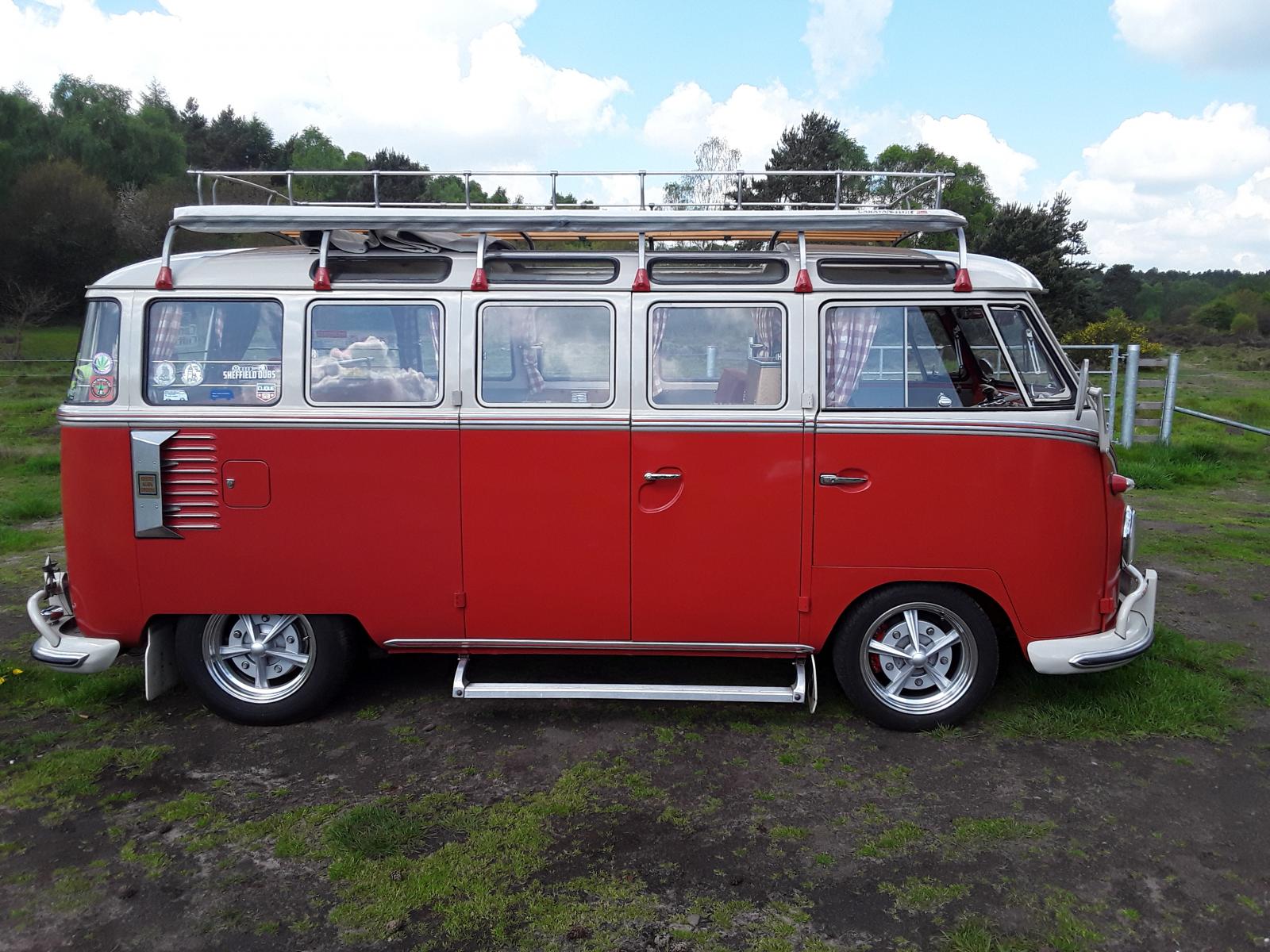

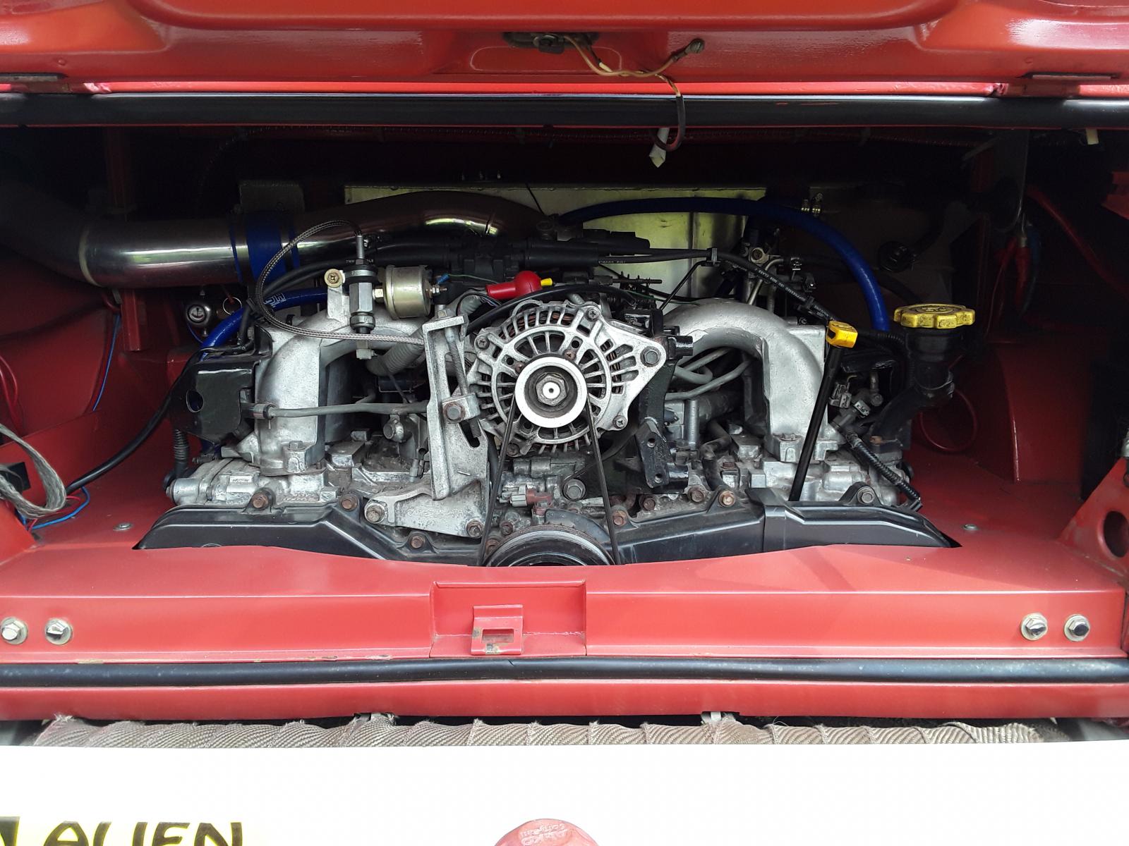

Hi kTPhil yes I have an auto split that I've owned over 20 years now, my dad and me worked on it and did the conversion to auto as I have a disability and the powers that be say Im only allowed to drive automatics hence the conversion, it had an air cooled 1600 but it was way underpowered for the auto box and had to be driven flat out all the time to keep up with other manual splits when in convoy, later on it got a 2lt Subaru engine fitted which suited the automatic box much better because being driven flat out the kick down was always kicking in and reving the nuts of the engine now that never happens the peadle never needs to be pushed that far down any more, I had the gear box rebuilt but once installed it would slip slightly in 2nd so I sent it back and they installed extra clutches in the clutch pack but after installing it again it wasn't much better but as you know 2nd gear only runs from about 15 mph to 30 mph so I just had to put up with that it never got any worse and it been fine up until the last couple of years until the leaking pan, it's a shame to have it and not be able to drive it so hopefully we can figure it out .
Here's the bus I hope you like it cheers Phil

PostPosted: Thu Jul 17, 2025 12:49 pm    Post subject: Re: Automatic pan leaks Reply with quote
Amazing Bus in every respect! Wow!
Once you get past your immediate leak issues, please share more photos of the install. Non-trivial, to say the least, and it looks so clean.
Glad you get to keep on Busing with this unicorn!
