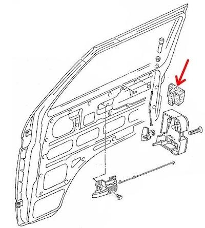

Foam piece near the lock
There is a foam piece that seems to go above the door lock area. What is this piece for, and how is it supposed to be mounted (glue)?

Bulli Klinik
Joined: January 16, 2005
Posts: 2208
Bulli Klinik is offline
PostPosted: Mon Jul 21, 2025 5:59 pm    Post subject: Re: Front door questions - vapour barrier, alignment and foam piece Reply with quote
Let’s see a pic of that foam wedge. It’s been a while since I removed mine and forgot where it goes.
