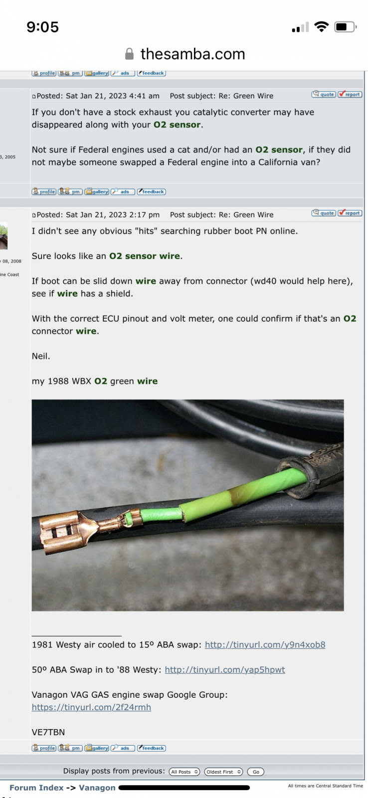

Also, since you have a meter, check for infinite resistance between the center wire on the O2 sensor wire, body harness side, with your O2 sensor disconnected.
You're probably NOT experiencing this, but it's so easy to check with your Meter, and you learn something about your Fuel System as well.
Put your Meter on Ohms, one probe/wire attached to the flat pin of the O2 sensor body harness side, and the black meter wire on a really good ground in the engine compartment.
We are checking to make sure no shield wire connection between the center, inner most signal wire that is connected to the O2 sensor, and the braided shield wire you can't easily see, that's wrapped around the inner wire to shield it from inductive signals or interference. So, a Coax cable in other words.
They can't make a connection, if they do, the ECU signal is grounded out and your engine runs rich. Can start as an intermittent issue , so it's one easy thing to check with your meter. So, ideally you see Open Circuit or something like a million ohms on your meter reading when checking.
There are threads here on Samba about the last inch or so of the braided wire strands getting work hardened, and piercing the insulation of the inner signal wire, making that stupid short to ground that we don't want.
See the picture below, you can just see the braided section surrounding the inner signal wire, damn strands poke inward and you're screwed until you trim back a small amount of wire in the braided section and stop the short/connection
