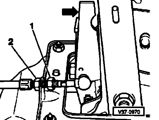

PostPosted: Mon Jul 28, 2025 2:20 am    Post subject: Re: key stuck in ignition (2003 Eurovan) Reply with quote
    Shift selector lever into "P" position and turn ignition key to end position (ignition off).
    Loosen locking cable nuts -1- and -2- at frame.
    Push locking lever (arrow) until it touches selector lever.
    Secure locking cable in this position on frame.
    Operation of the ignition key withdrawal lock must be checked.

PostPosted: Mon Jul 28, 2025 8:15 am    Post subject: Re: key stuck in ignition (2003 Eurovan) Reply with quote
Sweet! Thank you @trunnion
