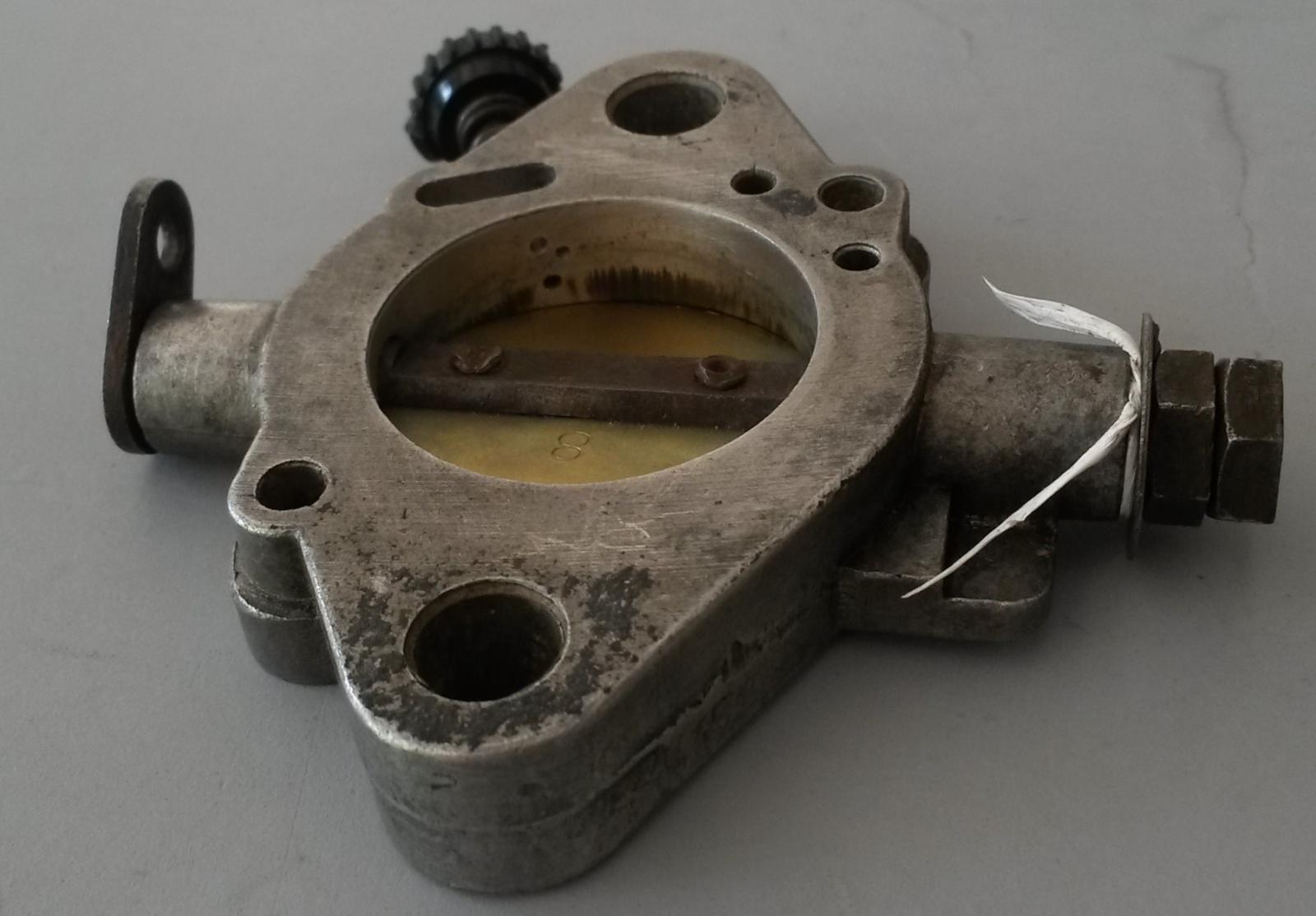

Time to eat some crow! You guys nailed it, we had a leak right at the head! Not a big one and you had to squirt the starter fluid at just the right spot. Turns out the ears on the left side were tweaked down. Overtightened at some point I suspect. A half hour with a flat file and sandpaper on glass put it right.
Not running perfect but he went home with a huge poop eating grin. "It's never run this good!"
The idle is dependable at 900 RPM, anything less gets too ragged for my liking. It still has a small stumble between 900 and 1200 RPM, more on that later. It now pulls smooth and strong (for a 1600 DP) right from 1200 to 4500 RPM. Before it idled at 2000 and went flat just after 3000 RPM.
I think the reason it idled with the Chinese carb was twofold. 1) it was idling way too high and 2) it was set pig rich.
As for the remaining higher idle and flat spot, I think it's a combination of the 1 1/2" cannons and lightly worn throttle shaft bushings. I can feel a tiny bit of play there and starting fluid right at the ends does change the sound of the engine a tiny bit. Actually this is the best I have ever had a dual cannon engine run!

oprn wrote:
... lightly worn throttle shaft bushings ...
Fairly quick and easy fix: Teflon tape
I wrap as many windings as will fit (at least 2), and tie the ends into a knot, preferably around an attach'd lever arm. It's surprising how well this stops leaks, makes throttle shaft rotate smoothly, and lasts longer than I ever imagined it would; decades!

MrGoodtunes wrote:
Interesting!
