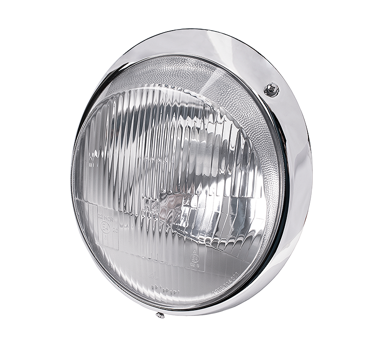

Instead of finding early Beetle headlamp assemblies, consider Euro-style Porsche 911 from the '70's. The glass lens (repros might be plastic) protrudes more along the top.

I have set of the 911 glass lenses and I do plan to use them. It currently has an earlier gas tank to be filled inside. That's great info about the 72 changes. I have learned that the earlier dash pad does not fit because the air vents are massive on my 71. I was planning on wiring the signals into the parking lights inside the headlight buckets.
