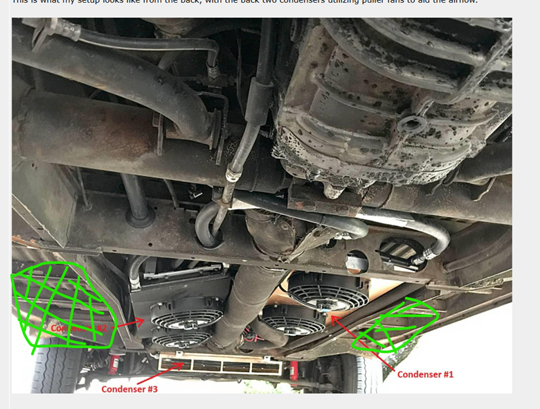

69BahamaYellow wrote:
Using 69BahamaYellow's picture, since I don't have mine at the moment.
Any issue mounting radiators on the sides - marked in green? Reduced airflow or same?
Also, is it better to mount radiator with inlet/outlet facing up or down? (radiator fins lower than the inlet/outlet vs. radiator fins higher than the inlet/outlet respectively)
Thanks in advance.

PostPosted: Sun Aug 03, 2025 2:10 pm    Post subject: Re: Need Your Help- Underbelly Radiator Design Reply with quote
if you want rocks and road debris from the tires to hit them, then it would be a great place to mount them

PostPosted: Sun Aug 03, 2025 2:44 pm    Post subject: Re: Need Your Help- Underbelly Radiator Design Reply with quote
Noted
