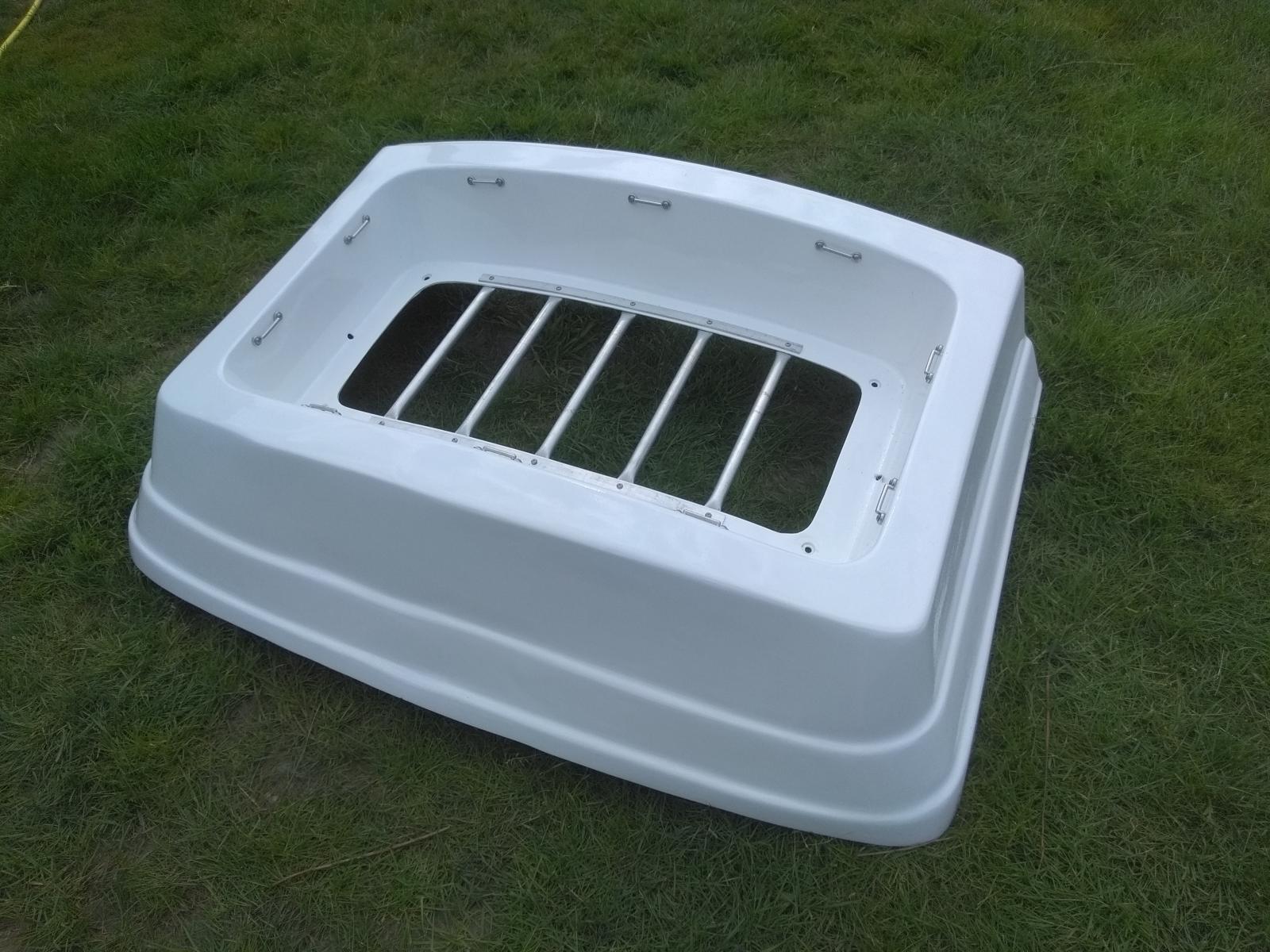

Since i could not find proper replacement rollers for the X frames i decided to make my own.
Last week i got my first prototype.

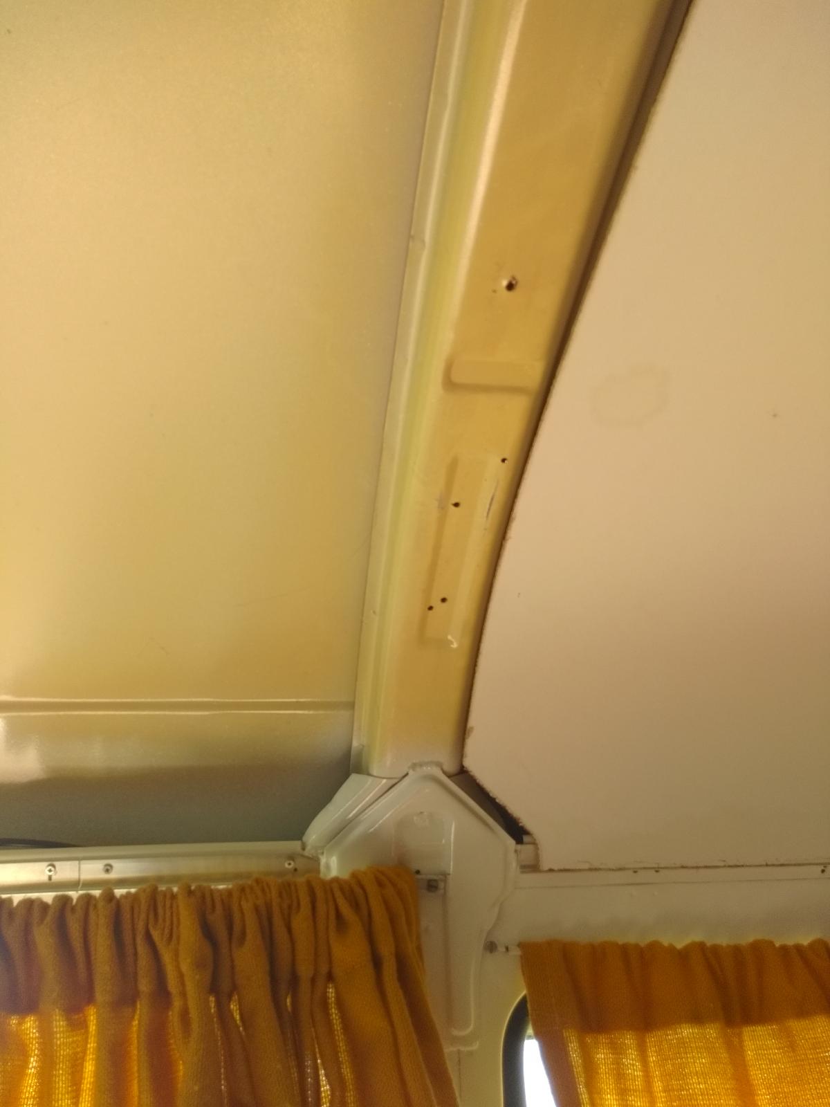

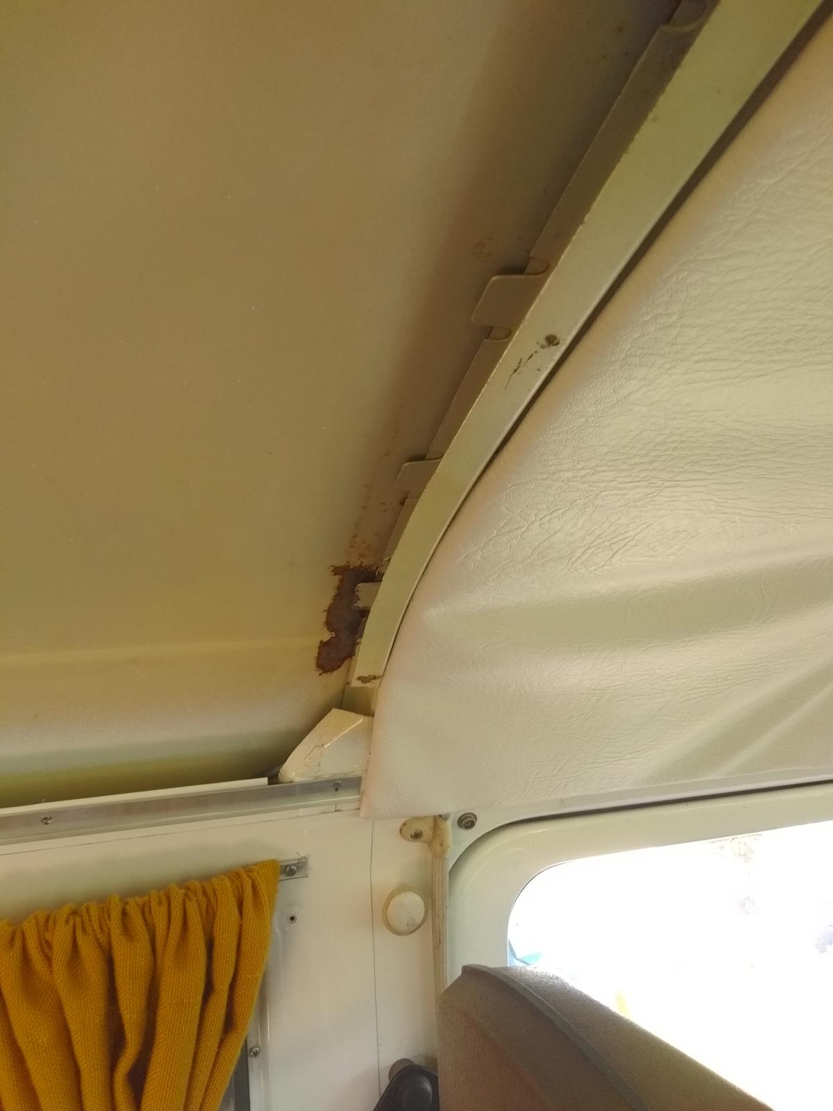

Getting closer and closer to cutting the hole in the roof, i removed the headliner in the bus to have a look at what is there.
As you can see there are two roof supports, as far as i know the pieces of wood have to be mounted against the supports after cutting the hole.
But as you can see the wooden pieces are not usable so i'm gonna make new ones, but does anybody know if these are supposed to be the same length?
Any pictures of how it should look would be very appreciated ☺️

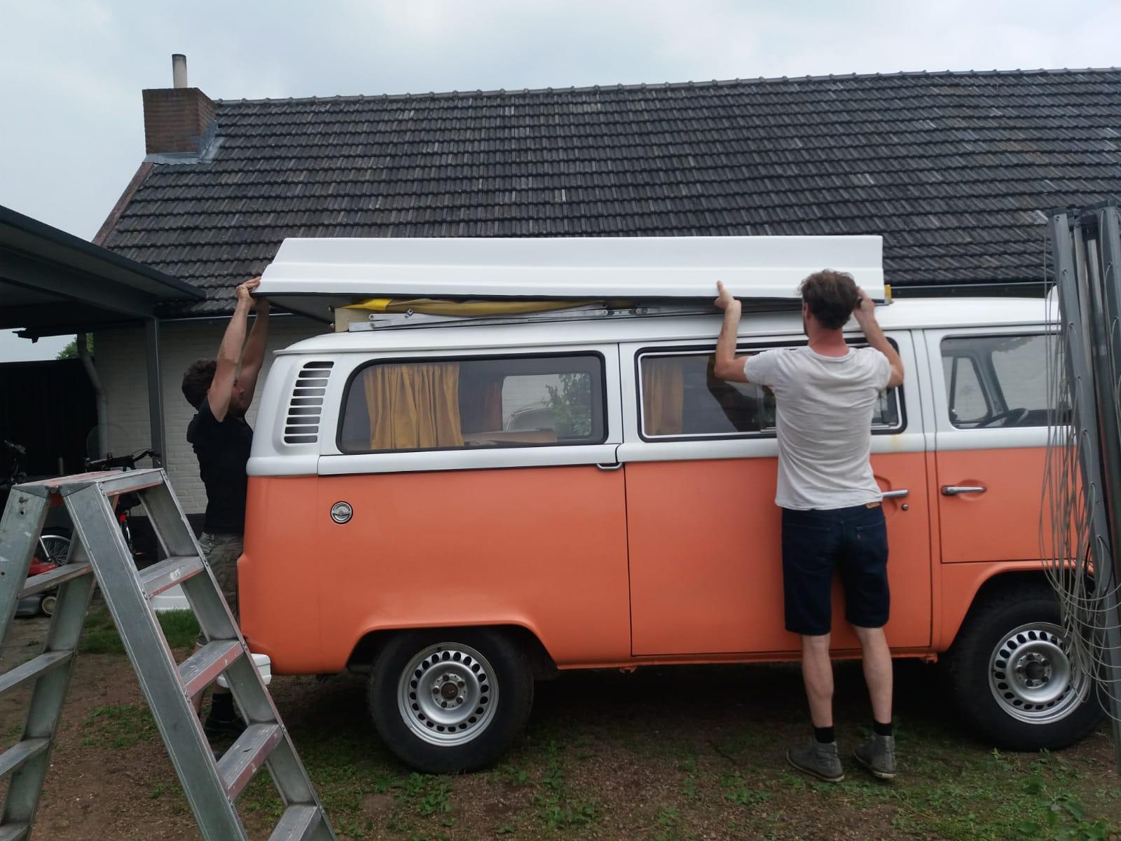

PostPosted: Mon Jun 18, 2018 12:54 pm    Post subject: Re: Riviera roof install on tintop Reply with quote

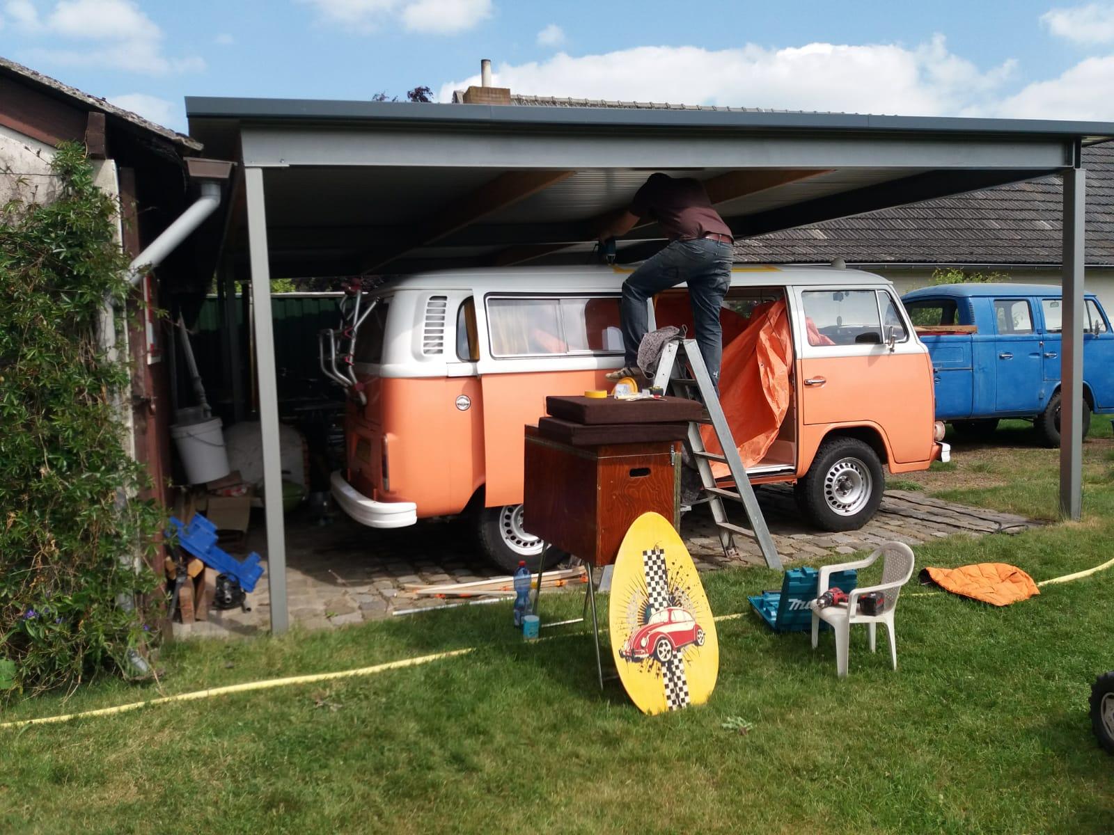

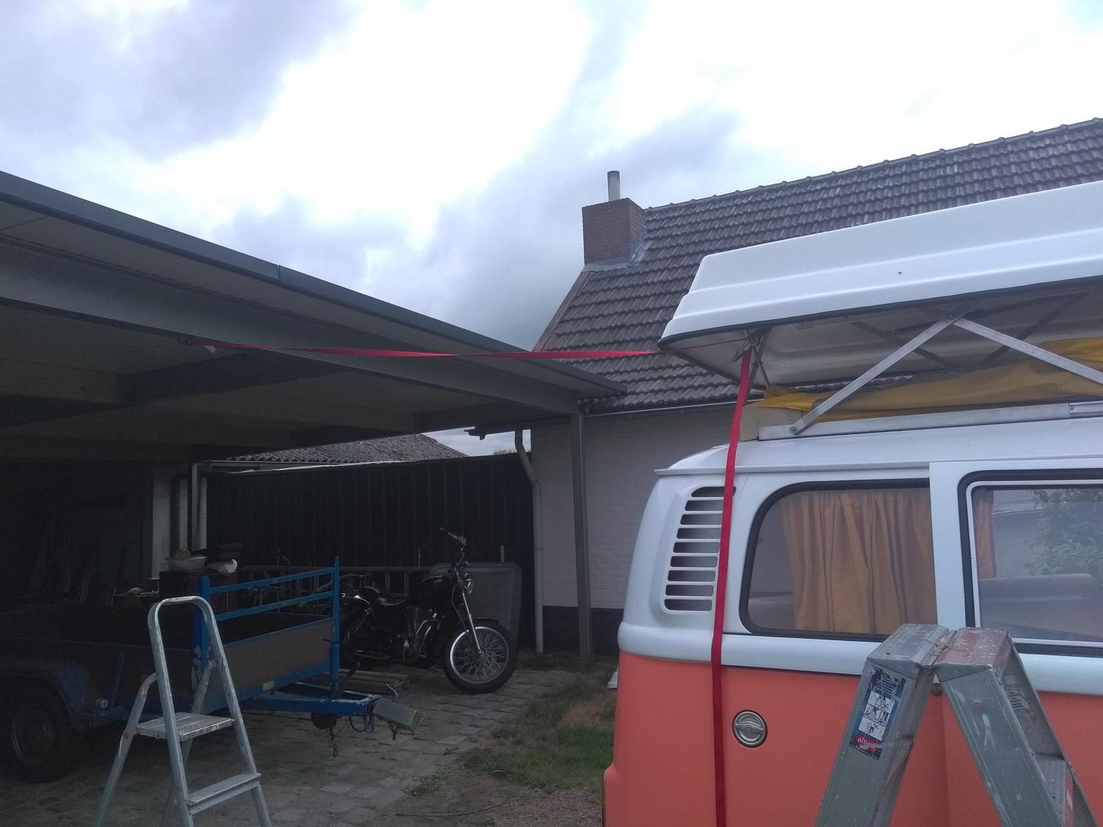

It's been a while so time for an update.
Finally, cutting the roof!
Placing the wooden pieces
Installing the springs
That's about where i'm at right now.
Next job is to install the luggage rack.

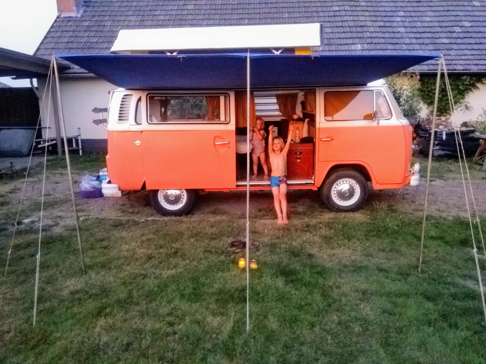

Anyway, after i've installed the top we've had a couple nice camping trips with the family.
The top is really a great addition to our bus, since our 11 year old can sleep up top and our 8 year old can sleep in the hammock above the front seats. ( This will probably be the last year she fits in there)
Here are some pictures of the bus at a couple camping trips
Backyard camping
A very nice campground not to far from our home
And this is from our campingtrip to Germany, actually still at this campsite as i'm writing this
