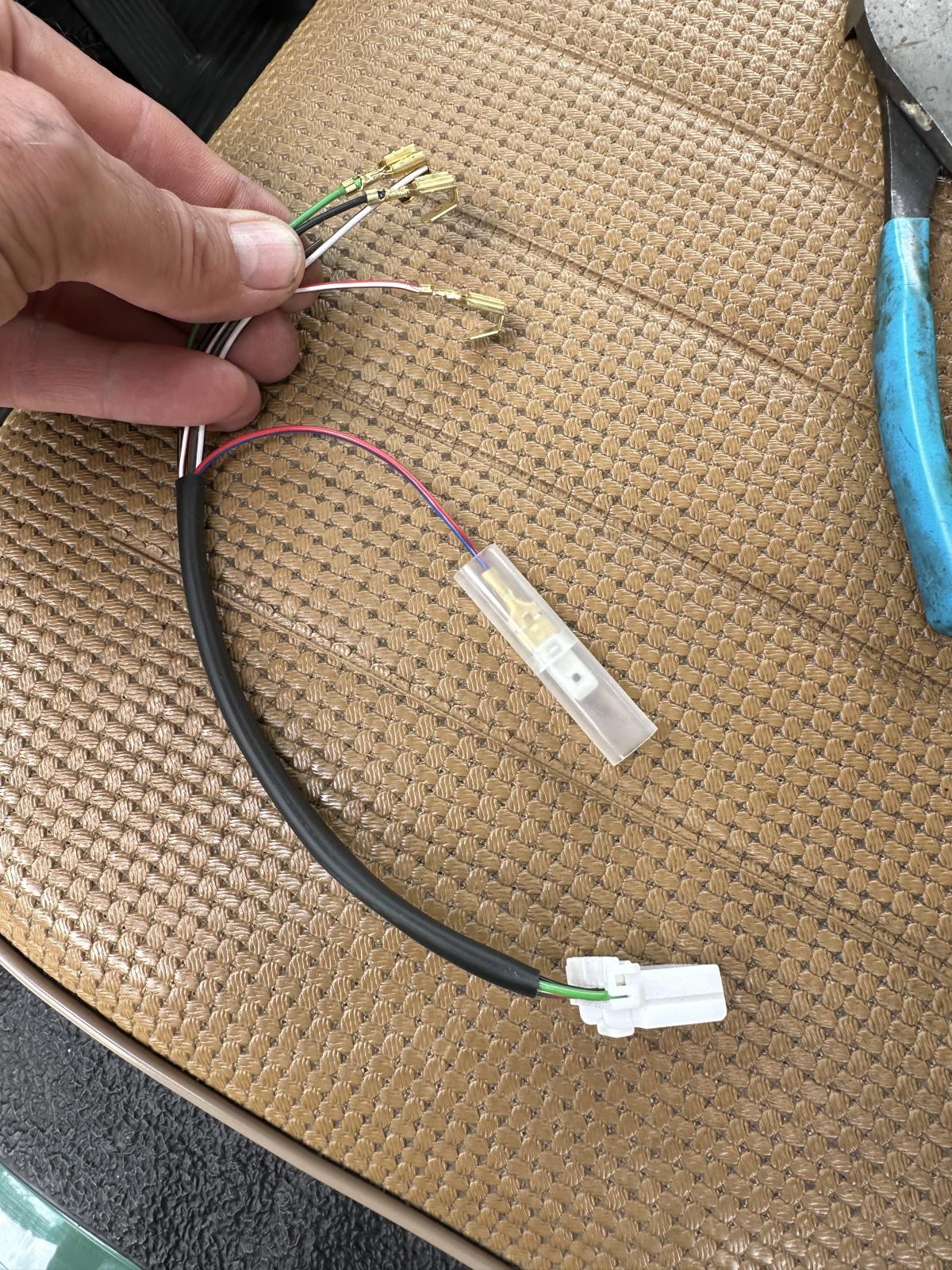

My Smiths unit tracks smoothly. I have a Shockwave distributor and didn't install a diode. I used piggy back style connectors so I didn't need to cut or splice any wires.
