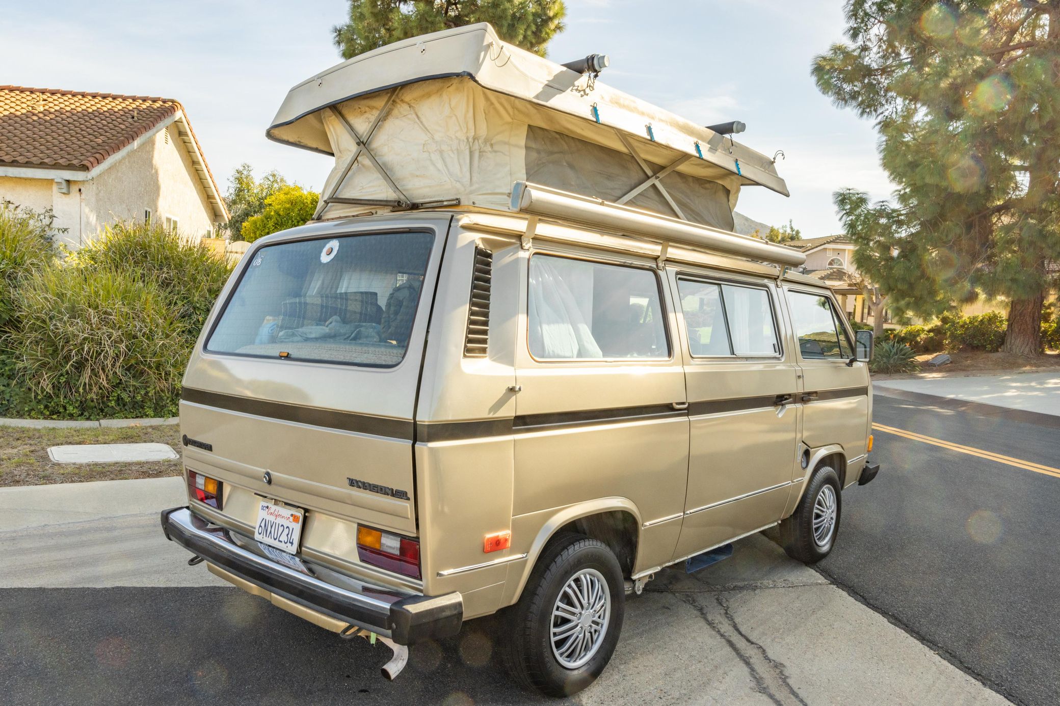

Probably a dumb and lazy question, but I'll put it out anyways. The wedge shape pop top roof on the Westy really cuts down on the upper bed length if you have adult size feet.
Anyone seen a way to make the rear section of roof lift higher, or pivot the roof 90 degrees instead of wedge shape, or make the roof lift straight up?? Ive seen those options on bay windows, I don't think Ive ever seen one on a vanagon.
Just curious.

You're aware that the canvas needs to be extended, right? I don't see why you couldn't create new brackets or a linkage extension to raise the top more. The hard part is creating a custom canvas top in my opinion.

On the rare occasion I use the top bunk I put my head toward the rear of the van. That way my pillows don't fall onto the floor and my feet have plenty of room height-wise and also are free to dangle off the the front edge of the bunk to adjust for my "tallness".
Just curious.
a friend made a bed extender for my van (Weekender), a plywood box with one foot on it to keep it level on the weekender sides. It does make slipping downstairs nearly impossible, but one can vary the length.
If I find it while packing tomorrow, I can share a pic.
You have no issues with hot head syndrome jammed down there? Or banging your forehead sitting up(probably do it once and never again)?
I like that simplicity, I wonder if it could be "L" shaped to allow a little access down below.
Found this on the google machine. I think the bed extender maybe a better option that a new roof project...

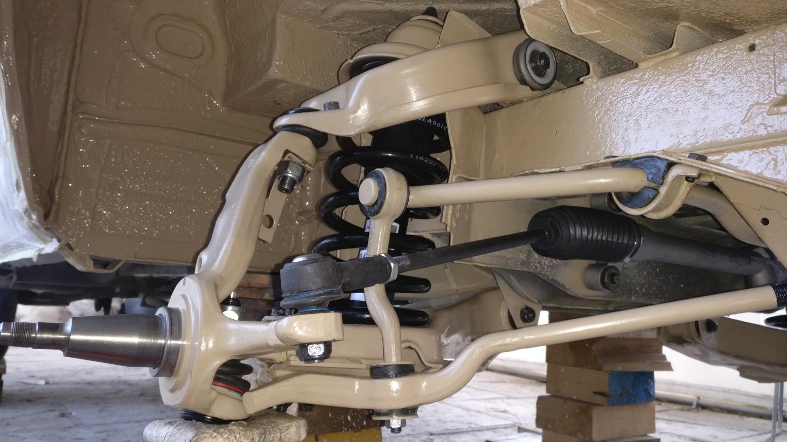

PostPosted: Tue Aug 05, 2025 10:41 am    Post subject: Re: Official lazy person's stupid question thread Reply with quote
Hello All!
this may not fall under a stupid question but it is a question none of the less!
does anyone know or understand why the early Vanagon Models had a curved sway bar end link and late models had an upright sway bar end link.
I have only ever looked at newer vanagons with the straight end links and am not sure what would have caused the need for a curved end link. Just a question to satisfy my curiosity on this subject.
- Noah

TheVW_twin wrote:
Hello All!
- Noah
Because the steering knuckles are different early to late Vanagon. Straight endlinks foul the steering link on an early Vanagon.
Early:
Late:
