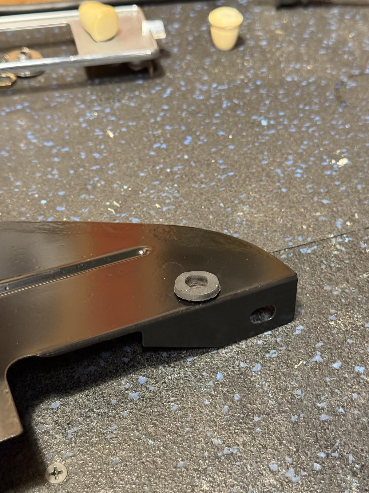

What are these little black grommets?
Original paint on top? Can you get new mat insets?
Final question…why two diff colored knobs?

nice find Applause Hazet Assistent 162 from around 1961-1965...
I'm not sure... many new photos cannot be trusted as they may show incorrectly repainted carts - older photos are not available in sufficient quality and/or color.
earlier models like my 160 from 1954 have RAL* 9006 white aluminum (almost a fine metallic paint without visible glitter pieces),
later models like my 166 TS from around 1970 use RAL 7001 silver gray (not a metallic paint despite the silver in the name, just a light gray).
Models later than 1979 switch to simple black.
What does the upper deck look like from underneath? Perhaps you'll find the original paint there more easily than above...
* RAL = an European/German standard for color codes since 1927.
HAZET part#: 160-012
EAN: 4000896004263
https://web.hazet.de/ersatzteil-shop/product_info.php?products_id=896004263
However, I'd recommend cleaning the good old one instead — it looks like the new ones shrink and warp over time.
Or buy inexpensive, textured rubber mats sold by the meter/feet.
The blue twist knob is normally above the steerable rollers...
This way you know more quickly which side you have to reach for when turning/pushing/pulling the cart.
First model 160 in 1954 had only black knobs - and also the models past 1979 as 162N and 166N, 166C...

Upper deck w mat to the side
if repainted, this will be typically also repainted.
thats why ask for "What does the upper deck look like from underneath?"

PostPosted: Tue Aug 05, 2025 5:23 pm    Post subject: Re: Hazet Assistent Reply with quote
Same color, same style. Silver

To me, the rubber grommet looks like the fuel line grommet at the front engine tin.
Looks good - and original, because the riveted die-cast parts were not painted over etc.
But can't check which color it is at a monitor - may be the same as at my early one RAL 9006 white aluminum.
But check you local color codes / paint distributor.
Pay attention to the rubber buffers with silver-grey expanding piping.
I hope the piping can be cleaned and preserved, they are no longer available in silver
(only newer black and yellow ones - these would then have to be repainted).

It doesn't appear that SprayMyDay will ship to the US. I'll probably have to get some custom cans mixed for the blue and the light gray. If I have a 60's 161, would it be the silver gray?
panicman
Joined: December 18, 2011
Posts: 2639
Location: Canby, OR
panicman is offline
PostPosted: Wed Aug 06, 2025 2:59 pm    Post subject: Re: Hazet Assistent Reply with quote
Glad to report that stateside, you can order these RAL finishes through myperfectcolor.com.
Not cheap, but it can be done.
Assuming this is "semi gloss" for sheen.
