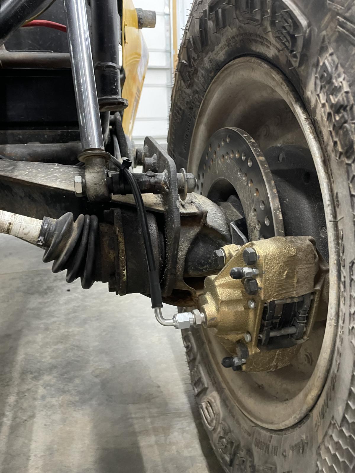

PostPosted: Fri Oct 13, 2023 5:46 pm    Post subject: Re: Front Disc Brakes? Reply with quote
Race Cougar, very nice!
Would you guess that with the IRS rear end that if it had the stock 4-bolt rotors, the caliper would still be positioned in the same plane as with the early 5-bolt rotor?
Did you have a manufactured rear hub mount for these calipers?
I got my EMPI front 3-bolt ball joint caliper mounts today. The right side fits nice and squarely, but the left side has like a little casting crown on the spindle surface and the bracket rocks a bit. I think I can draw file the surface to true it back up in just a few minutes. They fit my calipers that I'm running on the rear, which are stock front calipers for the Beetle I'm guessing.
Your new calipers look like they will be powerful enough to stop without any issues. Can you list what you bought etc?
Thanks, Dan

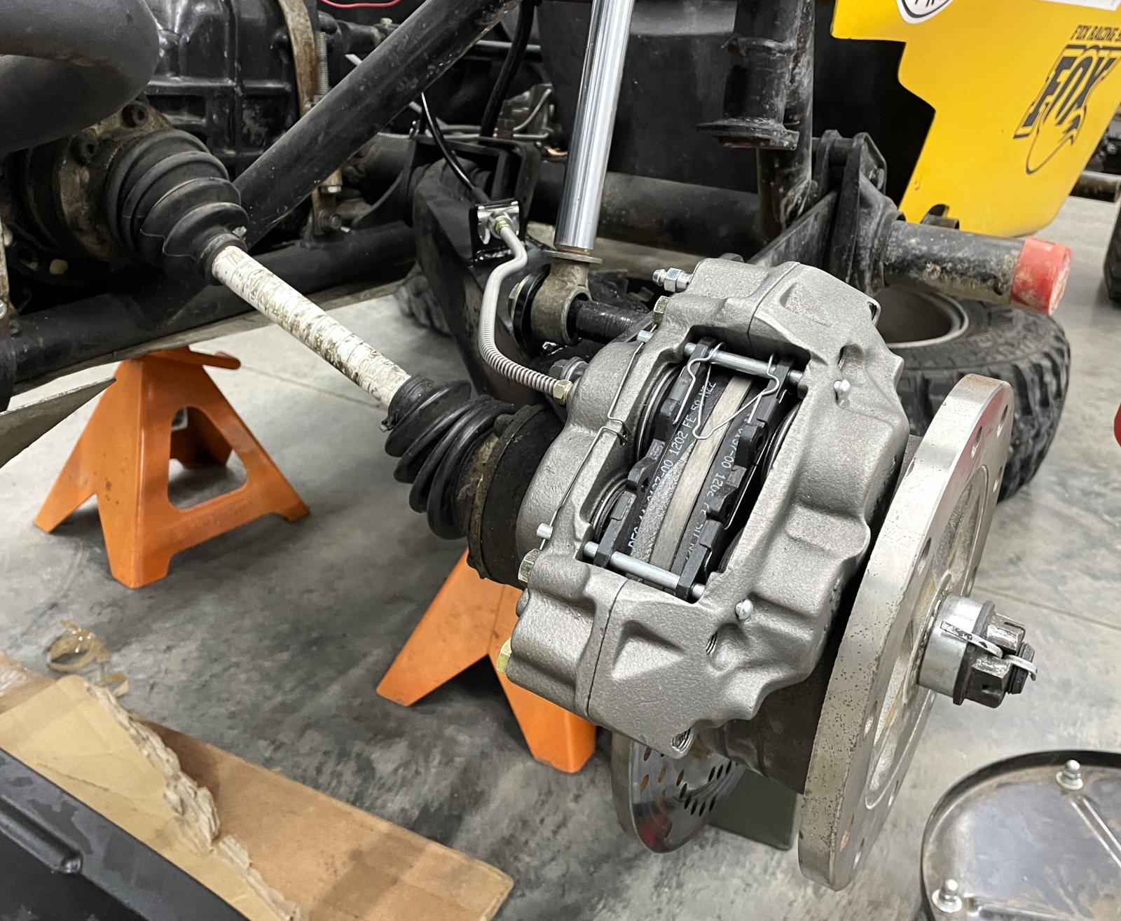

I'm totally new to VW's, so I have no idea what a stock 4-bolt or 5-bolt caliper looks like.
I'll make mounts for these.
I had to file out the slides on my EMPI brackets; they're quality control is pretty awful.
My front calipers are VW Rabbit pieces. IIRC, I ordered them for a '79. I paired those with EMPI brackets, and I turned down a set of caliper slide pins for a '15 Jeep Grand Cherokee to fit.
The rear calipers that I will be installing are spec'd for the front of a '81 Toyota 4x4 pickup. I'll weld up mounts for those.

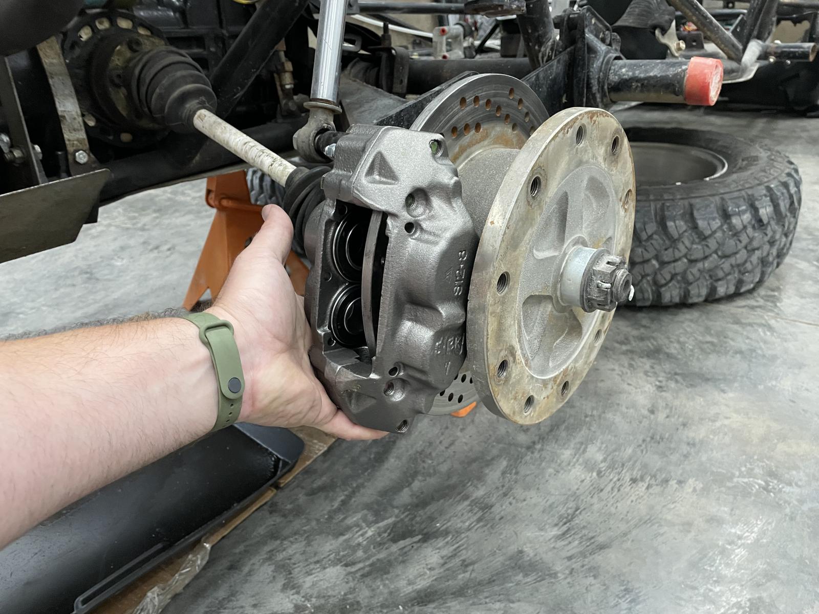

The ones I bought were spec'd for a '81 Toyota pickup. They are the S12+8 calipers that were used on a number of vehicles. There are different versions, so you need to pick ones that match your rotor width.
An old pic from when I installed them:
likes a pic
I've got a set waiting to be put on too. I'm actually excited to work on this, but this summer has been disappointing on so many levels and I have run out of ambition to work on any of my projects. Hoping I get a second wind soon. Ever since my Missouri trip I've been unproductive.
