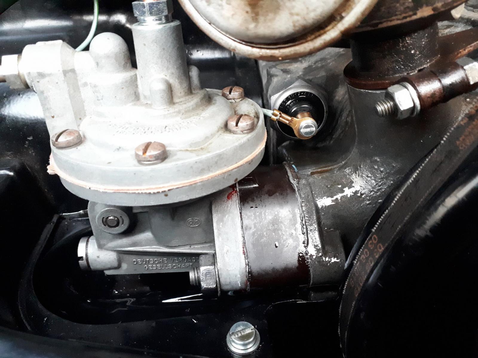

So I pulled the oil pressure switch out to see if it has a calibration screw which of course it doesn't. I reinstalled it and it actually works the way it is supposed to except for dumping oil out now.
Friends have offered me a few to try.

This gives me a little thrill:
It works as it should and it doesn't leak. When I put the original engine together the switch that came with it did not work, would not shut the light off. I installed the one from my spare engine and it worked for a year or so and then started leaking oil. I then bought a new one from CIP. Almost immediately it failed and wouldn't turn the light off at idle. Investigating it I found the terminal was loose, it started working properly but started leaking a lot. Now I have one dated 1 58 that, cross your fingers, works and doesn't leak.
Another bit of good news: I bought an NOS vacuum advance from Frederik
https://www.thesamba.com/vw/classifieds/detail.php?id=2333581
Installed it yesterday, really dresses up the engine bay
Ever since I built this car it has had a little flat spot off idle, that seems to be gone. A win I think.
