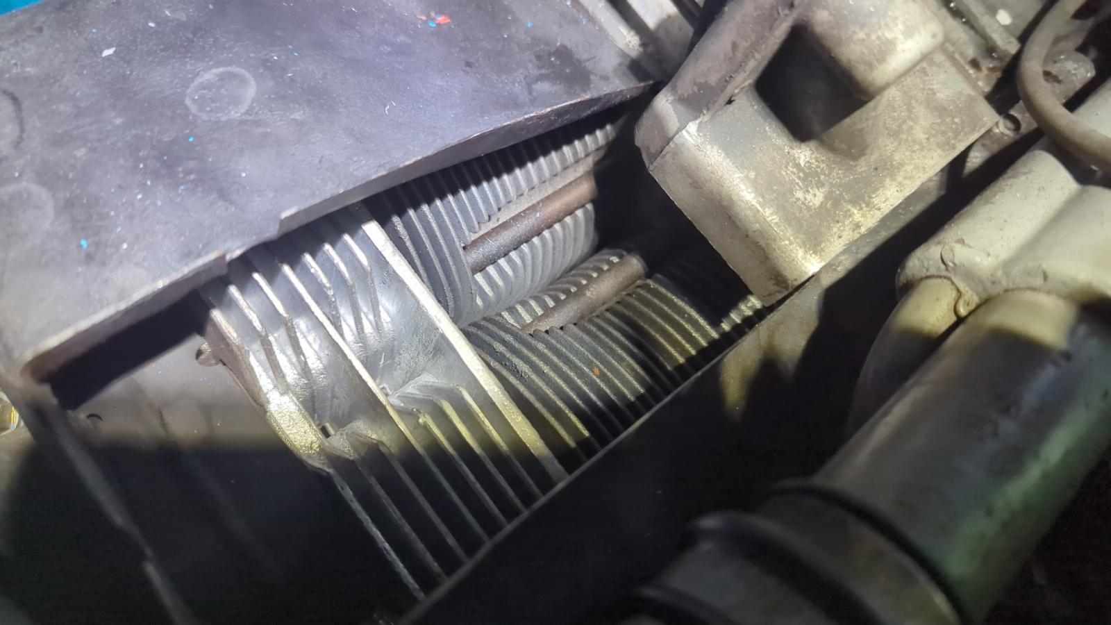

PostPosted: Mon Aug 11, 2025 2:31 pm    Post subject: Re: Yikes! I bought a '74 Super!! Reply with quote
Thanks Rome. But I parked it again, to replace the oil cooler. It's still running hot after not long or hard runs, oil temps going over 230 on a 30 mile run. And that's w/a 140 main and 65 idle jet in my 34-3. And it's not fuel starvation this time, carb is full and clean.
So...wish I could do this w/out dropping the motor again. But what's a bigger hassle? Removing the decklid and its hinges as one? W/out the decklid I can probably reach all the nuts required to remove the shroud. But is there enough clearance even w/out the lid and hinges on to pull the shroud up enough...?

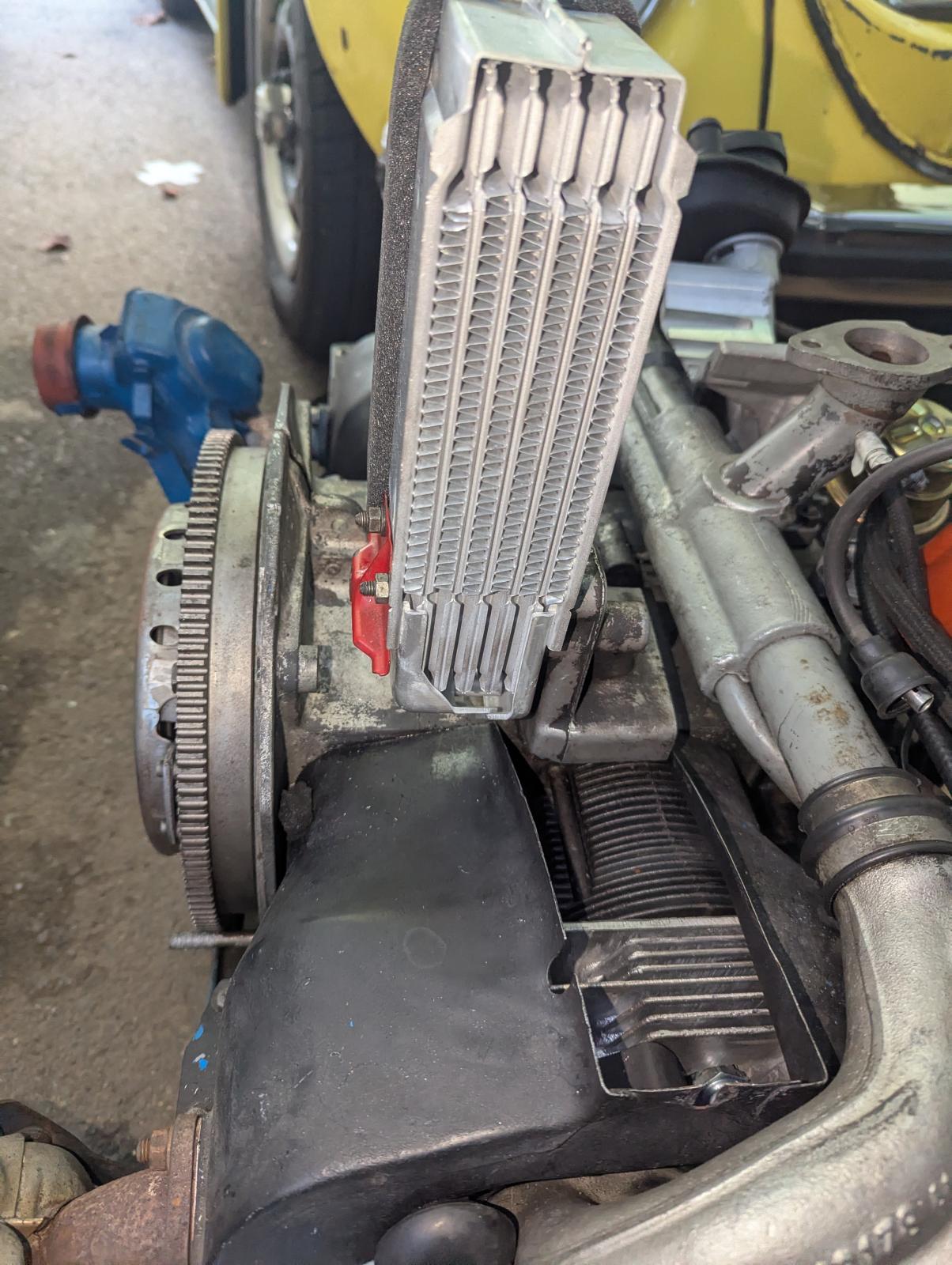

PostPosted: Tue Aug 19, 2025 5:05 pm    Post subject: Re: Yikes! I bought a '74 Super!! Reply with quote
Well, I answered my own question. No way there's enough clearance to R&R the oil cooler w/the motor in the car. So I dropped it, had to remove the header (there go the last of my dual heat-riser seals) and the front engine tin....and there's still not enough clearance for the cooler to get free of the top two mounting studs because the cooler hits the bell housing. So it looks like I have to remove the base of the cooler as well...which also appears to require removing the intake manifold, the 3-4 tin and possibly even the 3-4 head to get the nuts underneath the base.
I have to admit: I'm getting very tired of the school of hard knocks. Evil or Very Mad Crying or Very sad

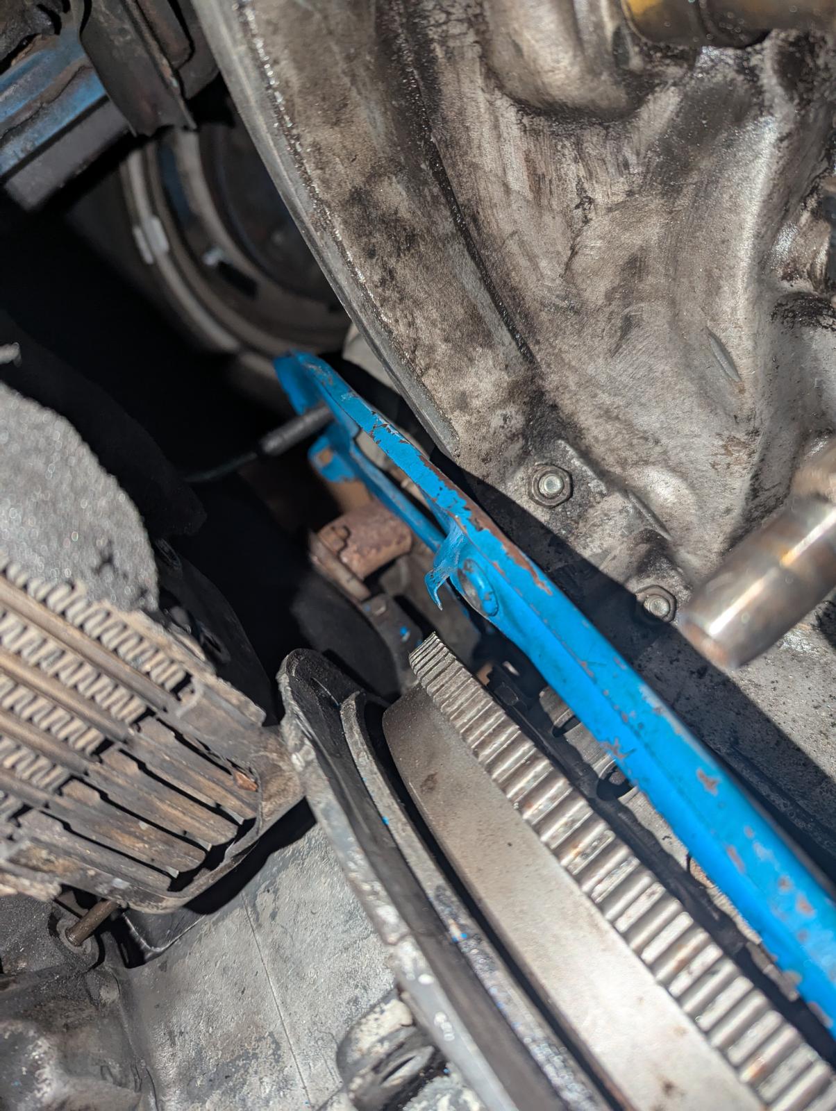

PostPosted: Wed Aug 20, 2025 4:56 pm    Post subject: Re: Yikes! I bought a '74 Super!! Reply with quote
Soldiered on, what else is there to do??
I improvised a tool by heating up this cheap 13mm box end wrench then bending in the vise and trimming it to fit the underside nuts of the oil cooler stand.
And it worked!! I had to drop the engine and remove it from under the car, but I was able to get the nuts off w/out removing the intake, cylinder tins or 3-4 head. What a f*g relief!! Very Happy
And it's back on and the engine mostly back in the car. Tomorrow I reinstall the header and cross my fingers.
If this doesn't solve the hot running problem...I give up on this motor.
