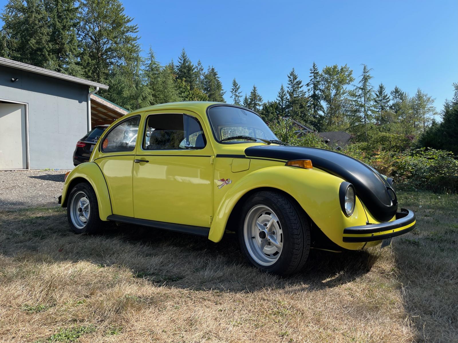

Howdy,
i've neen a long time member of the Samba and thought I would post my latest build. It's been a while since I've done a VW. Last one was my 1500S Nutria Brown Squareback.
A little reintroduction. I cut my chops with VW's specifically Superbeetles (73 and 74) prior to purchasing a 64 Beetle and Squareback, along with a multitude of Ghias, more beetles, and more Superbeetles. I've always had a soft spot for 64s, along with special edidtion 72 and 73 Supers. I woned a 72 Marathon beetle along with several Sports Bugs. I got the Porsche bug (no pun intended) and founded a little social club called 3 Pedal Posse. Here I dove into anything aircooled 911, beginning with several SWB cars all the way to 964s and 993s. As they say life happens, and you start to remenisce. So i took on a project for a very special individual in the form of a 73 Sportsbug ala GSR. I purchased the car here about 7 years ago. It was an abonded project that had been "restored". While the paint and interior were in great shape, the mechanics and electrics needed work, along with overall fitment of panels, latches, etc.
My goal was to improve on what was there to better allow the car to perform in today's roads and traffic.
The stock motor was replaced with a well balanced 1776, with mild cam, slightly larger valves, ported heads, counterweighted crank, balanced flywheel and pulley, along with full flow, 90AMP alternator, and CSP larger diameter heater boxes and SS full flow exhaust.
I rewired the fuse panel removing a multitude of unnecessary wires and yellow crimped ends, and replaced wires and connectors per factory finish where applicable. This included new ignition pigtail, headlight wiring and relays for 80/100W H4s, LED bulbs front to back, along with correct flasher relay,home made stereo plug in harness, auxiliary USB port, and rear third brake lights.
I also installed a MK1 Golf wiper switch with intermittent function, and wiring for electric washer pump.
CB Performance four wheel disc brakes, with CSP large bore master cylinder, and TOPLINE adjustable suspension in the front. Polyurethane bushings and front and rear sway bars.
Last but not least, a freeway flyer gearbox is in the works so she's not screaming at 70mph.
It's been a while since I've had a VW project and needless to say, the quantity of NOS parts is much less than I remember. Fortunately, I had a little stash set aside.
I'll keep adding to this thread to show what's been done and share some of my findings. I hope you an joy and I look forward to reengaging with the Samba peeps.

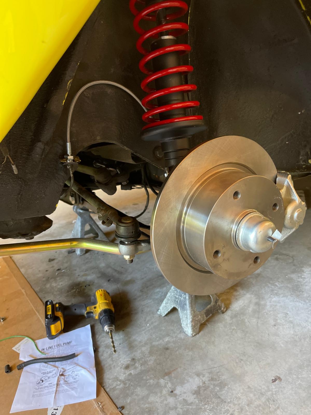

Thank you. I had some folks as about the suspension and brakes.
Suspension is TOPLINE adjustable struts up front. New control arms, urethane bushings, sway bar, ball joints, tie rods, etc. i switched it to 74 and up in case I decide to switch to a 944 set up. I may need to raise the car an inch up front; it's a little low for city driving.
The new control arms are powder coated with new balljoints installed. I would recommend you check these as one of mine popped out due to the seating surface being powdercoated. Otherwise no issue after fixing these issues.
Rear is urethane bushings, slightly lowered. Rear sway bar will be installed after new gearbox install.
I installed four weel disc brakes (CB Performance) and CSP master cylinder. FYI: he CSP unit allows for only one brake pressure switch.
The car handles fantastic and brakes are very effective and smooth.
I would love to make a set of 6.5 sport wheels for the rear since it wouldn't hurt to have a little bit more rubber in the back.

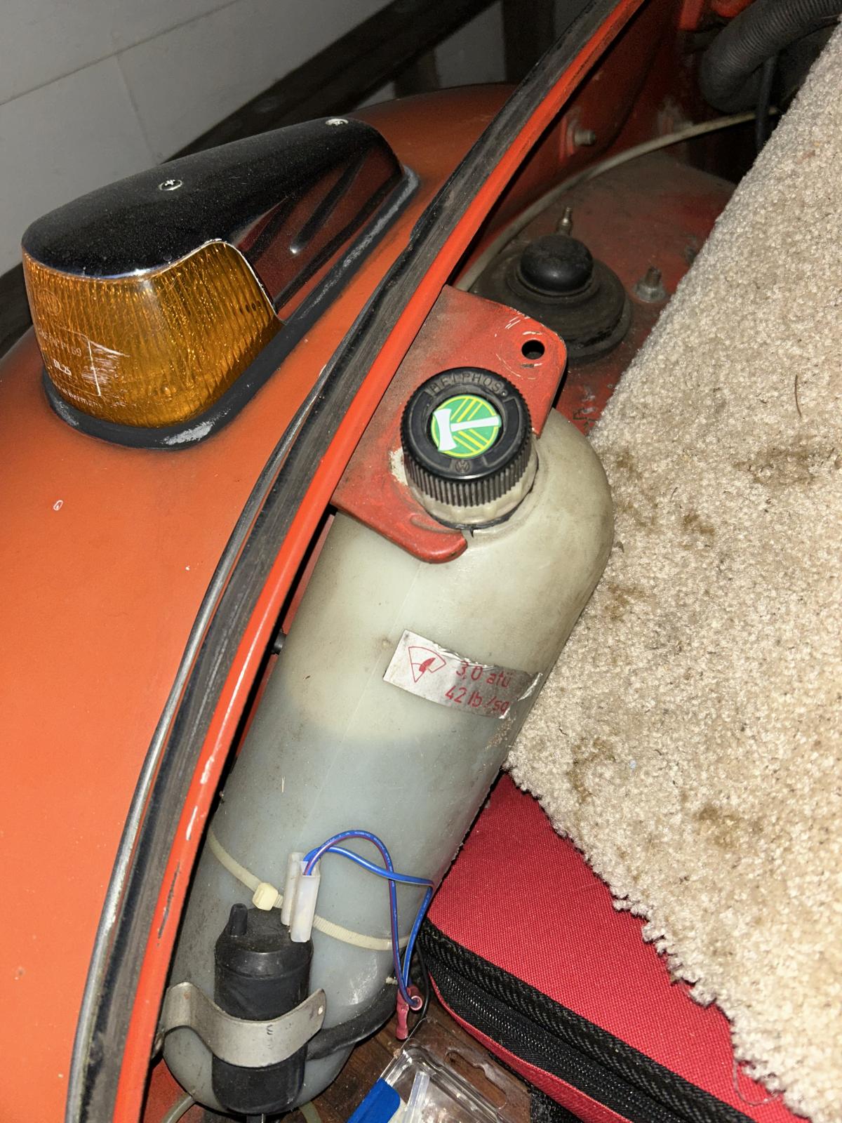

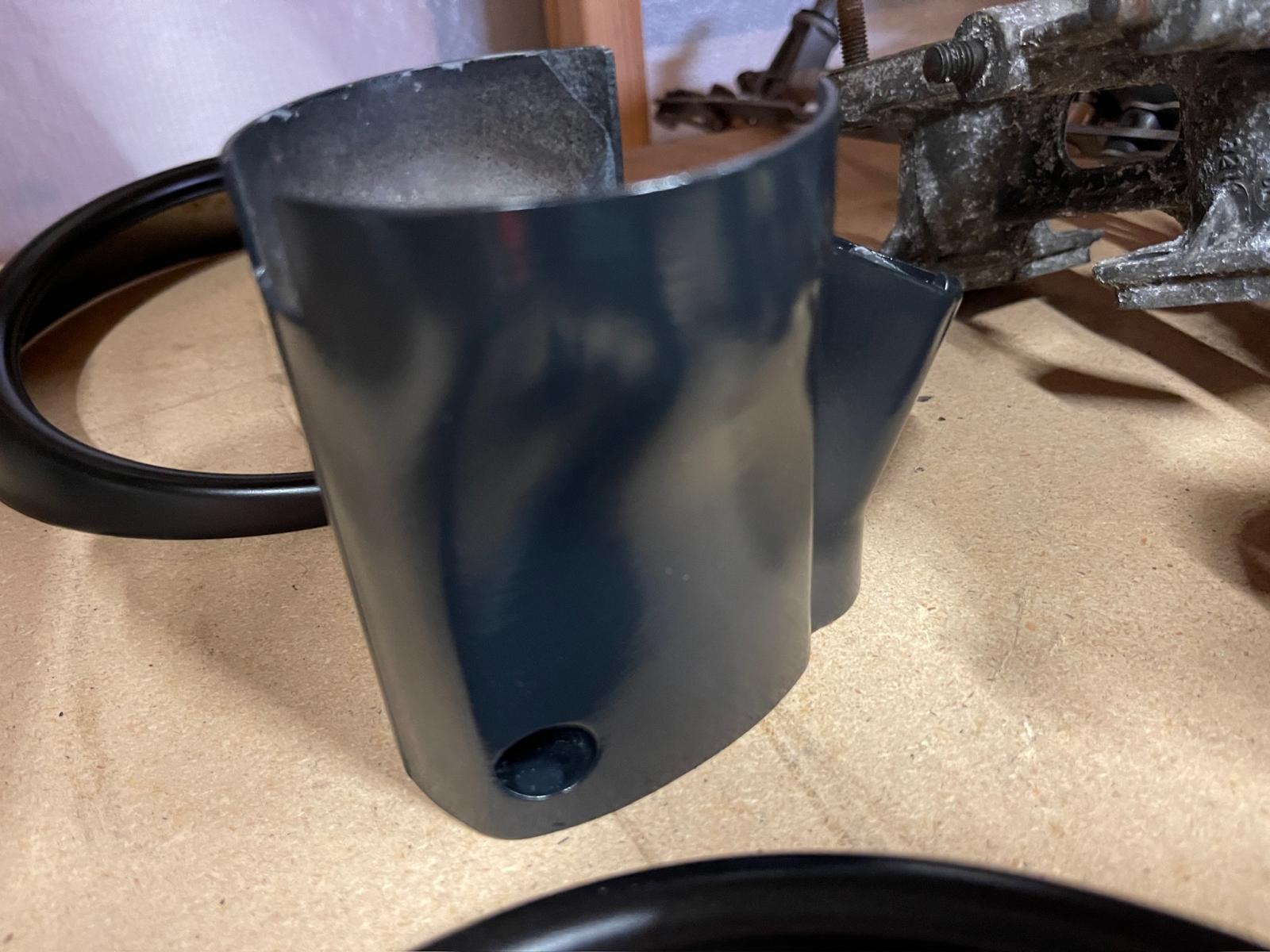

I had a few folks ask about wiring for the electric washer pump. The MK1 Golf wiper switch has two extra terminals for an electric pump, however the plastic housing around the wires on the stalk switch is two wide to slip into the steering column housing, so......
You will need to carefully remove the housing (white) which holds the wires from the stalk that plug into the pigtail behind the dash from the Golf switch, and replace with the one from your Super Beetle switch. The housing snaps together depending on age, is most likely brittle and fragile. The reason for the swap is the Golf housing is to wide and won't fit inside the column housing due to the two extra wires. The two extra wires that operate the washer switch will now be out of the housing, allowing you to fit the switch assembly back into the clamshell along with the turn signal switch.
The two extra wires that operate the washer pump (a ground, and positive will be wired per the diagram below. You will need to insulate the connections.
Any standard 12V relay will work. CIP1 has Bosch ones that are great.
I use a standard early 911/924/94 VDO washer pump as shown below. Please note, installation is temporary as I will be making a bracket the holds the pump.
In addition you will rework the plumbing as you will no longer have water lines running to the switch. Instead you will have a water line from the holding tank to the pump and from the pump to a check valve and than from the check valve to the nozzle. The check valves keeps things flowing in the right direction. Make sure you remove the hose from the top of your water tank that runs to the spare, you will need to leave the nipple open so air can get in as your fluid runs low.
Check Valve: 914.628.215.00
Washer Pump: 928.628.074.01 or 823.955.651
And....walla! Electric windshield washer.
You will need to do some hunting to find an MK1 Golf switch, as they are in short supply.

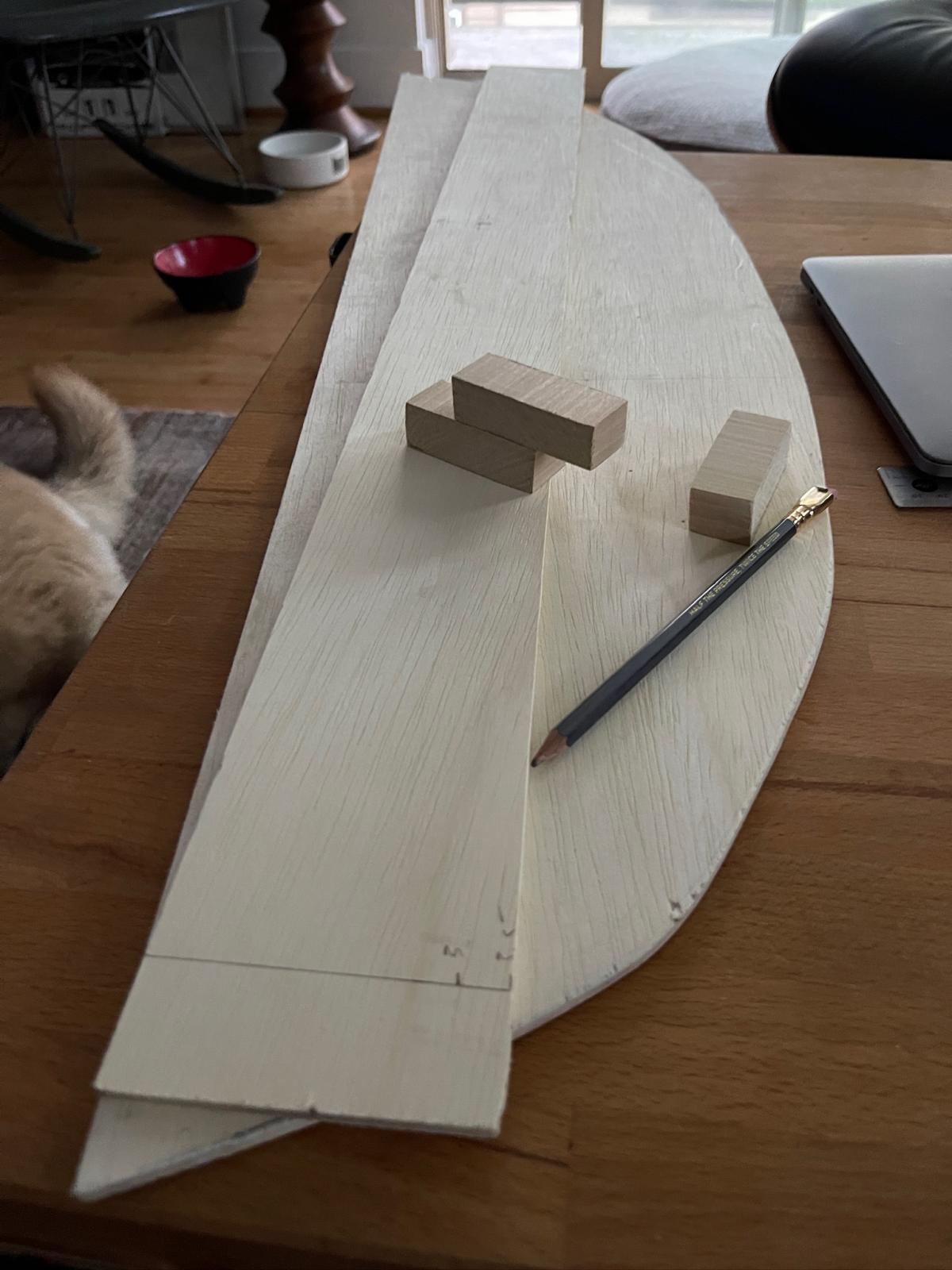

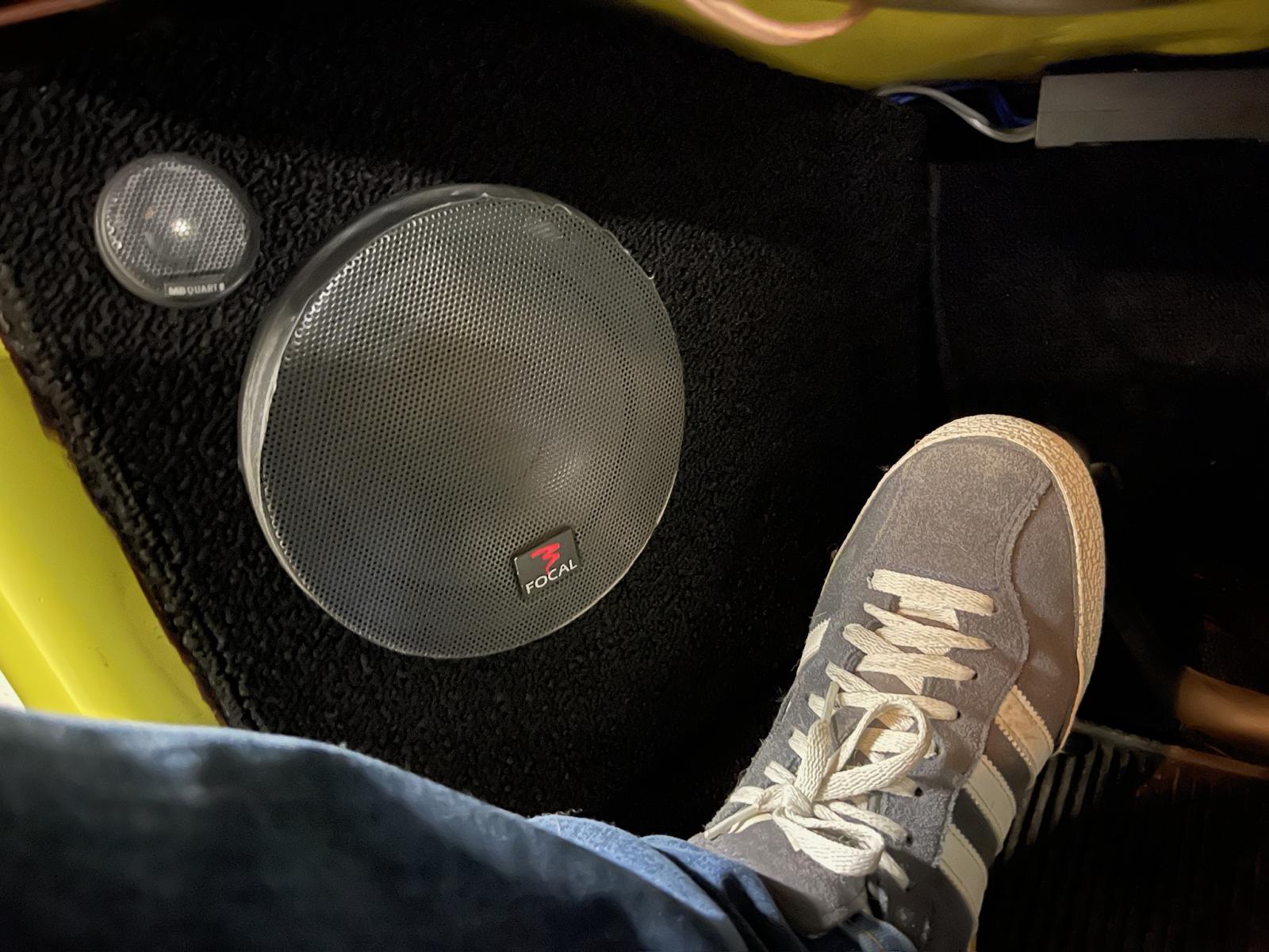

I decided to make my own front speaker kick panels. The ABS ones commonly found tend to stick out to much, so with some creative wood working, glue, and carpet I made some shallower units that give you a little bit more foot space.
I covered them with matching carpet and am pretty happy with the results.

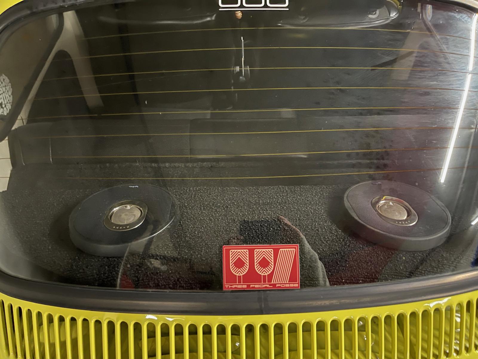

For the rear, I didn't want the speakers to hinder the ability for the rear seat to fold down or for the rear storage area to be compromised. So I manufactured a speaker tray that was similar to those found in early 911s, essentially fitting all the way back to the edge of the rear screen:
Again, matching carpet was used to cover it. Having the tray all the way back there also allows for installation of a third brake light, should you choose to install it.

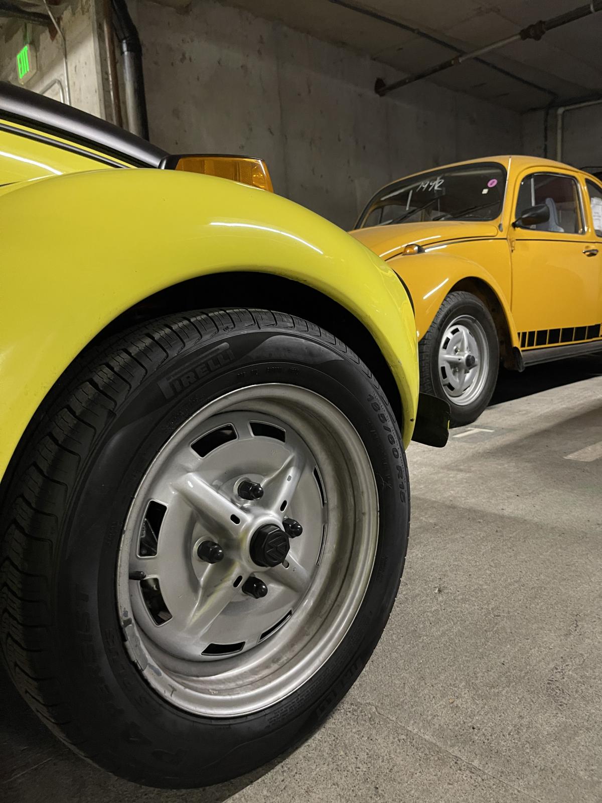

PostPosted: Fri Aug 08, 2025 9:49 am    Post subject: Re: 1303 Sports Bug (GSR) Intro Reply with quote
As my high school science teacher use to say, some's good....more's better. Sheila has a new room mate:

PostPosted: Sat Aug 09, 2025 6:49 am    Post subject: Re: 1303 Sports Bug (GSR) Intro Reply with quote
Hey- that's a sharp one! Looks like a very low-mileage museum car or "time capsule" original from a collector. Did you import it from Europe, or somehow find it "locally"? I think the Jeans Beetle special edition was similar to the "Love Bug" '74 Standard Beetle edition for the US market, though with different colors. Equipment was somewhat stripped down. The Jeans Beetle has a "basic" engine though. Does it also have a doghouse fan shroud despite the non-vented engine lid? Will you keep that original engine, or also upgrade?
Are you satisfied with the performance of your GSR- the engine and the transmission ratios?

PostPosted: Mon Aug 11, 2025 7:35 am    Post subject: Re: 1303 Sports Bug (GSR) Intro Reply with quote
Thank you for the kind comments. The Jeans beetle did receive a restoration in Belgium, although the drivetrain was left untouched as it is in excellent shape and has just over 50K KM on it. I am not aware of any other Jeans beetles in the states at this time. I found the car in Ireland. The Jeans for 73 (first year, all made in Belgium, and for UK, and European market) were made in Belgium. It is essentially a standard beetle (110)- swing axle, 1.2 40hp no dash pad, no full headliner, no fresh air box, and minimal carpet. However, it is 12V, does have the sport rims, along with a passenger mirror and rear fog light. I believe it's a doghouse cooler but I'll have to check. My plan is to keep it is as is and use it as a running around town car. It's not the best suitable option for highway driving.
The Love Bugs were dressed beetles which had all the regular amenities for USA cars of the time (1600cc, IRS, full interior, fresh air box, etc.). From the research i've done, standard beetles (110) were not sold in the USA, although they did pop up in Canada.
I am very satisfied with the GSR drivetrain as the car belongs to my daughter. Currently I have dual 34mm webers which are small for the.1835 but offer the right amount of power and economy given her driving use. Later on, I will upgrade to dual 40mm webers.
