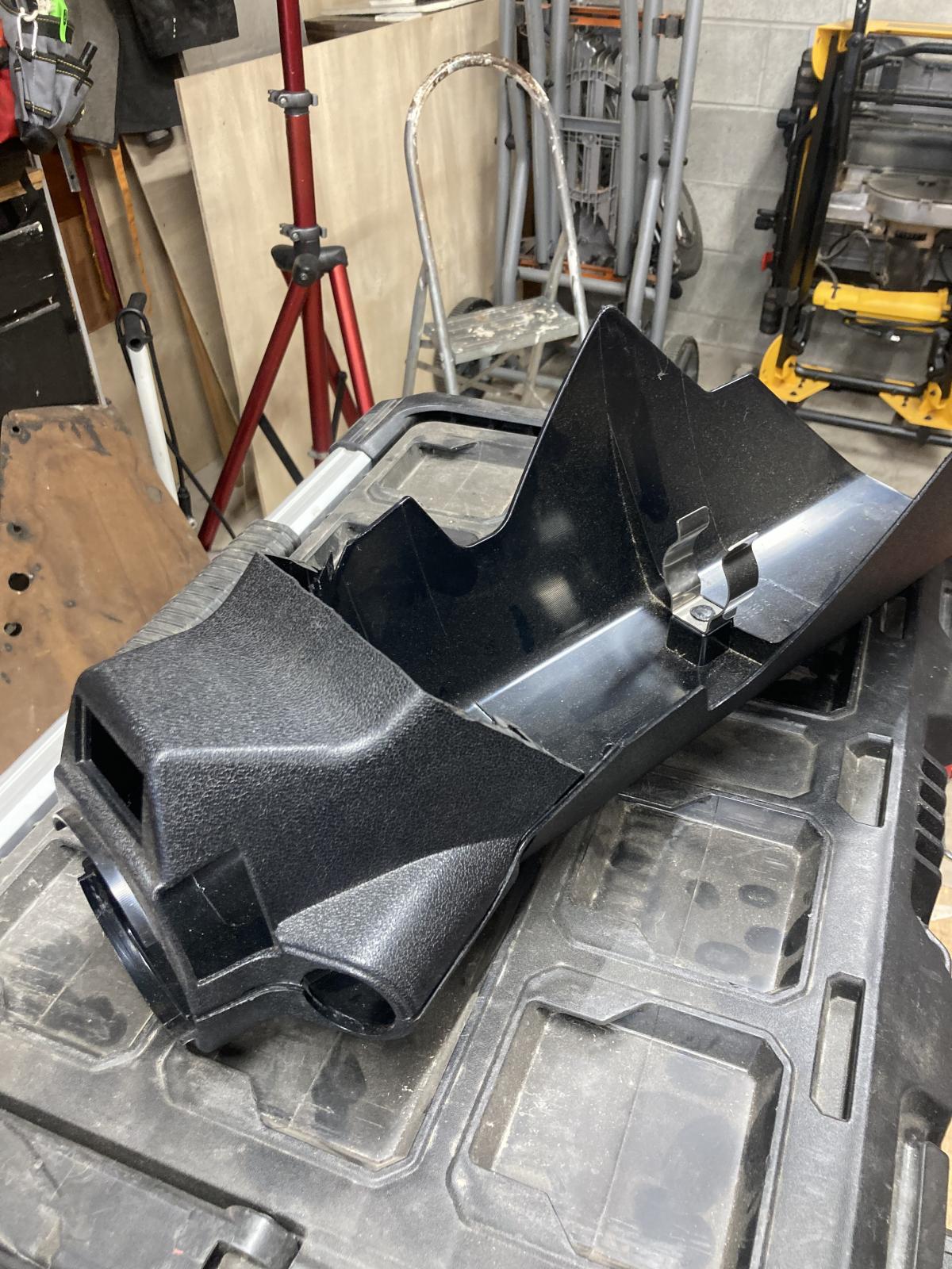

PostPosted: Sat Aug 09, 2025 5:09 pm    Post subject: Re: Official lazy person's stupid question thread Reply with quote
Is there more than one option for the steering column trim pieces? Mine came to me with this cut piece of upper trim that doesn't really fit. Ive searched and only see one kind. Makes me wonder if I have a deeper issue with the steering column where they had to cut that piece of trim to get it to fit...

PostPosted: Sat Aug 09, 2025 5:58 pm    Post subject: Re: Official lazy person's stupid question thread Reply with quote
My guess is it was broken accidently, then they "cleaned" it up by trimming it smooth.

PostPosted: Sun Aug 10, 2025 8:41 am    Post subject: Re: Official lazy person's stupid question thread Reply with quote
As far as I know, there are at least 2 different versions of that upper trim piece.
What you have is the version meant to mount the heated seat switches. I don't believe VW shipped heated seat vans to the USA?
Some time ago, some of our usual vendors were selling that top trip piece, both the heated seat version and the plain version, don't know if they still do?
My WAG, is that somebody before you, bought that top trim piece for some reason. Perhaps, like I did, to install a temp/voltage/amp meter?
The piece you have, may be poorly made, and somebody cut it to fit better?
Or, somebody didn't re-attach the steering column quite right?
That top trim piece tends to be kinda fiddly to remove/re-install under the best of circumstances....

PostPosted: Sun Aug 10, 2025 9:00 am    Post subject: Re: Official lazy person's stupid question thread Reply with quote
Other than color there are two types of upper trim one with the switch fkr the heated aeat and the other qithout.
Yours is meeded to cut probably due to a failed steering column alignment.
