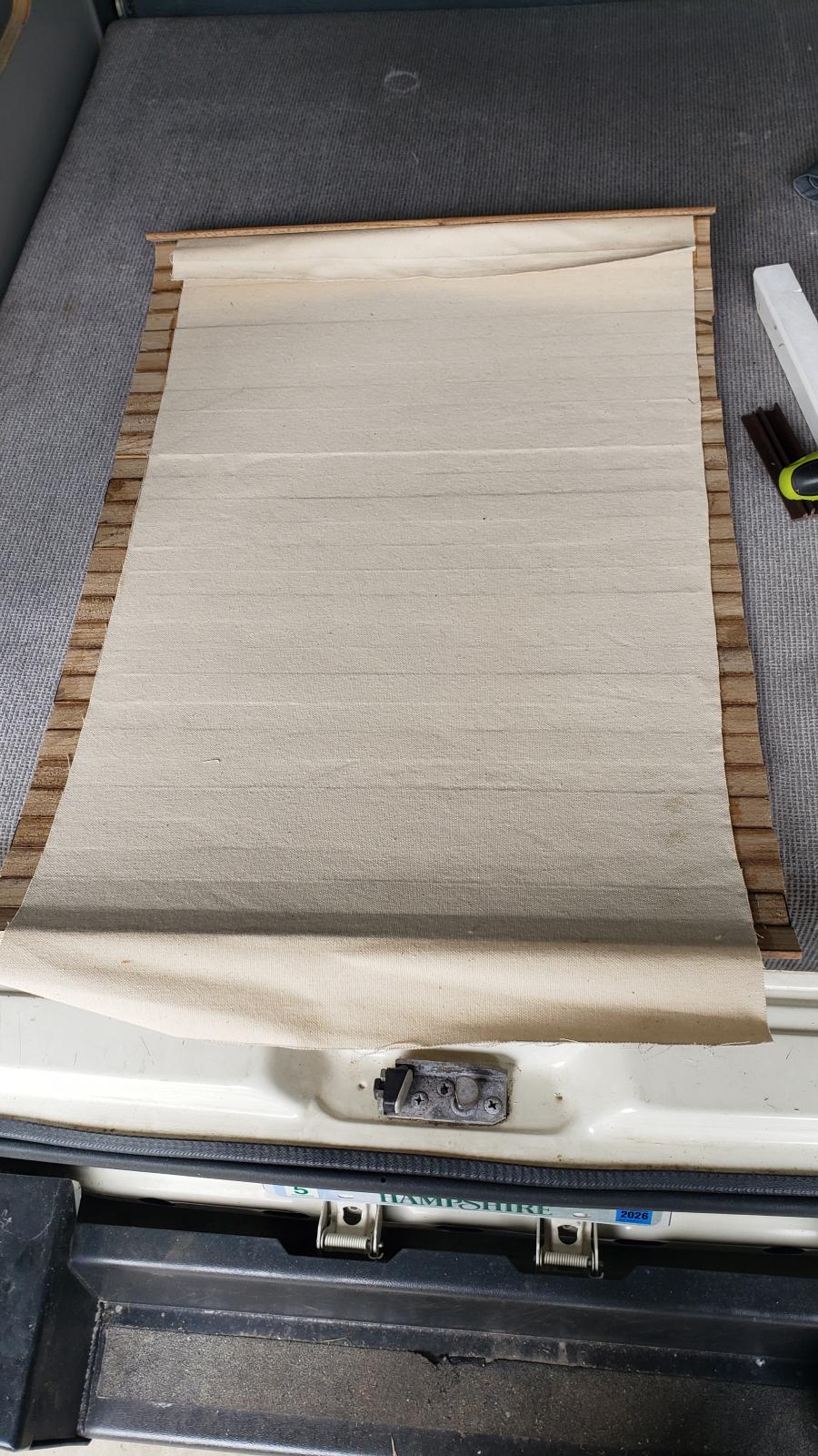

I saw a post a while back from someone who added a door to the coat closet but instead of using a fridge door made a tambour/roll up door. I have searched and can’t find that original post.
I thought it was a fantastic idea and showed it to a buddy of mine. He had already done the fridge door thing, but decided to replace it with a tambour. He made me a door also, this is how I installed it.
This is what the back of the door looks like, basically wood slats glued to a piece of canvas:

The cutout is 22 3/4 X 14 7/8”, the same as the fridge door by my measurements. A 4” hole saw was a nice match for the radius of the corners. The door rolls up and down nicely.
The eBay item you posted looks interesting, although since it rolls up at the top you’d lose a little vertical space vs rolling over the back. The door looks like a nice match for a grey westy interior.
