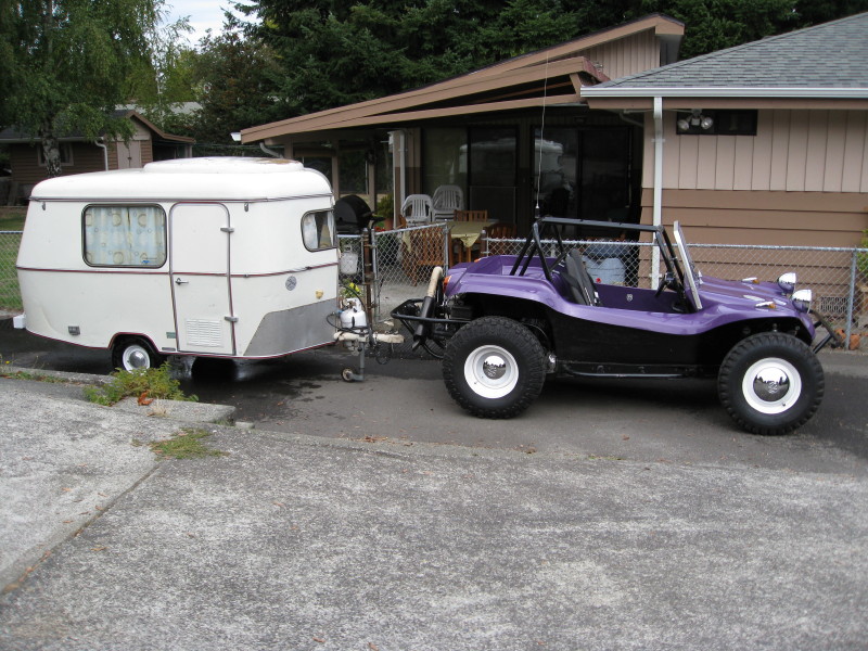

Semper_Dad wrote:
For those who want all the options
love it. sometimes you yanks come up with some hilarious stuff seen from a european angle. Laughing
