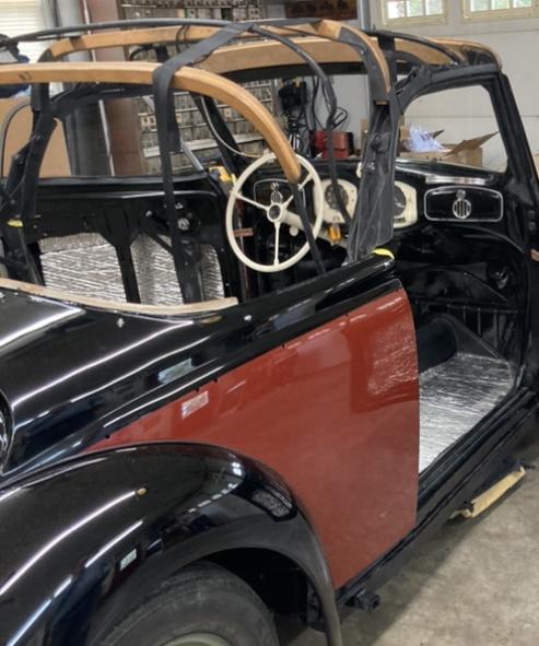

PostPosted: Wed Jun 07, 2023 7:07 pm    Post subject: Re: Hebmueller color code L202 (korallenrot) Reply with quote
I have a PPG basecoat/clearcoat formula that I was able to match from
The semaphore pockets of Heb 428
VEE DUB BOYS
Joined: August 30, 2011
Posts: 149
Location: Greenville, SC
VEE DUB BOYS is offline

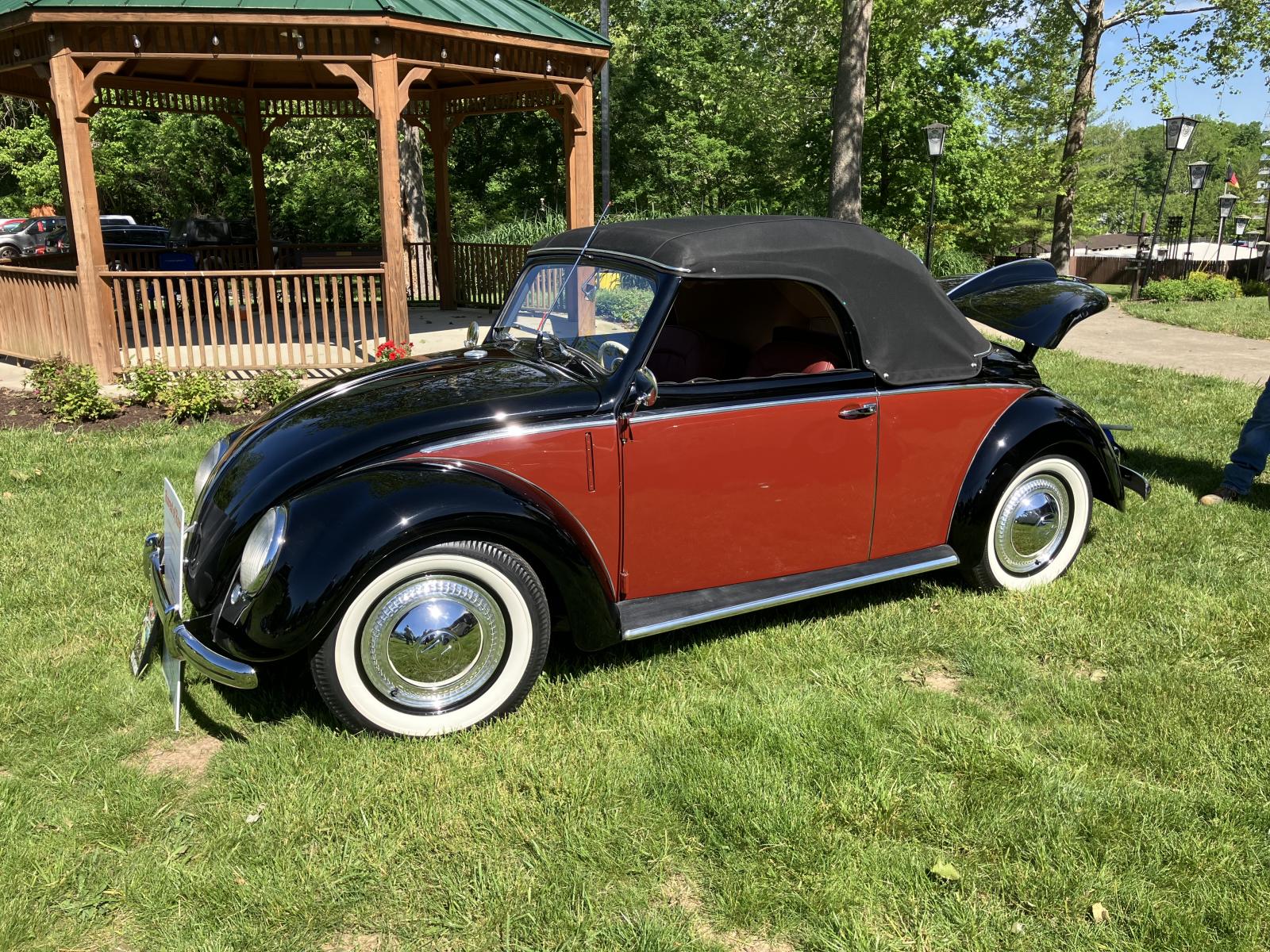

PostPosted: Wed Jun 07, 2023 7:20 pm    Post subject: Re: Hebmueller color code L202 (korallenrot) Reply with quote
A recent restoration on Heb 309 with L202 that was matched from a small
area inside the semaphore pocket of Heb 428. The decision was to go with the red color that was used on the car back in 1965/66.

VEE DUB BOYS
Posts: 149
PostPosted: Thu Aug 21, 2025 2:00 pm    Post subject: Re: Hebmueller color code L202 (korallenrot) Reply with quote
This car turned out great. Bill Goepper’s 309. He used the Koral Red formula that I was able to retrieve from inside the semaphore boxes and formulate into a PPG base/clear. There have been several others with original Hebmüllers that have asked for the formula and are very happy with it also. It is a very deceiving color. In low light, it looks like a red oxide primer. In full sunlight, it is very bright and beautiful. Hope this helps.
