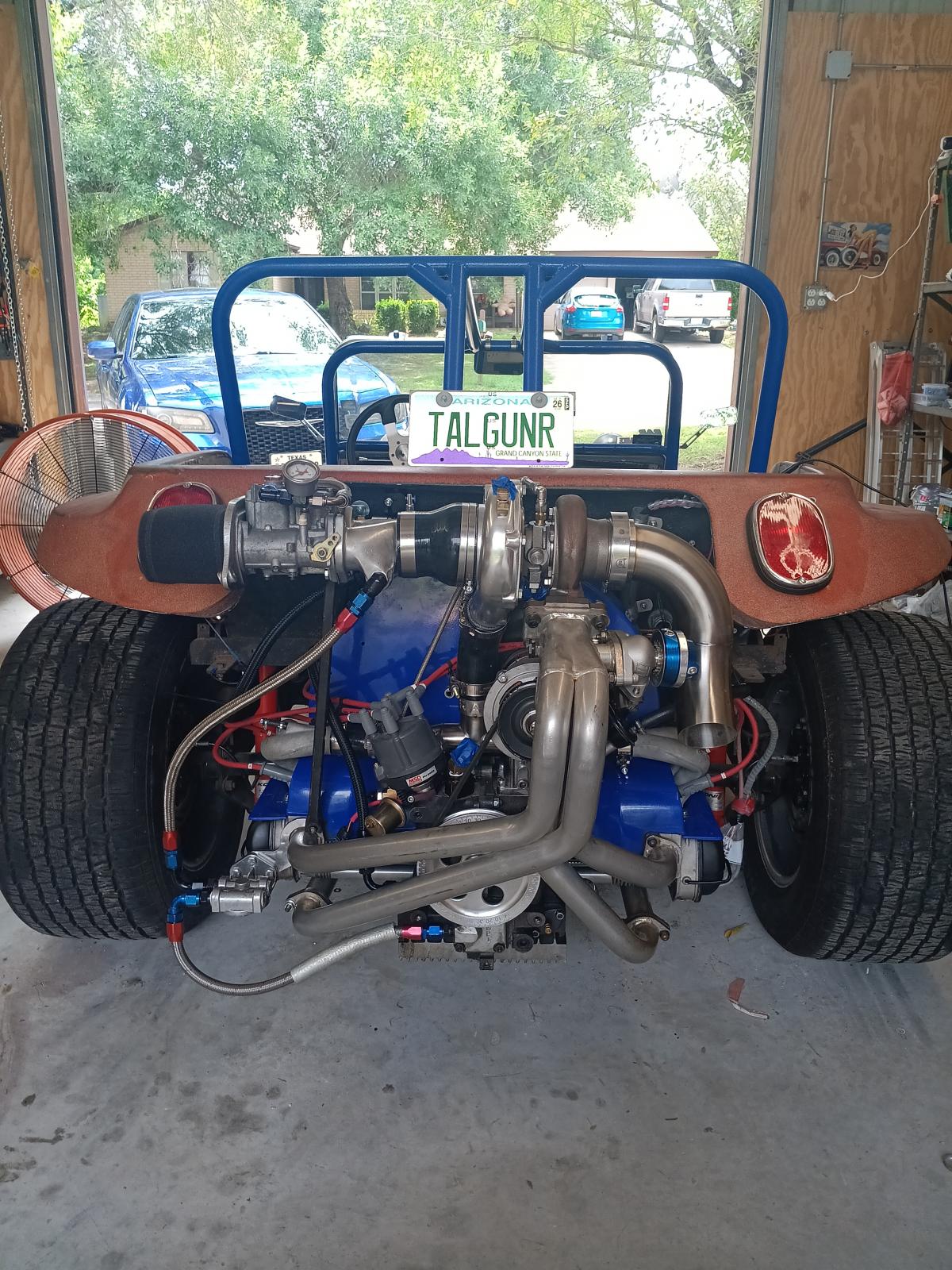

New front brakes installed and tested & approved
New turbo mounted and back in the buggy. Just waiting on a turbo drain hose to come from RAD. Due tomorrow, start up scheduled for Friday

Bravo, sir! How much do those brakes weigh?
Engine looks good! Keep us posted on how the startup / test drive goes! Very Happy

Thank you Sir! Sadly I must admit to not weighing the new brakes. I get tunnel vision when I'm involved in a project.
I'm looking forward to starting up. It still has a very nice shifter in it too. Very Happy Very Happy

Turbo update
My turbo drain hose, from RAD showed up yesterday and got installed this morning. Check. Game on.
Motor filled with Valvoline's finest 10-30. Done.
Removed plugs and disabled the ignition. Done
Turned on ignition to fire the fuel pump and bench set the fuel pressure regulator to 3 PSIG. Also tightened up fuel inlet so fuel leak would stop.
Cranked engine over until oil showed up at the end of the turbo oil feeder line and hooked it back up.
Plugs back in and ignition enabled.
Time for test fire Laughing fingers crossed
It fires and sounds bad ass! Cool it has an oil leak... dammit Embarassed
It appears to be running out of one of the push rod tube seals
Smoking gun found and replaced
Now it's leaking like the Exxon Valdez
Double dammit
Now I'm wondering if I didn't upset the oil cooler seals when josteling the fan shroud on and off... Evil or Very Mad
ALSO dammit I found that the rubber 45 degree hose from the turbo collapses under vacuum
Long story short, I expect it's coming back apart to redo the cold side tubing and inspect the oil cooler and seals

Well, the oil leaks are disappointing, as you well know.
What pushrod tube are you using?
My 2276 leaked like a sieve when I fired it off a few years ago. The pushrod seals were leaking.
I use JayCee PR Tubes. I pulled the tubes loose against the springs and wiggled the tubes and seals a bit to get the seals reseated. No more leaks.
Unless you didn't tighten the oil cooler well, you may have jostled the seals a bit but, that's not a likely scenario.
I wanna hear/see a video of that thing running. Wink

Thanks for your input. I have JayCee push rod tubes. One of them wasn't seated when I experienced the first leak. I replaced the seal and reset the tube, but the leak continues. I pulled the fan and shroud to inspect the dog house cooler and it's clean and dry.

That's a lot of work for nothing. I really wanted to see a smoking gun ruptured cooler, or something Confused
It could have been worse... I could have been working on a sedan or van or something!

It's niggling issues like this that made me a believer in test stands. Tall test stands so no bending over. Comfortable working height when standing.

I have a suitable work bench my engine stand is on, I just don't have a run stand yet Confused
And yes. My work bench is almost as tall as the buggy roll bar. Very Happy

So it seems that getting push rod tubes to seal, is just a matter of holding your tongue right. Rolling Eyes I used my patent pending push rod tube compression tool (a short length of mule tape half hitched onto the tube) to compress and re seat a couple of tubes with enough success to stem the flow of oil hemorrhaging out! Huzzah Very Happy
Now I just need to sort out my DCOE accelerator pump's failure to do it's intended task.
