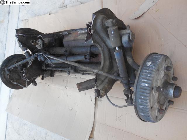

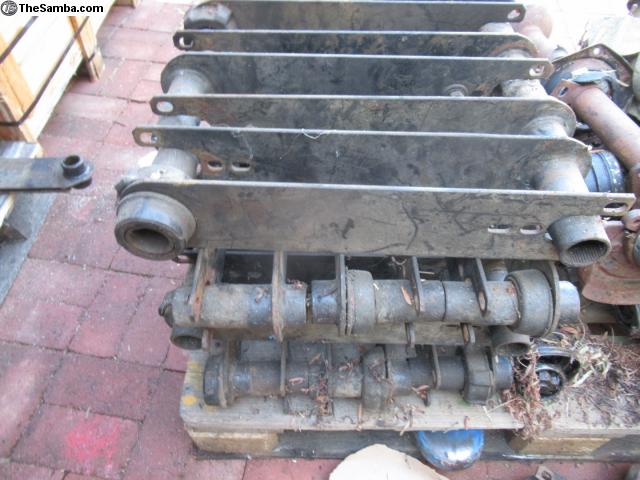

1962 356 complete front end suspension clip Listed in the classifieds - located in Laguna Beach.
Link: Porsche 356 Front End Suspension
Spring plates, and I’m sure whatever else you need - same seller.
