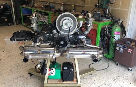

So my 356 has its "correct" engine (not matching numbers) but I want to keep it as it is and not ruin it so I have a ready build type 1 engine. It has porsche style cooling so needs a remote oil cooler.
What is the best place to mount a remote cooler? I have seen a couple of kits but nothing that looks right?

They sell 36hp style fan shrouds with a dog house oil cooler which would be your best bet but they also sell a thin sump that bolts to the oil strainer and it ads extra oil capacity and sits in the air stream to aid in cooling.

understood. Already have an extended sump but I cant use a doghouse cooler as I am using porsche style cooling see pic

911 style fan shroud, OK so do you have room to mount a cooler to the underside of the engine compartment hood grill?

You have full flow? Thermostat?
But if money makes or plays no rolex, you can think about an adapted original 356 Carrera-style oil cooling system, including dry sump.
Side question: how do or did you connect the 356 throttle rod system with your carbs? Pics?

PostPosted: Fri Sep 26, 2025 9:06 am    Post subject: Re: Remote cooler for type 1 in a 356 Reply with quote
Interesting, I had not thought of mounting there. will have a look

So I already figured the throttle would be a problem so I have a spare throttle pivit that I can convert to turn the rod action into a cable action and run to the throttle linkage.
Got thermostat and full flow
