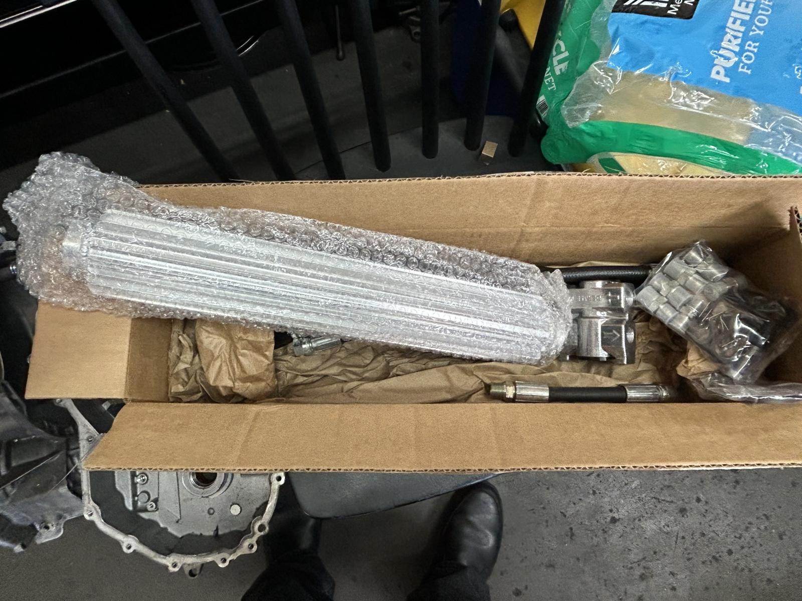

Another update from this morning: the transmission is complete and ready to install. Looks nice!
GoWesty cooler and new CV boots:
I’m excited to get the van back. Hopefully next week!
