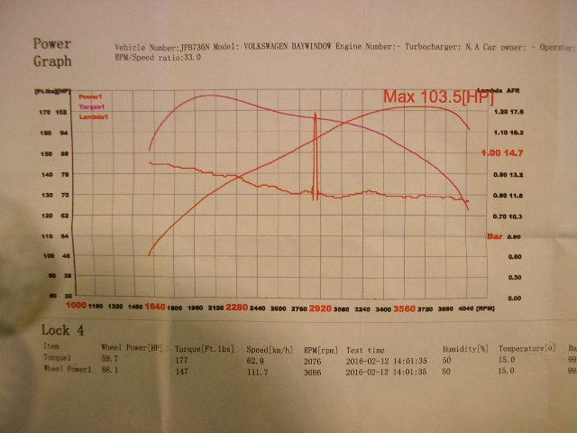

That's more or less a stock 2L type-4 cam. Others will advise on type-1 but I can show you what happens if you build a 2.4L type-4 with a stock cam in a hurry with 3.5mm deck - it doesn't rev but it was more HP at 1800rpm than a 1600 at peak power which makes it very relaxing to drive.
This is obviously the other extreme, I'd give it a little bit of cam if I did it again and solve the deck height/CR problem.

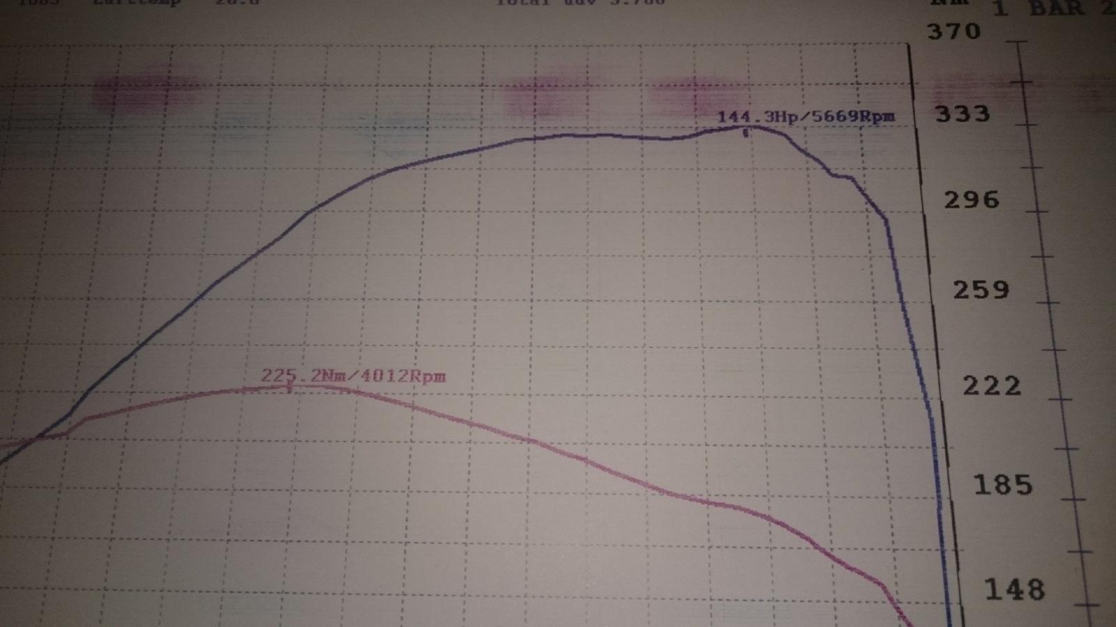

Bump the bore to 94, so you get a 2165, then the W120 will work fine.
If you stay 2007 I would go down to a Web 218/119.
I´m not an Engle cam guy, but here is a 2165 w. a W120, similar heads, 9,5 CR. 1,25 rockers, 40 mm Alfa Dells, CSP Super Comp Evo exhaust. It ran ok. didnt really like the behavior in a type 1, but in a much heavier bus it would be fine.
