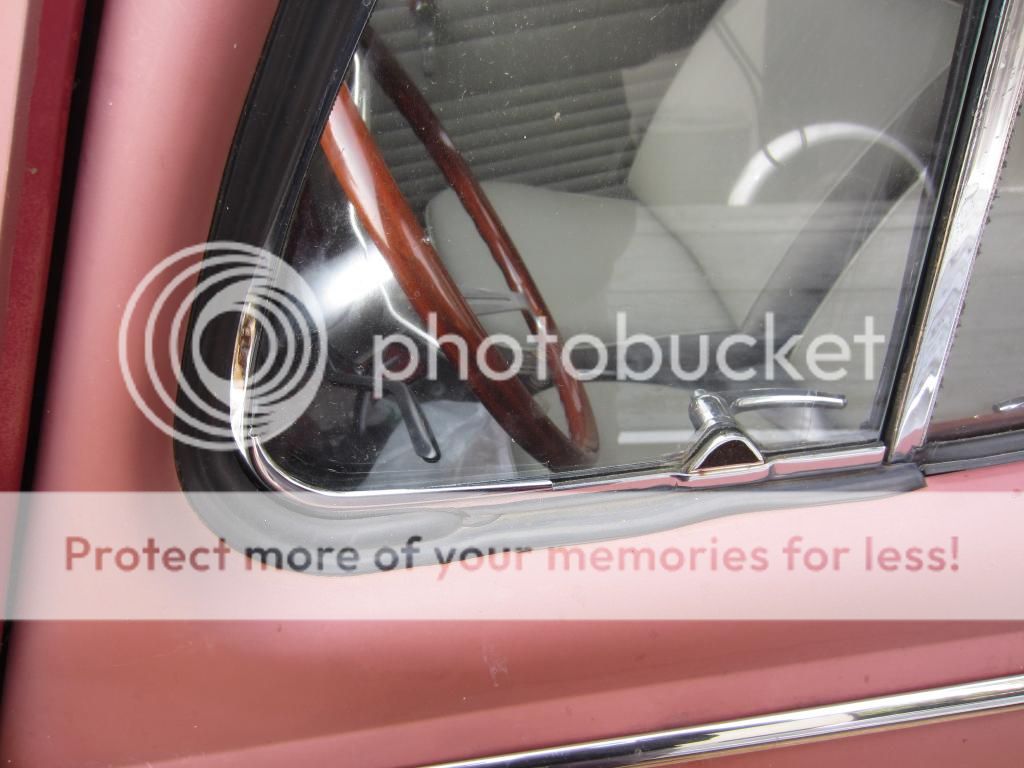

I was wondering if anyone has past experience putting one of these gems in.This is as far as I got last night and out of frustration called it quits for the night.I know you have to make a cut in the lower part of the rubber where the latch is and I did that .What I was wondering do you have to make cuts in the curved part.The one I took off has these relief cuts in the curve.When I wash it with a high pressure wash it was leaking.Don't know if the cuts contributed to the leak.

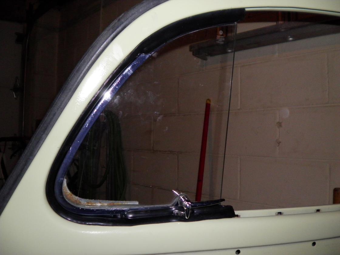

X2 on the video. It can definitely be a frustrating experience. I installed a set on my '60. I did not have to make any relief cuts. Seems to me I had to "shave" some rubber off the bottom of the seal near where the latch is.
I bought my seals from Wolfsburg West. Warming up the seal may help. Some talc powder may help as well. Take your time. I found installing the second vent seal took about half the time as the first one did. Best of luck. Smile

I also have recently replaced my window seals in my '63. The first vent seal was a PITA and required alot of patience but once you get them in and know how to work the rubber it makes it easier. You only need to cut the rubber where the latch pops up through the seal. Silicone spray helps get the rubber in the channel. Make sure you mask around door to stop scratches.

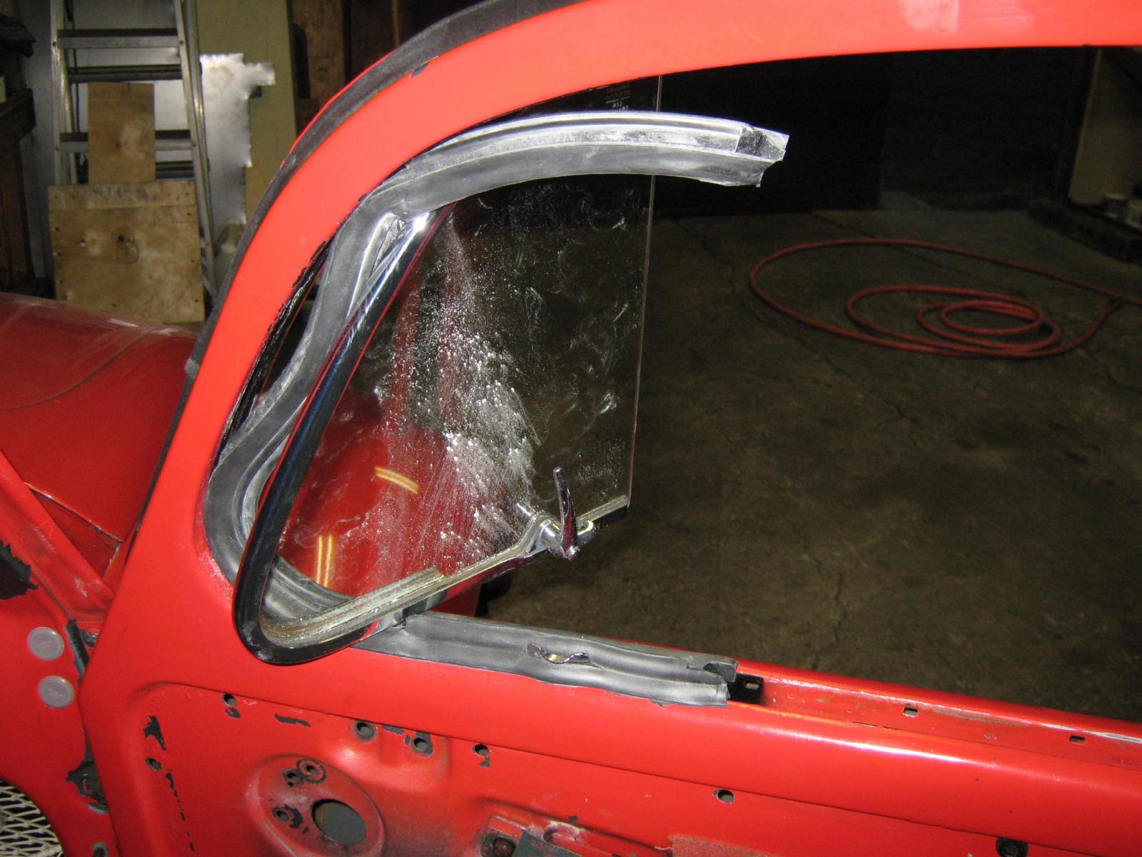

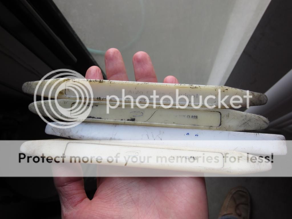

I've done them at least 2 or 3 times on my '63 doors over the years and I used soap (most of the time) for lube as I never seem to have talc powder on hand. Multiple glass sticks are used to work the seal into place. I put one glass stick on one side of the seal (say the interior side), and another on the opposite side. Then I carefully push the seal into the channel, working both sides at the same time to force the bulk of the seal down into the channel. It's been a few years since I last did mine so I'm going from memory here. I've done them different ways in the past, but found the way that I think works well.
I prefer to do mine with the top of the chrome post fastened in place so I know exactly where to start the top of the seal. Once I have both ends located correctly (vent post secured on both ends at that point) and I've worked my way to the center, I do the heaviest part of the curve last, then close the vent window. Once it has pressure on it, I usually take a glass stick, slip it under the lip of the seal and drag it along as I spray water (from a spray bottle) between the seal and metal door to get rid of the soap residue. This is also a good time to check that your seal hasn't popped out of the door at any place. You can then wipe it with a dry clean rag.
There are a few ways to install these seals, but none of them seem to be that much quicker than the other ways I've tried. The job is NOT one of my favorite ones to do! Also, I do NOT notch the seal at any place, unless the seal I have needs to be slit for the upper wing window pivot bracket to pass though.

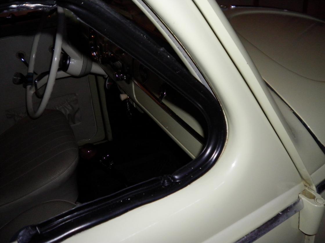

Those serrated cuts are found on original seals.
Are they needed? No. Do they help on install? YES! Onlytoolyou need are some strong thumbs. But besides those plastic scraper tools shown by youngnstudly, you can use a flat head screwdriver with some tape wrapped on the blade

Thanks for all replies.I finally got it installed.It's really tight though. I might just have to live with the old driver side seals for a while though.
