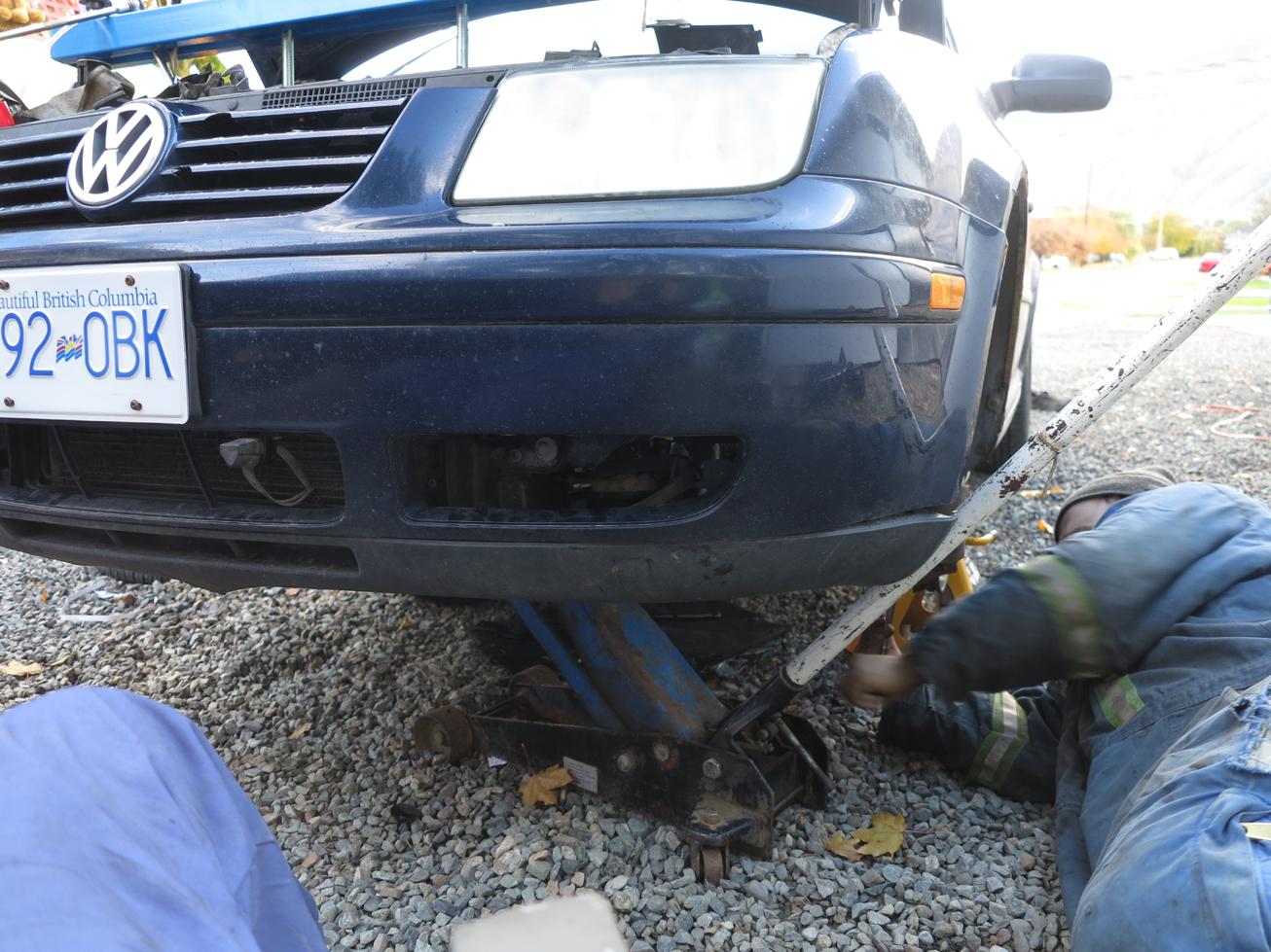

Well it was a great adventure working with my grandson
the working conditions were not as comfortable as working in my shop with a cement floor and hoist and heat.
Instead we did the job outside on a gravel parking lot, the shop space deal fell through, but my grandson did the on the gravel under the car things and I did the top side stuff.
First day the weather turned nasty I left Dom to tend to the axle bolts while I headed off to Canadian Tire for a tarp and rope.
We had to remove the left lower ball joint bolts to get more room by moving the drive axle out of the way.
Then the transaxle came out OK.
I made up a metal tool to bolt to the flywheel so I could keep the flywheel from spinning while undoing the bolts
The Dual Mass Flywheel was loose and the pressure plate had a broken finger the clutch disc was very thin.
The throw out bearing came out in many pieces.
We cleaned everything up with Brake clean and Scots bright pads and replaced the rear main seal.
We put the new single mass flywheel on and torqued it and installed the disc and pressure plate. I said that is enough for today. Dom climbed out and I looked to see what things looked like and saw the thin steel plate that goes between the engine and transaxle laying on the gravel. doh
He tried to put it on but it has to go on before the flywheel so we pulled the flywheel and clutch off. Called the VW place in Kamloops to see if they had new torque to yield flywheel bolts and they did.
We found out the Axle seals for the transaxle were too big so called VW again but they didn't have any in stock but would have then the next day in the morning.
We drained both the engine and transaxle oils and refilled with new. New oil filter installed
We got everything back together the next day and took it for a drive - A OK
I found the crankcase vent hose was cracked so we ordered one from VW.
I got to spend some time with my son who lives in Kelowna who drove up to see if he could help.
I left and headed home another 10 hour drive.

The floor jack didn't work so well with a "floor"" like that
We lifted the transaxle using a small ratchet strap with the hook in the TDC hole in the trans and the top hooked to the engine lift brace
