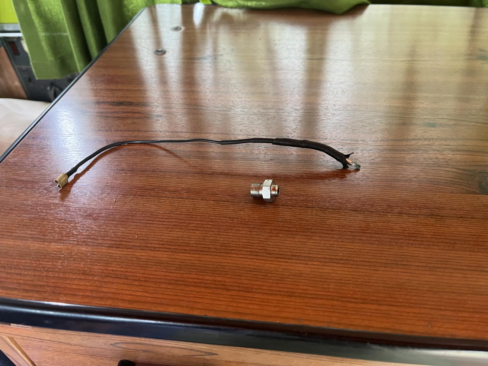

PostPosted: Tue Nov 11, 2025 8:13 am    Post subject: Re: What could cause a TS II to fail prematurely? Reply with quote
Not sure how many miles on this aftermarket TS2 had on it when it broke off, the PO installed. I had no idea a broken TS2 would instantly stop the engine. Fortunately I had a spare Bosch NOS in my stash. New TS2 Has about 8000 miles on it.
Keep on Busin'

PostPosted: Wed Nov 12, 2025 8:41 am    Post subject: Re: What could cause a TS II to fail prematurely? Reply with quote
Had this also happen to me last spring. Stopped me in my tracks. Unfortunately for me, it broke electrically but didn't separate ( the heat shrink held it in place), so while poking around for a reason, I missed it. Had I seen it broken, i could have just grounded the lead, and pressed on, albeit full rich. But at least I wouldn’t have had to get it towed home. First time in 30 years of ownership and operation that I've been fully broke down. Always been able to fix or limp off the road and fix later.
