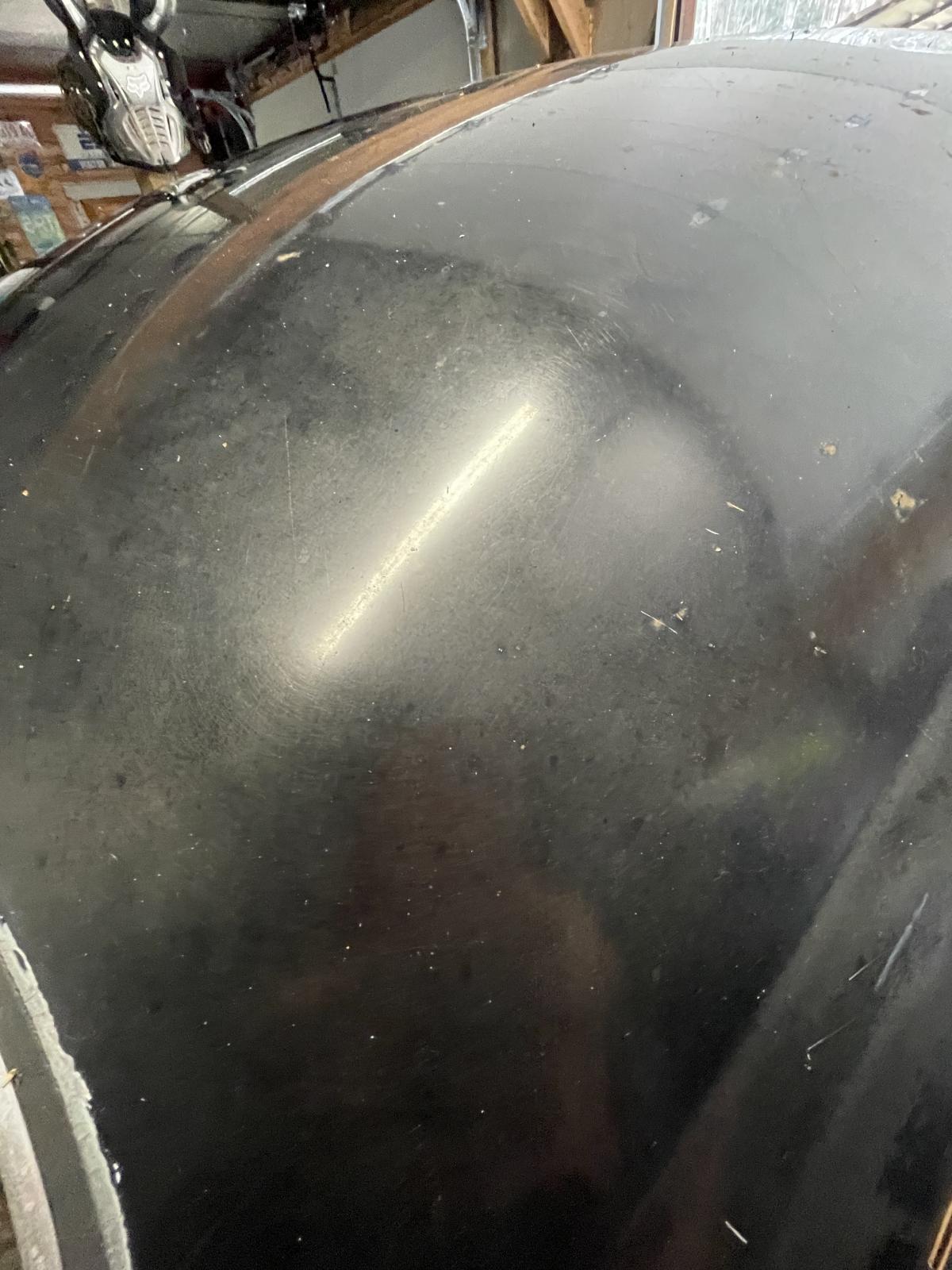

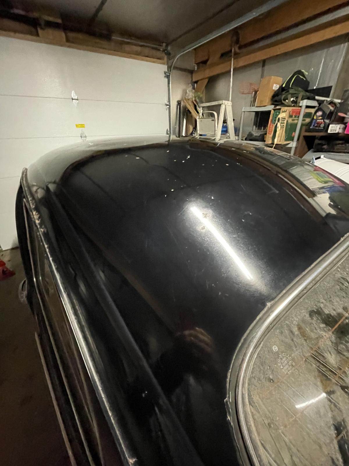

I just went out to the garage and did a quick and dirty red compound and just wax. I didn’t have any polishing compound so I did skip a step. Plus it was only 38 degrees in the garage. So did everything wrong but it will give you an idea.
Plus these pictures are low definition to download. It’s looks better in the pictures on my phone. I used turtle wax red compound. Be careful if you use a polisher go on low speed and pressure. It will burn through paint. The I used Chemical Guys butter wax. This looks better the more times you use it.
Before
After
Tried to show a straight line of only soapy wash and quick compound and wax.

That looks really nice. I'm going to do it all manual bc I know I'd go crazy with a power tool. The roof is pretty rough and much of the paint is gone but everything else has some pretty thick paint I'd say. It was looking really nice using 1500 wet sand but like you said that is taking off too much paint for no benefit....
