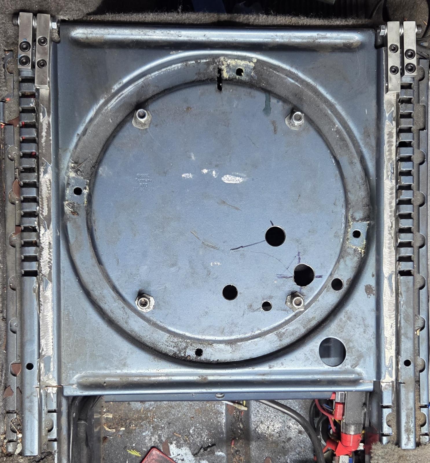

I'm looking for advice on installing a Vanistan Seat tilt kit in a 89 westy. I'm looking for advice from anyone who has done this modification and any photos you might have.
I'm scared about getting out the angle grinder and cutting things out as it is a one way street.
I want to do this modification to access the space under the to add charge controller ... and or LiFe battery electronics. I will put this on the left seat (I know I will need to slide the seat off to be able to tilt the swivel up).

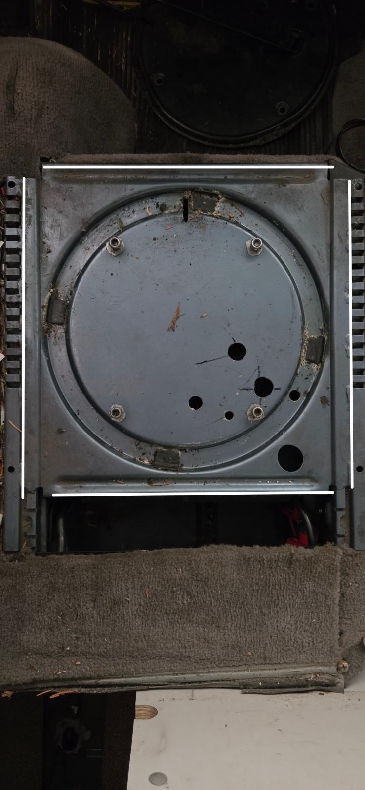

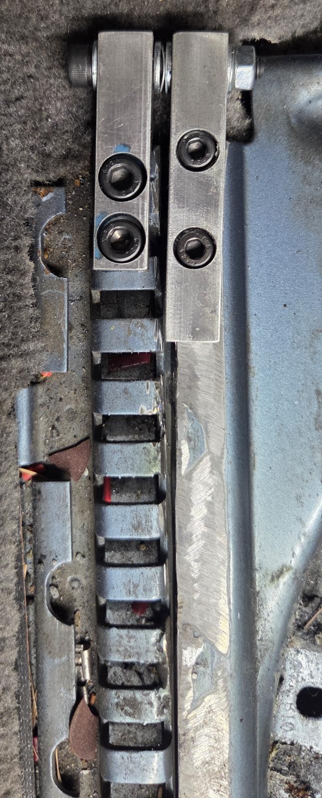

So From what I understand this is were I should cut the pedestal (white lines). does this look correct? The extra holes in the pedestal are to see and mount my BlueSeas battery isolator/switch.

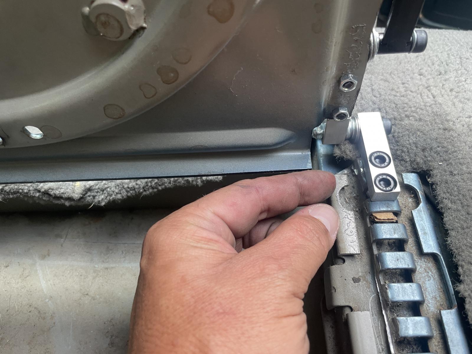

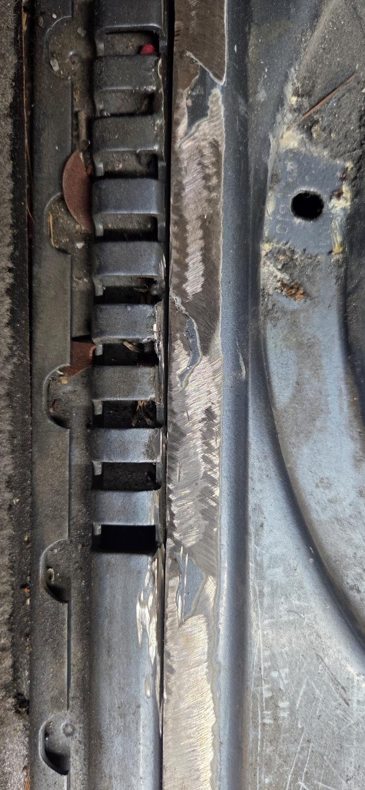

Rick,
Those lines are correct.
Here are tips.
You must grind as close to the track tabs as possible, even if you shave a little
off the inside of each tab, that is better than leaving too much extra on the van.
I used a grinder. I wish that I used a tool with a finer kerf. Not sure that term is the right one. But I wish I removed less material with the cut itself.
Ultimately, the base that you are removing must be cut to be as WIDE as possible. If it is cut too narrow, then when you mount the hinges, you will need to add spacers to the hinges that connect the mount to the base.
I did not know this, so I started to straighten my sides (removing even more material) then I said…maybe I should fit this first, then uninstall to clean up and paint. Good thing I did that.
You can see in the photos that I cut the base too narrow because I figured it was a rough cut. The directions were not clear as to why or where the cut should be.
If this helps you, I will be all stoked up.

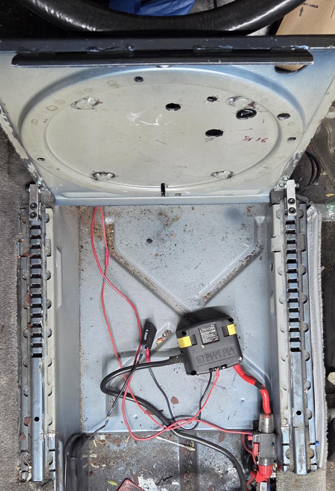

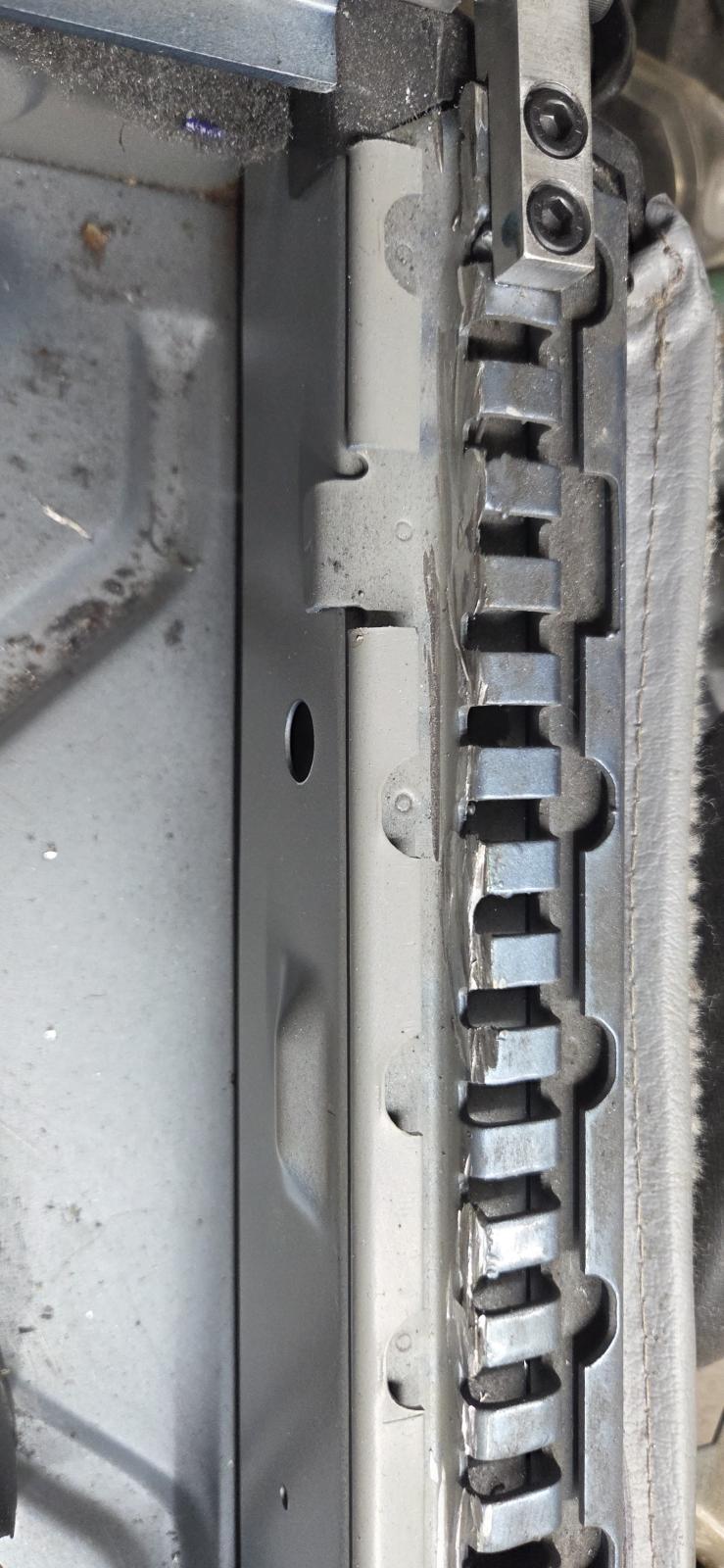

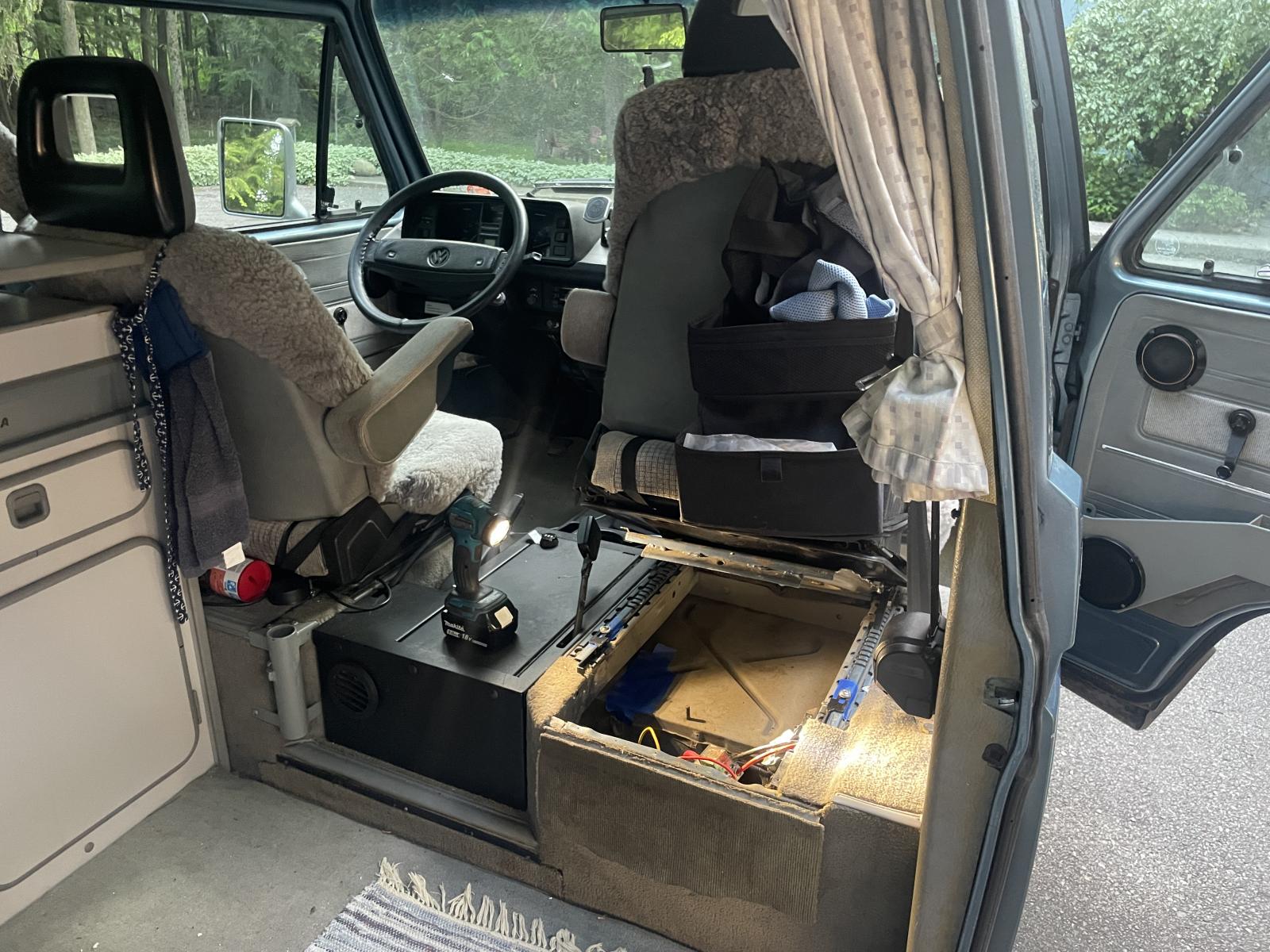

PostPosted: Mon Nov 17, 2025 2:12 pm    Post subject: Re: Vanistan Seat Tilt Kit install? Reply with quote
Thanks for all the advice, it's bee super helpful.
It was a success Smile
I taped off the carpet around the Pedestal
Made a cardboard box to fit as best I could
Used the thinnest cutoff wheel I could find
Went SLOW
It wasn't perfect, but good enough Smile The left hinge is not as straight as I would like it, but it seems to work fine.
Now I need to clean everything up, paint, final assembly, wringing upgrades (Blue Seas 120A breaker, and new cable), 12V relay for fridge setup.
Next, will be lengthening (deeper) the battery box.

Post some pictures when you get seat installed. Interested in how far it will tilt forward before hitting steering wheel. That will be a great use of space.

Rick,
Very nice job.
It your seat swiveling smoothly?
Mine has clearance issues. So I have to really force-tilt the seat to clear.
I feel like I have many hours to go on this install. All of which could have been avoided with improvements to the instructions and a slight modification to the product. Overall, it is clever and functional. Surely, anyone could do a very nice job on their third install. Haha.
MarkWard
Joined: February 09, 2005
Posts: 19093
MarkWard is offline
PostPosted: Wed Nov 19, 2025 10:09 am    Post subject: Re: Vanistan Seat Tilt Kit install? Reply with quote
Is it my eye? The parts don’t appear square to each other. Also, is this mod DOT approved? In an accident it is important the seat doesn’t detach. The restraint system depends on the seat being secure.
