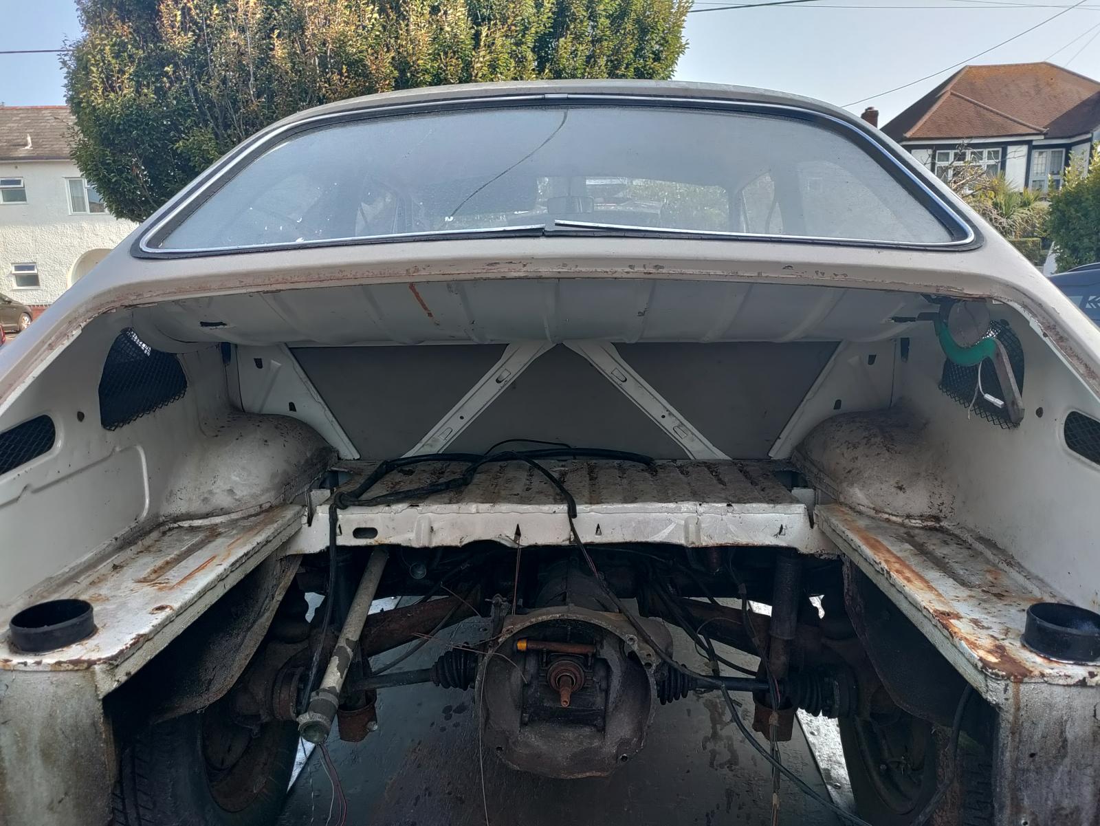

Hey there. My '68 Fastback has hinges for the rear lid but no springs. I'm getting conflicting information regarding the type of spring that's used. Can someone please clarify what I need and where I might find some?
The item identified on the parts image doesn't seem to be what I need (so I'm told). I'm a newb based in the UK

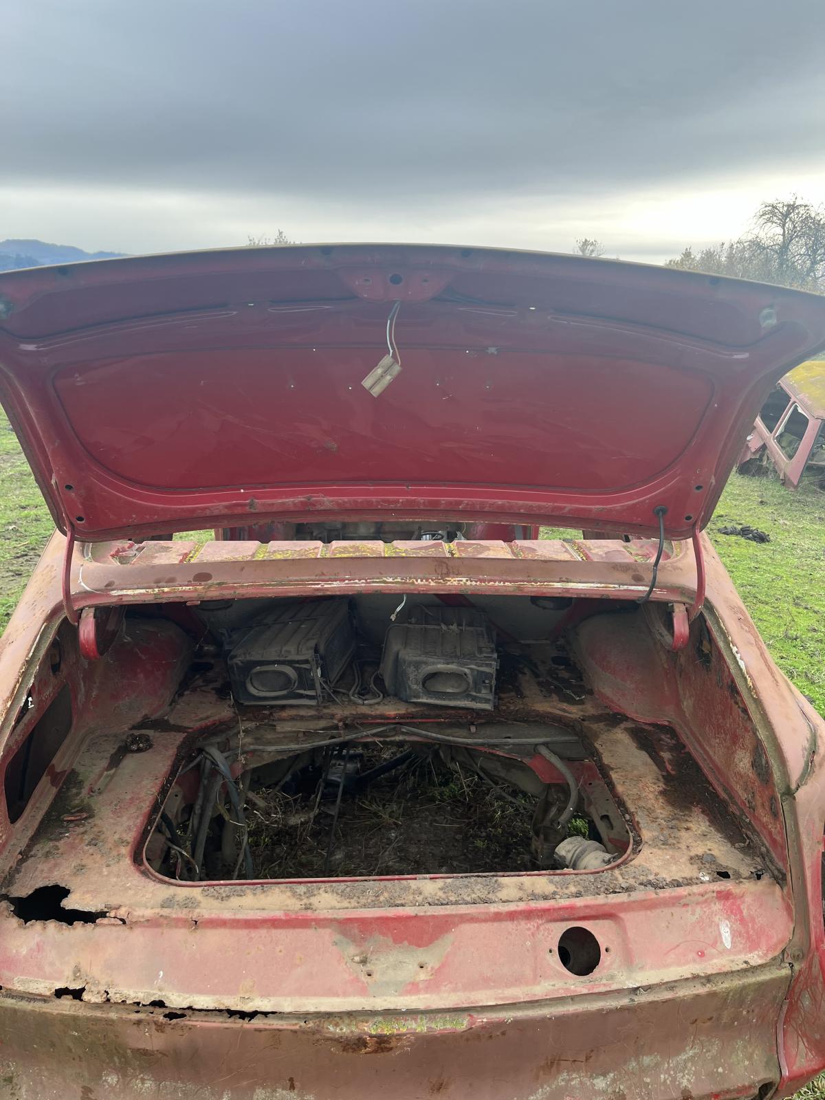

I have a complete 71 fasty rear section to cut up in Oregon.

Thanks but if you look at the third of Mike's photos below, it doesn't have torsion bars...

It's the two pieces in blue that I've been told I need, not the torsion bars... ??

It's these two pieces I think I need

I could also use the rear lid cable mech...
If I remember right, those in the blue circles are ramps for the hinges. The torsion bars are hidden above out of site.

Photo from the gallery. That piece acts as a stop for the hinge and guard for the torsion springs. Also holds the switch for the trunk light on the passenger side. Someone please correct me if any of that is inaccurate, my car is in storage and I'm not able to just go look right now. But, going off memory, I don't think anything rides that bracket. I hope this is helpful.
Thanks Bob
Jon
This site is invaluable for someone new to the. That photo makes everything much clearer in my head. Thanks very much Jon. Thumbs Up
