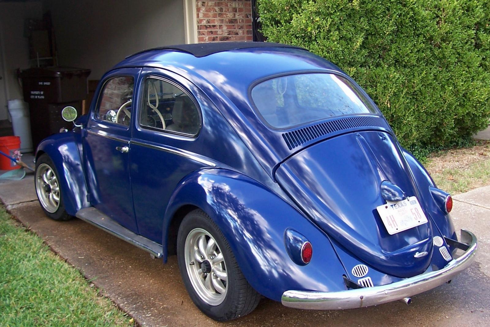

Is this a beetle?? I run 18lbs in a 145 on a lowered '59 beetle. Drives nice rides good. Any more the steering gets too light & it wanders around.

Yes, it's a 1959 Cal-look bug
