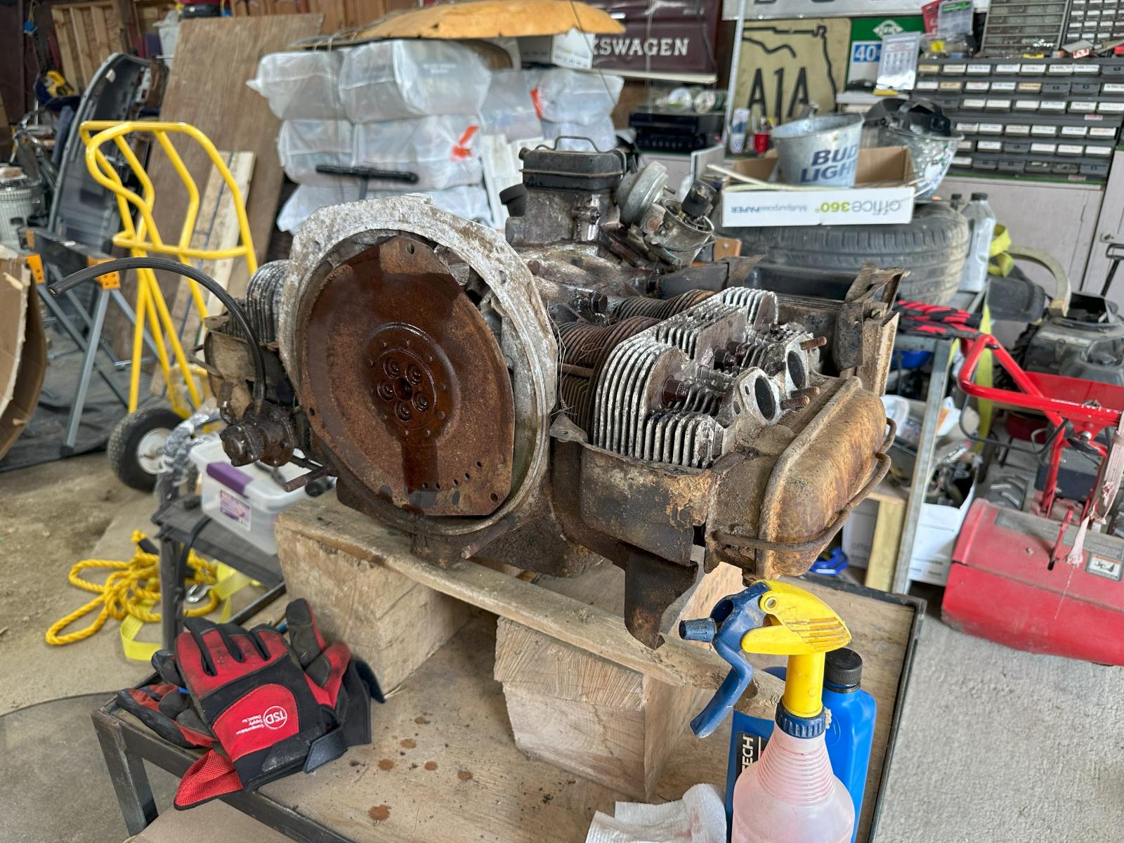

I can't find anything stamped on either case anywhere. There was a fan shroud assembly in the rotten bus with an AW code label which should be an 1800 fuel injected engine from a 75 Type 2 so that explains the sensor pigtail, I guess.
The engine in my bus is dual carb, no label on the shroud, no stamped code anywhere. I'm told it stopped running many years ago which is why it was parked. Still has oil in it. Need to get it pulled out and see what I've got to work with.
I also picked up some engines that were supposedly 1.7's but I discovered once there that they were actually CD code 2.0. Since I had already made the trip and they were reasonably priced, I brought them home as well. No intakes etc, just long blocks with valve covers. They do have the printed numbers still visible above the stamped numbers on the case. I'll post photos of those shortly.
So now I have quite a collection to work with. I found a link to a Type 4 decoder @ tunacan.net on the Ratwell site which has been helpful in figuring out the detail on what I've got.
Current lineup:
Whatever engine is currently in the bus. Dual carb, seems like it should be a 72-73 1.7 CB code if it's original based on the reference lists I've found.
CD code spare engine that came with the bus. Should be a 73 1.7 dual carb automatic. 371Q heads.
AW code case (based on shroud label), heads, and misc tin, shroud, fan, etc. from inside of rotted out bus. 73 - 75 1.8 automatic. 371S heads
GD code engine 1 - 76-77 2.0 solid lifter fuel injected. 372G heads, looks like these heads should have sodium filled exhaust valves and be set up for a CHT sensor. Still had oil in it, seems pretty solid.
GD code engine 2. 76-77 2.0 solid lifter fuel injected. (1) 372G 2.0 head and (1) 372H 1.8 head. This one is pretty rough.
I haven't disassembled or measured anything yet. Next step is figuring out what condition everything is in. I'm sure that there are optimum combinations of everything worth working with but that is down the road.

PostPosted: Mon Dec 01, 2025 12:43 pm    Post subject: Re: Type 4 engine research project Reply with quote
This is a 1700 head
888 wrote:
Wildthings
Joined: March 13, 2005
Posts: 52718
Wildthings is offline
PostPosted: Mon Dec 01, 2025 12:45 pm    Post subject: Re: Type 4 engine research project Reply with quote
This engine has 1800 heads and a breather box for a carbureted engine. The distributor is likely for a carbureted engine as well.
888 wrote:
Thanks for the information.
Both photos you responded to are from the same engine, before and after removing the heads. This is the CD code spare engine that came with the bus.
According to the lists I can find, CD means it *should* be a 73 1.7 dual carb automatic, they are 371Q heads.

Wildthings
Posts: 52718
PostPosted: Tue Dec 02, 2025 6:15 am    Post subject: Re: Type 4 engine research project Reply with quote
I was forgetting that the air injection was on a '73 as well as on a '74. So your heads would be from a '73 1700.
