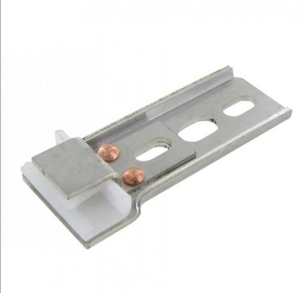

And, if you're searching for this front holder:
go to https://www.aircooledshop.com/category-6/Accesoire...anguage=en
or other shops. The part from the T2 bus is the same as in Superbug, Rabbit and Type 4.

This thread appears to be a perfect match for the 74 Super Beetle we recently purchased. It has the sunroof panel which is in good condition. but is missing a bunch of the bits and bobs to get it working. The parts that are screwed down all appear to be here but none of the moving bits. I have no crank or associated hardware but those appear to be easy to get. The cables are both broken but I can find some for sale. Are the cables the same for all years or do I need ones that are specifically for the 74?
I do not have the front or rear slides. I also have none of the stuff associated with the wind deflector.
Any ideas on where to find these parts. In the meantime, is there any way to secure the lid into the car so that I can at least use it in the meantime?

I no longer own my Sun Bug, but I believe the Super Beetle cables are unique to '73 - '75.
You definitely want to get the left and right cable from the same supplier. I had an awful time with mismatched cables.
For the slides and related parts, perhaps check the classifieds section. Best of luck!

For a temporary way to secure the lid, I was hoping to create something that would screw it into place rather than any type of adhesive.
I have a quality 3d printer that can print carbon fiber reinforced nylon parts. I am good and modeling parts in Fusion 3d, and I am thinking that I could print a pretty serviceable plastic alternative to the front and rear slides if I could get some basic dimensions. Anybody have one of each that they could photograph with some basic measurements?

I tried to install the new cables today in our 1974 and the DS cable went in fine, but the PS cable will not fit into the cable guides. The spacing of the two pins seems to be correct, but the center block hits solidly on the inboard side. It seems like the molding of that plastic piece is not in the correct location. Does anyone know if we just get the wrong part number?
I ended up printing a couple of front supports and the pins to locate the rear end of the slides with my 3d printer. They turned out pretty well and now we can drive with the sunroof closed. I will cut a couple of wedges that can be lightly jammed into the gap at the back of the sunroof to hold it up in place which should lock it in place until I get the cable thing figured out.
