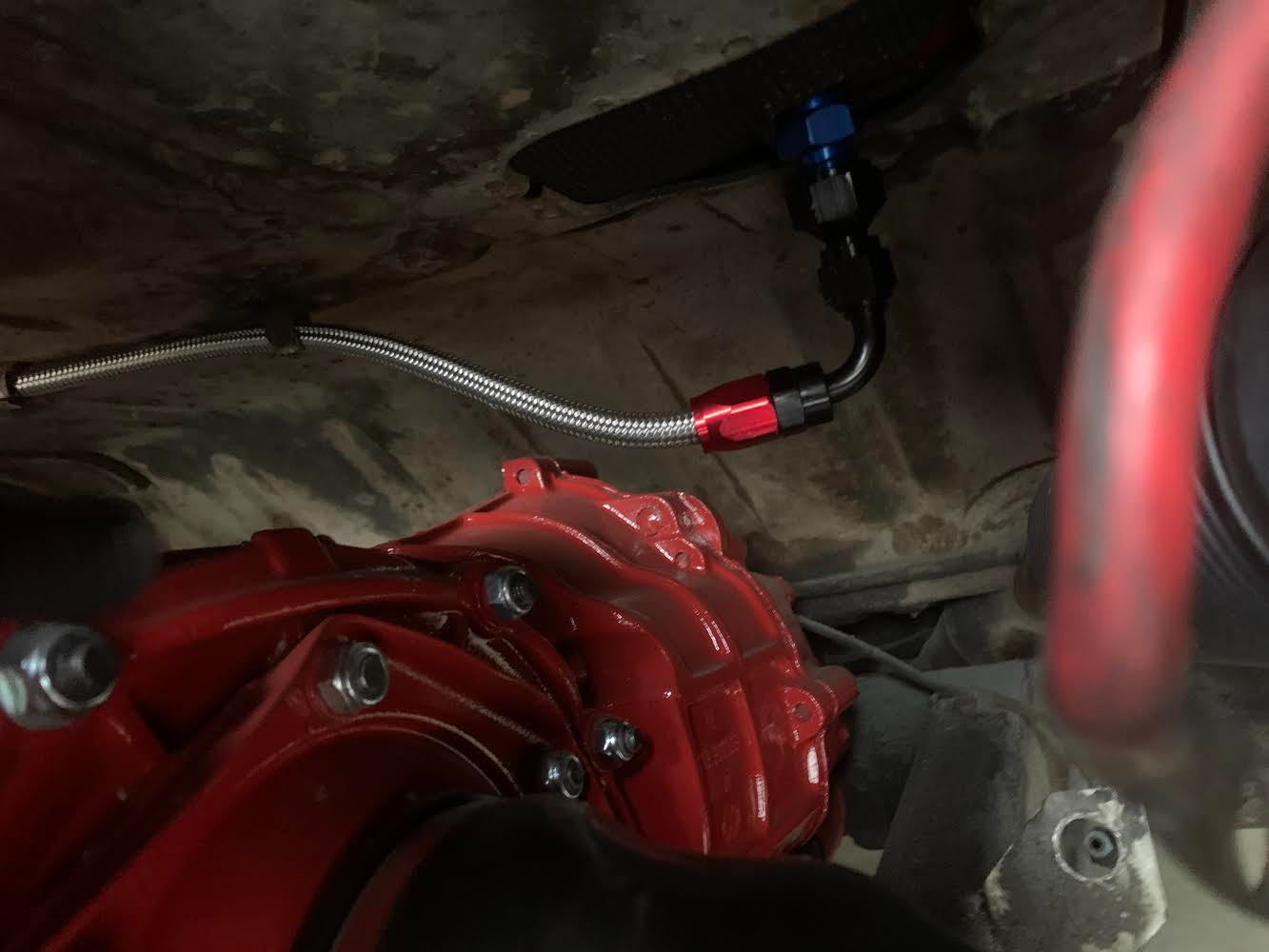

PostPosted: Fri Jan 31, 2020 10:34 am    Post subject: Re: 1966 type 2 fuel line attach to fuel tank question? Reply with quote
Use steel braid and you can get a adapter to go into the tank to a AN 6 size for a fuel line safe connection o more fuel lines leak
