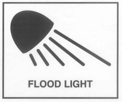

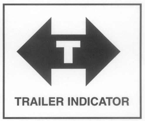

Home-made transparent mask orientations, for customising a Lucas, 60 mm diameter, 8-segment, warning-light cluster.
The types of material (some of which are compatible with photocopiers and computer laser printers) used for overhead projection transparencies, would be suitable for this purpose. Symbols could be printed onto the transparent sheet, either by hand printing with a fine-nibbed, permanent marker pen, photocopying a maper master copy, or laser printing directly from a computer-generated design.
Sometime ago, using Adobe Illustrator, on an Apple Macintosh computer, I produced the specimen, custom warning-function symbols, for the following:
Right-Hand Direction Indicators
Left-Hand Direction Indicators
Trailer Direction Indicators
Headlamp Main Beam
Headlamp Dipped Beam
Front Fog Lamps
Rear Fog Lamps
Auxiliary Reversing Lamps
Flood Light
Battery Charging
Oil Temperature
Coolant Temperature
