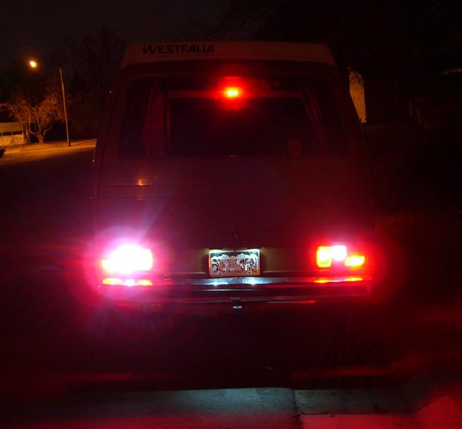

Not entirely true about the LEDs. It does depend on the type of LED you buy, and they can get very expensive depending on how far you're willing to go.
I started with a couple of the 3-watt LEDs from here: http://superbrightleds.com/tail-brake-turn.html and was satisfied for a while. But like TK points out, the reflectors are not being fully utilized and thus the light output, while much better than stock, was not what I was hoping for.
Then I discovered the 50w bulbs and bought six from our very own TK to use in the brake light and reverse light positions. Yes, a most definite improvement, but the damn bulbs kept burning out. This is not a slam against the bulb or TK, it's just they only lasted a couple months or so in the BRAKE LIGHT position. Of the six, only three remain and the original two in the reverse light position seem fine and are still in use.
Later, I noticed the above listed site had added the 5-watt Luxeon brake lights for $30.00 a piece (ouch!). Curiosity got the better of me and I bought them for the brake light position only. Due to their broader beam pattern, red color, and ultra high intensity, they are significantly brighter and far more noticeable than any other bulb I've had there... including the 50w bulbs.
I know the old saying about opinions, and I'm not into defending one over another. This is merely what I run to good effect, and I enjoy being MUCH more visible during both day and night.
Brake light - 5w luxeon
Running light - 3w luxeon
Reverse light - 50w bulb
LED third brake light from ebay

PostPosted: Tue Feb 05, 2008 10:46 pm    Post subject: LED's Don't Work? Reply with quote
Terry's bulbs were brighter than stock, a fair price for a good idea and his research and testing, but...
Have a look here:
http://www.thesamba.com/vw/forum/viewtopic.php?t=161963
Great results, great longevity. If you want to go LED, the way I went is working great.

PostPosted: Wed Feb 06, 2008 1:44 pm    Post subject: Yes. Reply with quote
They're pretty bright!
All right, it's been a long time since I did this, and I've not had to go back, but let's see...
They're all on this page:
http://www.superbrightleds.com/tail-brake-turn.html
I got the red 30 LED arrays in the tail lights, and the white 19's were in the reverse lights. I might have put the 24's in the brake lights. I can't remember which of those were 1156 or 1157, I pulled the bulbs and worked from those.
Note what I said about the front turn signal/running lights-- IMHO, you're stuck with incandescent there, even a modern electronic flasher couldn't cope with the drop in load when I replaced those with LED's. Believe Superbrite or whomever when they tell you to match the color of your LED's to the plastic over them. I used yellow LED arrays behind the yellow part of the lense covers.
The 30's are $9 each, plus shipping.

Go and visit your local BMW dealership, and head over to the parts department. Then ask for their heavy duty single filiment bulbs.
BMW has been installing them in their cars for years. Nice and bright.
