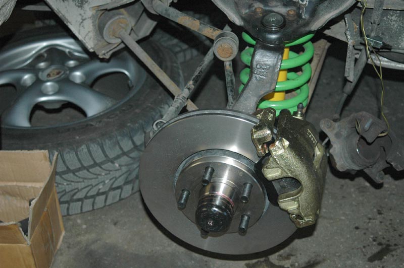

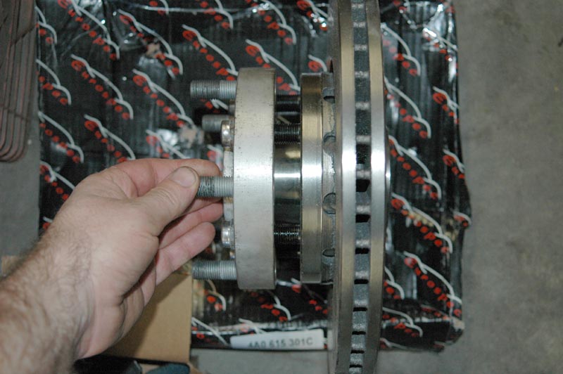

Rick, Here's my Van-Cafe (SA bigger brake kit) 2WD front brake rotor and caliper, might be different from the syncro? Rotor used is # 4A0 615 301C which I found to match up to 1996-2001 Audi A4, A6.
Me trying to fit the H&R Porsche wheel adaptor this over the new tapered hub - opps - needed machining! See rotor part number on box.
Careful, Van cafe uses eurospec carriers (custom cast) to make these fit without adaptors & the SA calipers probably arent a direct fit for those rotors.
I recently asked ken at vanagain about the syncro/2wd difference, this is his reply to my query:
"The difference between the old 2wd and syncro kit is that the rotors were machined to go over the stock syncro hub in the syncro version and the 2wd version had it's own new hub with studs that apparently wasn't the same as a syncro front hub even though they were similar (both have studs and are separate hubs instead of built into the rotors as in the stock 2wd brakes)."
Thats for stock SA rotors, i don't know about the audi rotors the VC kits uses.
